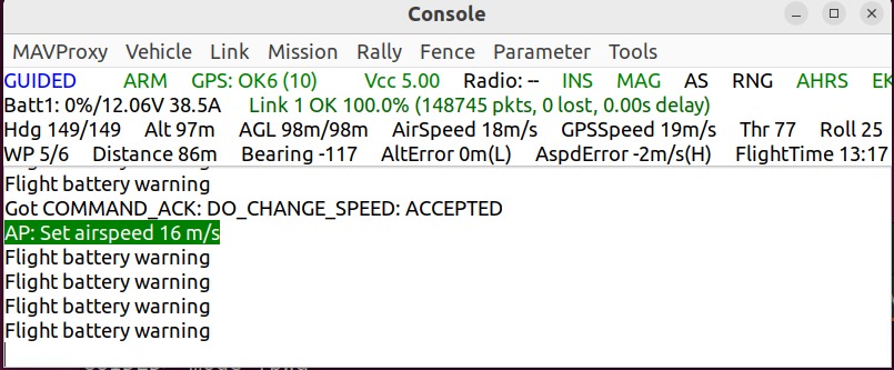

Hi, I am trying to change the speed on SITL. Although I receive COMMAD_ACK: ACCEPTED, I do not see the speed change. I tried on GUIDED mode. When it did not work with pymavlink, I tried to change the speed via APM Planner, but despite the approval, there was still no change. How do I solve this problem?

ArduPlane Console Output:
Without airspeed source enabled and used (preferably airspeed sensor) speed control only works in throttle mode.
How do I set this up? Can you help me?
IIRC for basic SITL it is enough to set airspeed type to any sensor and tell Ardupilot to use airspeed.
Do I need to add a sensor to the model sdf file? How do I tell Ardupilot to use the sensor?
