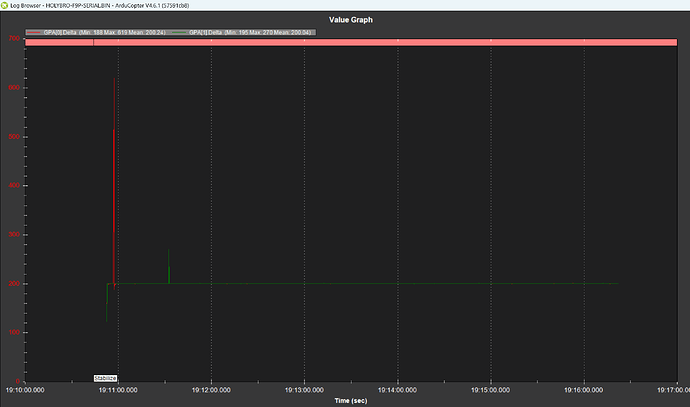

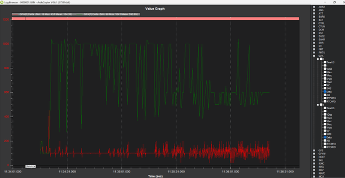

Hello Ardupilot team,
I am currently using two u-blox F9P serial GPS modules for a moving baseline setup. I have configured the GPS_DELAY_MS to 200 ms by default for both units.
However, upon reviewing the log, I noticed a discrepancy in the GPS-DELTA values—one unit consistently shows 200 ms, while the other shows 1000 ms.
Is this expected behavior in a moving baseline configuration?
I’ve attached a snapshot and log files for your reference. Your assistance in identifying the cause of this issue would be greatly appreciated.

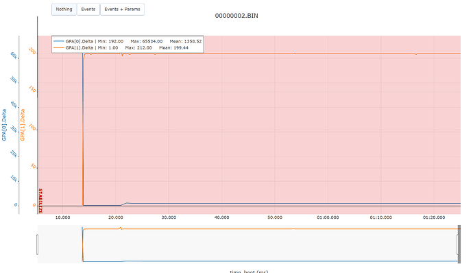

I resolved the delta issue with the Serial Variant GPS by setting GPS1_RATE_MS to 200 (5 Hz).
For testing with two DroneCAN GPS modules (also set to 5 Hz) in a moving baseline configuration, the base GPS maintains a steady delta of 200 ms. However, the rover side shows irregular spikes, averaging around 400 ms, similar to the snapshot I shared earlier for the Serial variant.
Both DroneCAN GPS units work normally when not used in moving baseline mode, each holding an average delta of 200 ms. The irregular spikes appear only on one GPS when it’s configured for moving baseline support.

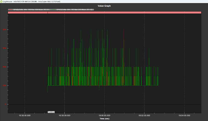

I’ve been testing a few scenarios using the Holybro F9P Rover Lite (serial variant) GPS for a moving baseline setup with ArduPilot.
When both GPS units are connected via serial, everything works fine — the delta values for both GPS1 and GPS2 remain stable at around 200ms.
However, when I connect the same GPS units through two separate MatekL431 CAN nodes (one GPS per node), I start noticing discrepancies. GPS1 shows a slightly lower delta (~204ms), while GPS2 averages around 250ms, with occasional peaks reaching up to 800ms.
Could you help me understand why this behavior is occurring when the GPS units are connected via CAN nodes?
I’ve attached the logs and some snapshots for your reference.
Best guess is that you’re saturating the CAN bus by talking to two nodes and forwarding a lot of data. As far as I know, you should be able to connect both modules to the same node.

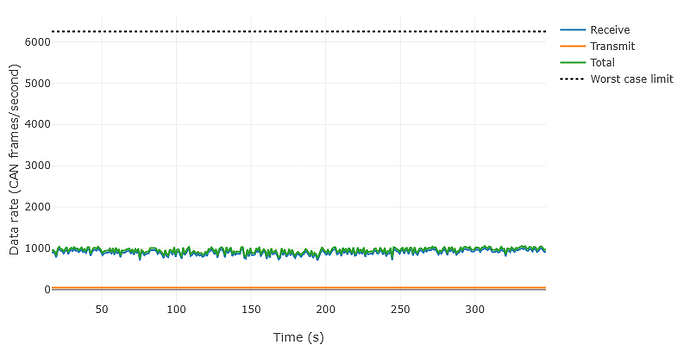

From the hardware report it seems like there is enough bandwidth for his application, but I wonder if there’s a way to get CAN interface statistics like frame errors that would rule out can bus errors being a source of missed messages.
I agree that one node should be able to handle both modules.
