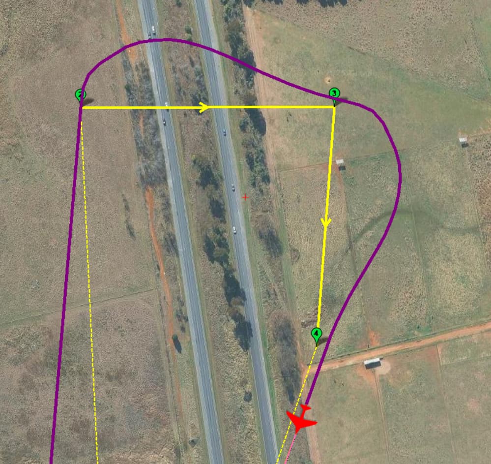

Here is a quick screenshot of what is happening. Made it in a SITL with basic airplane model and 3 waypoint mission. Decreased WP_RADIUS because I need to pass straight through the waypoints. As you see, while the plane has enough turn radius to get to waypoint, it follows the crosstrack and misses by 10-15 meters.
I would recommend resetting the WP_RADIUS to what is suitable for the plane and adding lead in and lead out waypoints to where you need tight lateral tolerance. WP_RADIUS doesn’t control how close the plane will try to fly through the gate. Then play with NAVL1_* parameters so the plane more precisely follows the path. In SITL I had to increase NAVL1_DAMPING outside recommended values to get precise trajectory following.

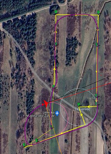

If you have corners you can use LOITER_TURNS to achieve smooth turns with by using entry waypoint and tangent exit.
Example of lead in and lead out waypoints as well as Loiter turn.
