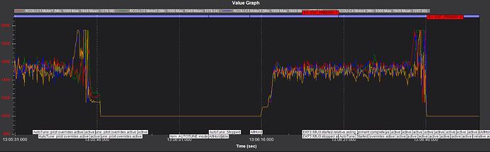

Hello. I need some help here. I used to fly larger drones with no problem, but I recently got into a 3 inch prop size quad with Ardupilot. I just can’t get it into the autotune process, and I think it’s because it’s an unstable frame with a big battery on top. I read the documentation for the first flight and tuning, and I think I didn’t miss any steps. I also tried to set up this guy twice from the beginning, but without success. I’m stuck.
I’m just someone who loves this drone thing and learning.
Can anybody please take a look at the log of one of the last flights and tell me what to do? I’ll be very thankful.

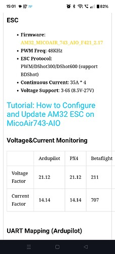

What ESC’s and what firmware are they using? Got a log that’s not running Auto Tune?
Use Dshot600, configure the Vertical Acceleration controller gains and the Notch Filter.
You are getting thrust loss from something. ESC settings correct for the Motor kV?
Looks to be am32 firmware 2.17.
