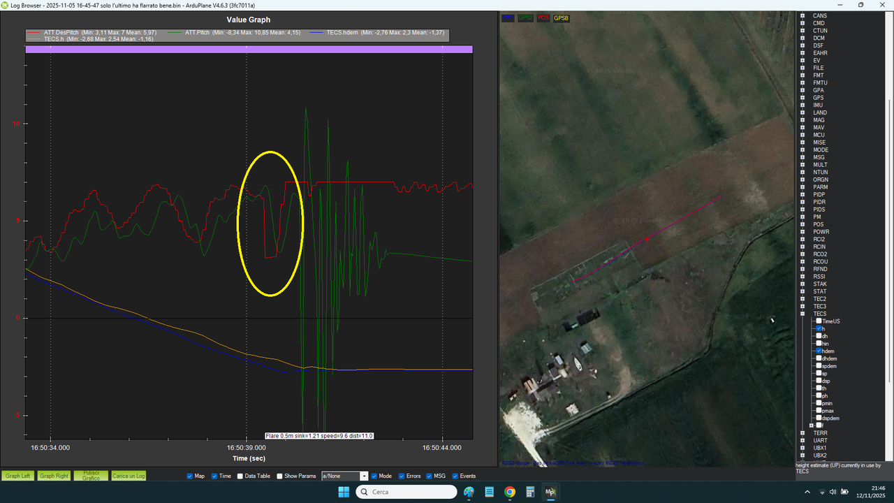

Let’s comment on the logs:
1
1 - rangefinder intervenes perfectly, the pitch suddenly is commanded by almost the max, is not smooth to see in reality, I apologize but for now I have no video

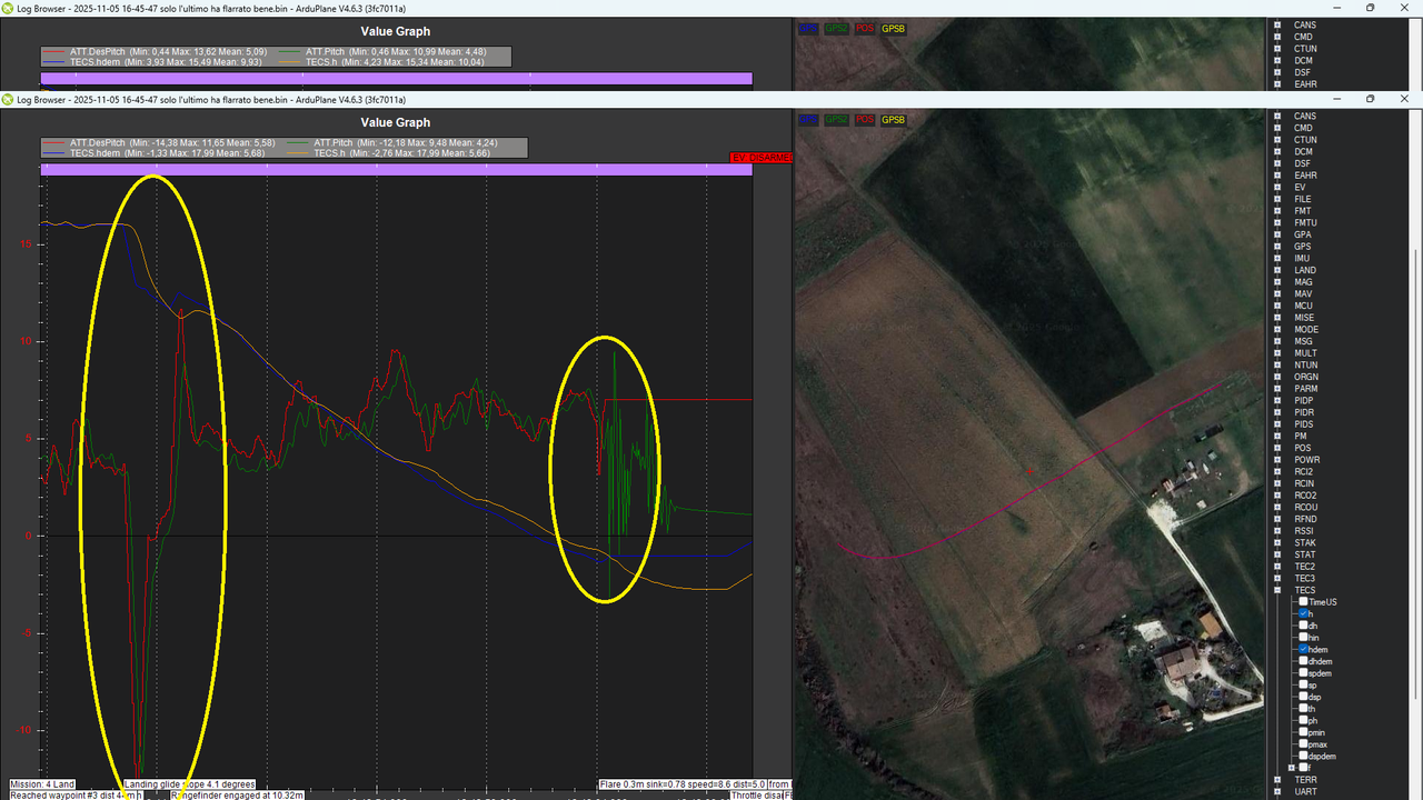

2
2 - excuse me, now after posted, I see that the image has a white border down, due to bad for me paste in paint that I deemed to avoid correcting; switching in auto mode the hight controller commands rightly a change in altitude, but the pitch drops abruptly commanding about -6 degrees, not very delicate if it there were passengers, apart from that, this involves a fair loss of altitude much greater than what a gentle profile would require, in fact it is seen afterwards that it has to recover upwards this too sudden correction

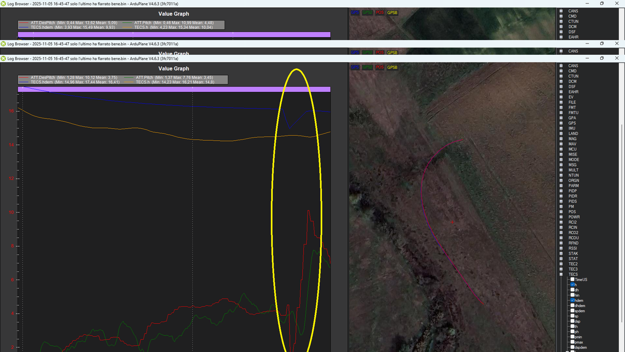

3
3 - excuse image sovrapposizition, as I tell I’m not the best in screenshot and links; after some waypoints, the well scripted algorithm of landing, calculate the slope and he rightly realizes that the altitude is excessive and immediately orders a pitch down of about -15 degrees, and probably because of the previous overshoot request, the well working rangefinder asks for a pitch of 12 degrees; if the pitch requests had been a little gentler the result would have been less variable. Then the flare commands down resulting a brutal strike to terrain
