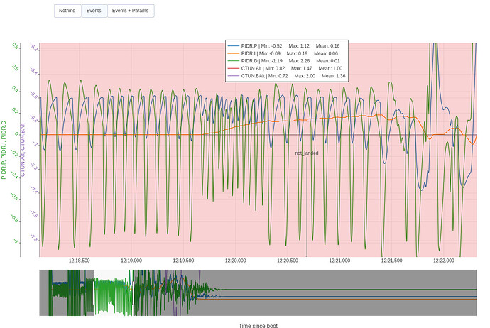

Fellow Enthusiast still learning here. Some ideas:
Your GPS1(blue) and GPS2(green) differ. Seems there is a scale difference between the two. Maybe worth investigating. Set GPS_AUTO_SWITCH to default value 1
Not all Prearm checks where enabled. Why? Maybe something was overlooked before arm?
Was the Copter moved during Initialization? (LOG_DISARMED is disabled so we can’t check)
That could result in wrong EKF Init and flipping.
The compass also shows errors maybe magnetic interference?
COMPASS_AUTO_ROT is disabled
Hope it helps!
Set:
ARMING_CHECK,1
ATC_RAT_PIT_I,0.129
ATC_RAT_RLL_I,0.1359
INS_HNTCH_FM_RAT,0.7
INS_HNTCH_HMNC,1
Arming checks should not be disabled unless there’s some known fault that’s safe to ignore (before you get a chance to fix it) otherwise work through any arming checks and resolve the issues.
The Rate I values should usually be the same as the P values, Arducopter is not the same as Betaflight.
Minimise any harmonic notch filter interference until there’s a good clean flight.
Also perform the mandatory Accel calibration if possible, or at least do the “Calibrate Level” option - just to be sure the hardware is OK.
EDIT: to be clear, I believe the crazy high I term values are the cause of the issue

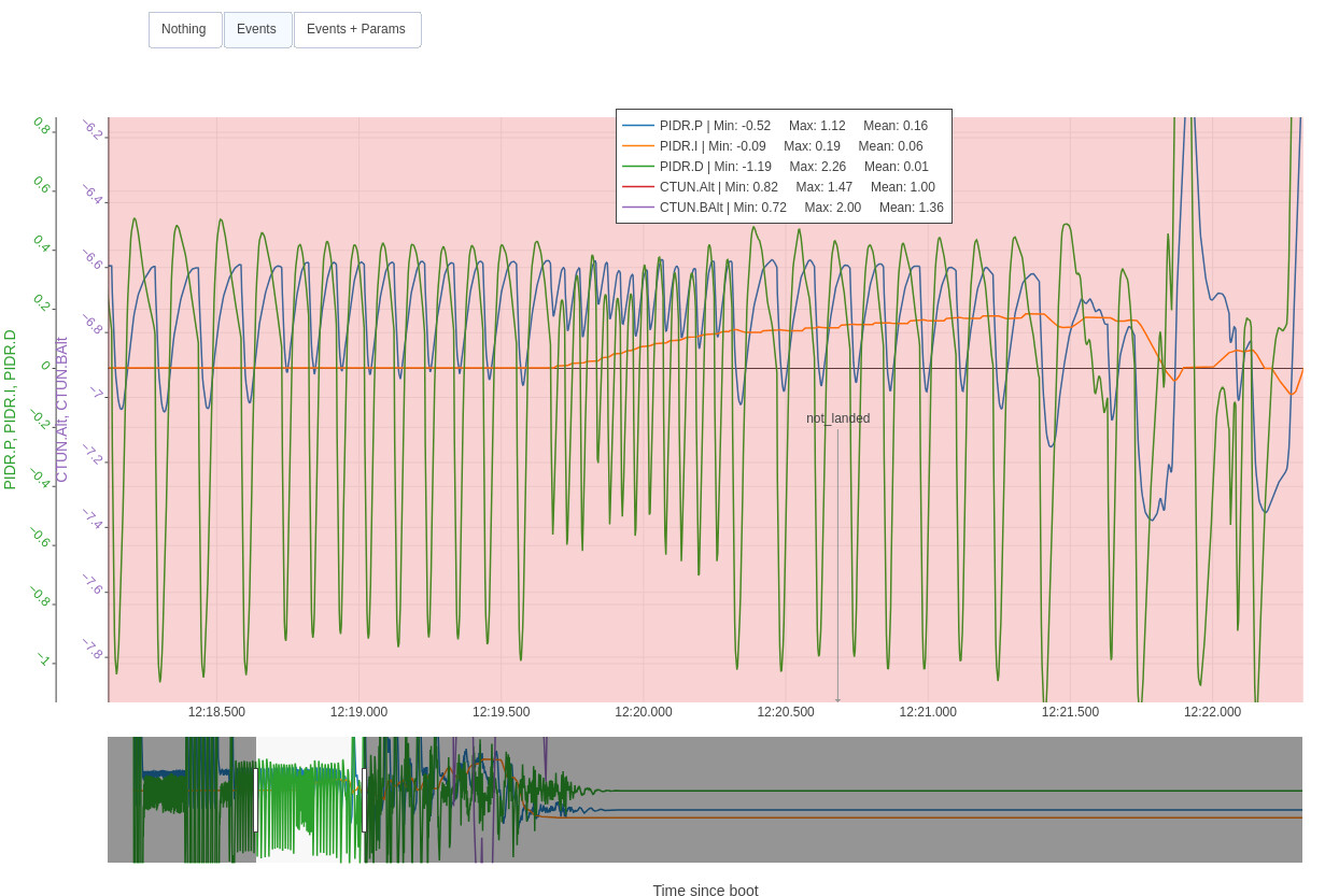

Need to lower the D terms too - I missed them the first time around. I saw the over-active D term in @Joshua_Kordani 's graph.
ATC_RAT_PIT_D,0.0065
ATC_RAT_RLL_D,0.0068
I’d like to see the log of the working flight because I have no idea how it got off the ground the first time.

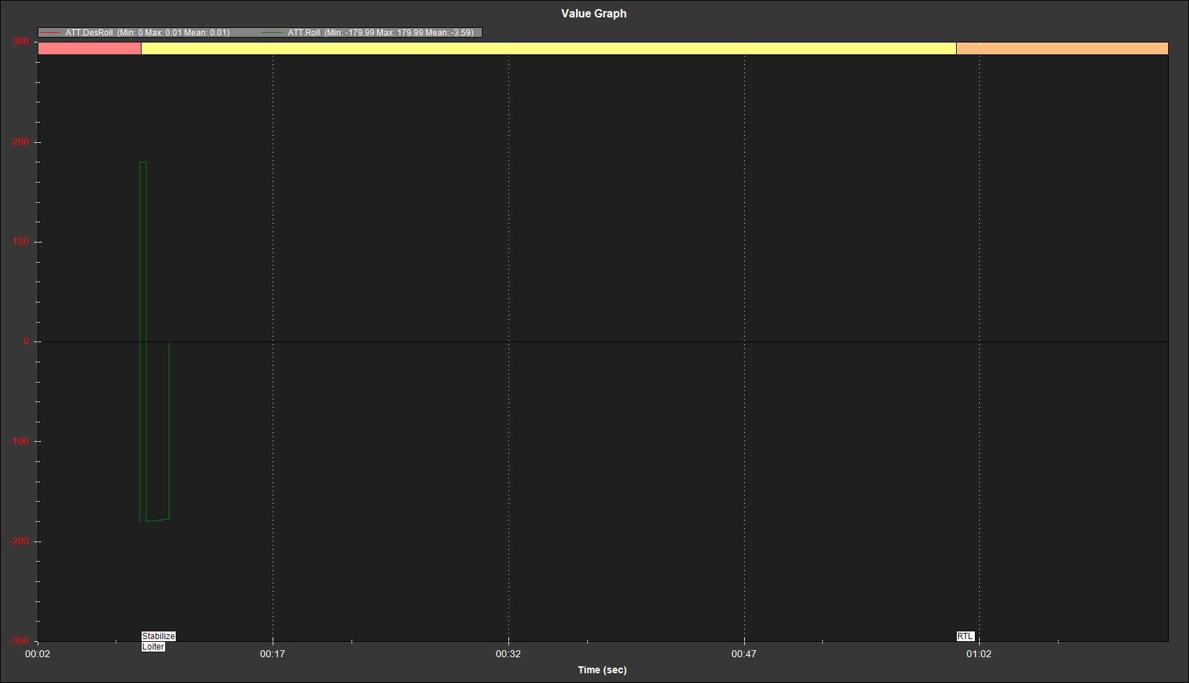

Today I’m having this issue again. but on Copter 4.5.7
I think we need more info here. What FC, what frame size, what weight, what motors/escs, and a log covering behavior you’d like help with
Hi guys, now I know exactly what happens.
When I reboot the Cube in RTL mode, DesRoll and DesPitch crazy.
But when I reboot the Cube in Loiter mode, DesRoll and DesPitch are normal.
As I remember, the drone flipped on the ground after I changed parameters and rebooted the Cube while it was in RTL mode.
I will happen when i Reboot only
i think something wrong in Navigation Control
This Log File:
