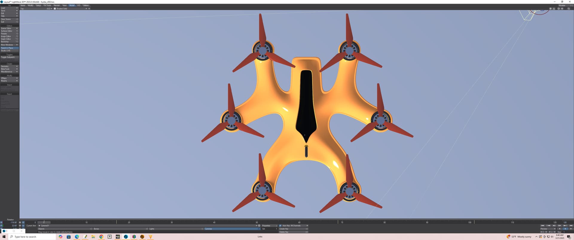

I’ve ben designing multirotor of different categories for around 2 years, over this I’ve been developing generic frame such as quads, hexa and making them as light as possible using various composites and additive manufacturing techniques. Lately I’ve had some questions going on in my mind “what if we do this was, will it work or not”. Here are those questions:
  1. Is it always necessary to have my rotors on the wheelbase of the multirotor, if not what are the considerations to be taken while design?
  2. what are the best practices while designing a multirotor frame that you follow?
  3. consider a quad, will it be ok if my forward motors are inverted and rear motors are normal/vice versa, is it must to have propellers in same plane, if not what are the considerations to be observed while designing?
  4. what are the considerations while designing composite monocoque multirotor frames.

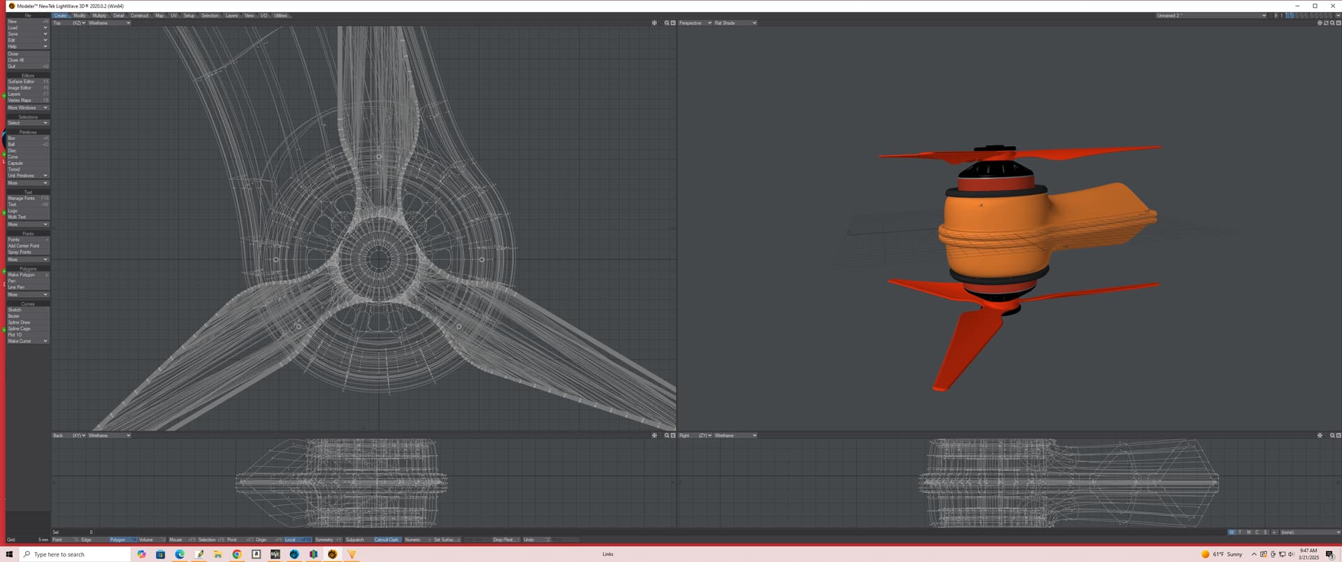

A Quick question apart from the topic above, what is the minimum distance that is to be maintained between propellers while building a coaxial system.
I don’t think you will get a definitive answer to that either.
For me the first thought is Prop size. Once that is chosen I layout the props in the top view in Cad.
the prop spacing is about 16 mm tip to tip. However it’s a good idea to design for two sizes of props.
“maintained between propellers while building a coaxial system.” I came up with a neat system that I can stack motors basicly layout your motors with a space between for hardware.

Even for me, the primary focus is ensuring there’s enough space between the prop tips, and from there, I design to meet the specific requirements. Thanks for the valuable insights, mate!
