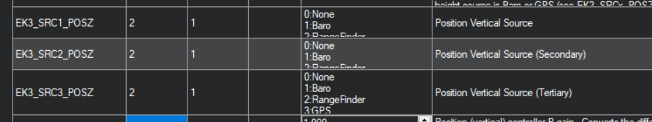

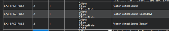

I send Mavlink DISTANCE_SENSOR message.
sensorId == 1
RNGFND1_TYPE == 10 (Mavlink)
EK3_SRC1_POSZ == RangeFinder
EK3_SRC2_POSZ == RangeFinder
EK3_SRC3_POSZ == RangeFinder
But it ignores and uses Baro.
The way I send DISTANCE_SENSOR I also send GPS_INPUT and it works.
Thanks

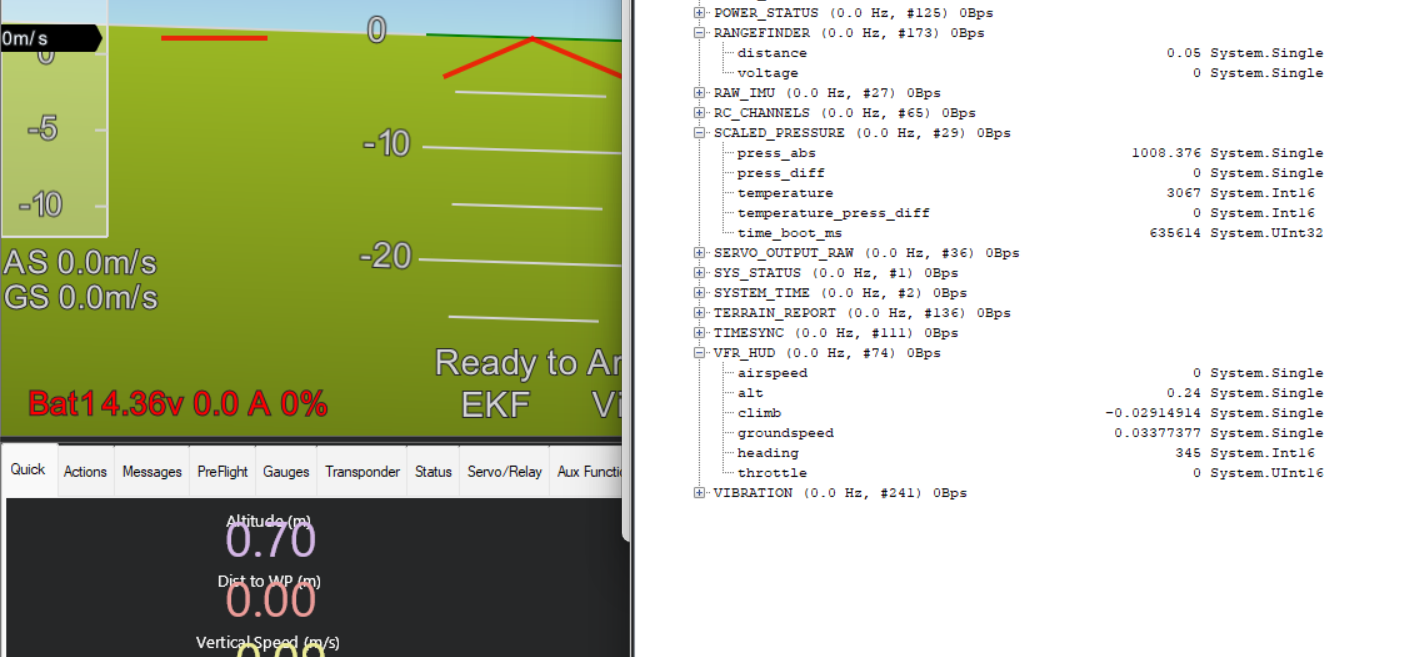

can you show what the its sending on mavlink inspector?

Good point for Mavlink Inspector ! It shows data I send
Thank You. May be I should try to fly it,
I expect range finder data to appear in VFR_HUD.
Rangefinder should only be used as EKF source in specific circumstances and if you understand the limitations of such configuration.
I have quite limited understanding.
In other words If I set Range Finder like that and enable AltHold. Will it use range finder?
yes if you leave the EK3 settings alone with baro for altitude, it will use the rangefinder for alt hold if its in orientation 25.
If you set EK3_SRCx_POSZ to 2 any unevenness in terrain will upset the EKF.
