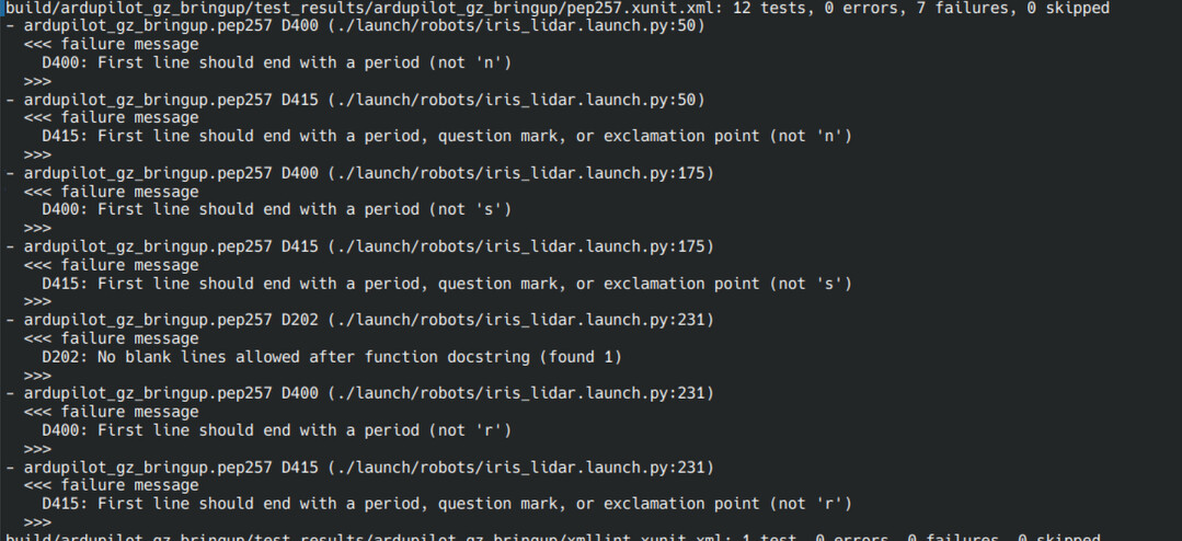

Nonetheless some tests DO FAIL but em.. not sure ardupilot is to blame there

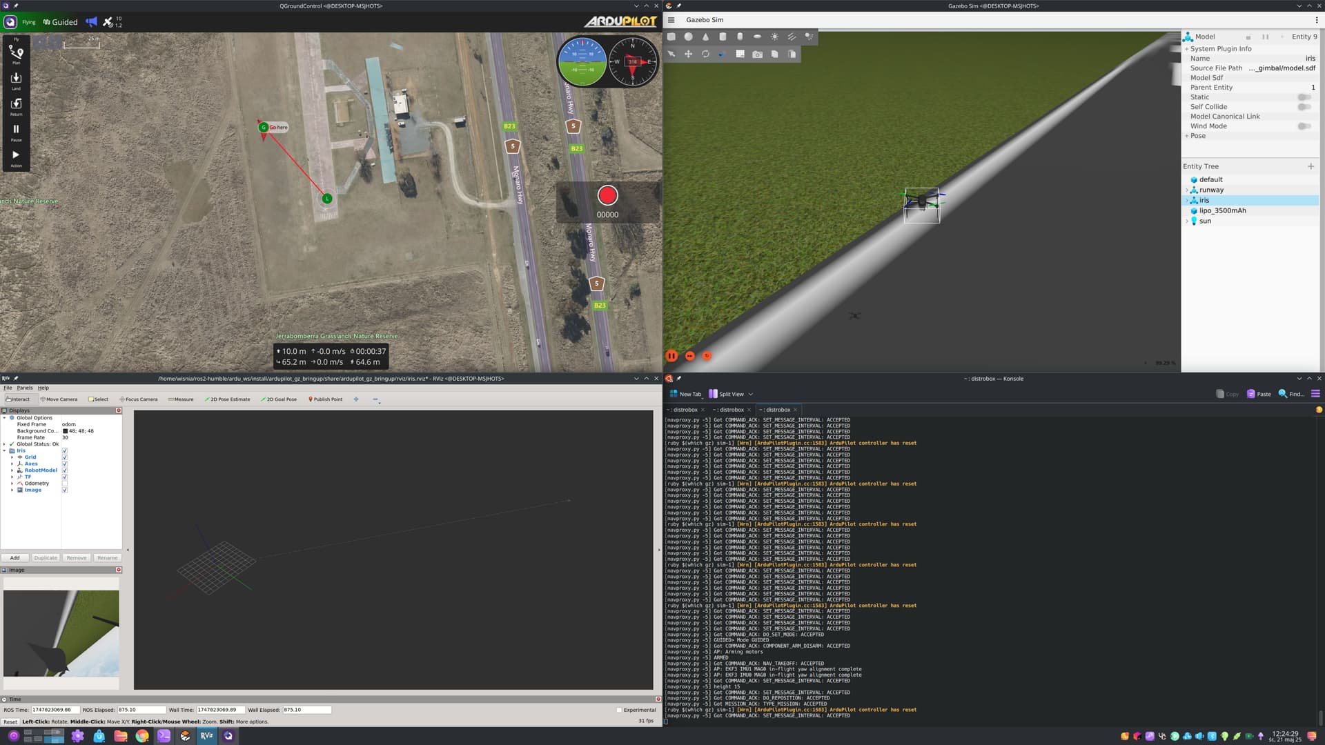

anyway the simulation does seem to work:
