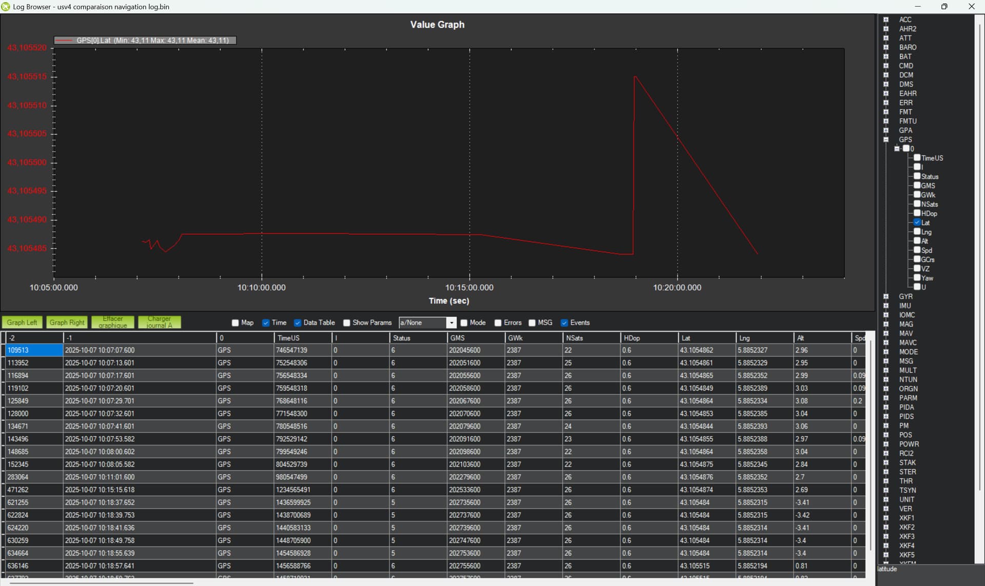

I am working on a boat with a single GNSS receiver with dual antenna input. I’m kind of new using ardupilot and wondering what exactly are the GPS messages in the DataFlash logs ?
Indeed, I first thought that it is raw GNSS from my receiver, but I see only a small amount of data being displayed with big gaps between them.
Is it a problem from my pixhawk parameters or receiver ? Or am I misleading about the meaning of this message ?

Here is the log of my data in question:

Something weird is that in mavlink inspector I can see that I have a new GPS_RAW_INT data every 0.5s. So the fact that it’s not logged in the DataFlash make me think that it come from the logging parameters…
Another thing is that I allowed the RAW_IMU logging from LOG_BITMASK and I now have ACC and GYR messages with high frequency measurements in the DataFlash logs. But for the magnetic measurements I only have MAG message which is also really low frequency and irregular (which is not the case in RAW_IMU from mavlink inspector)…

In the DataFlash logs I thought the gps yaw from $GNHDT NMEA message would be logged under “GPS”, but as you can see I only have a small amount of data. How should I reduce the amount of log messages then ?

I tried to set all logs to default but it doesn’t change the behavior. Indeed on a ~10mn log I only have one data under the GPS message in the DataFlash…Am I missing something ?
Share the log, please.
