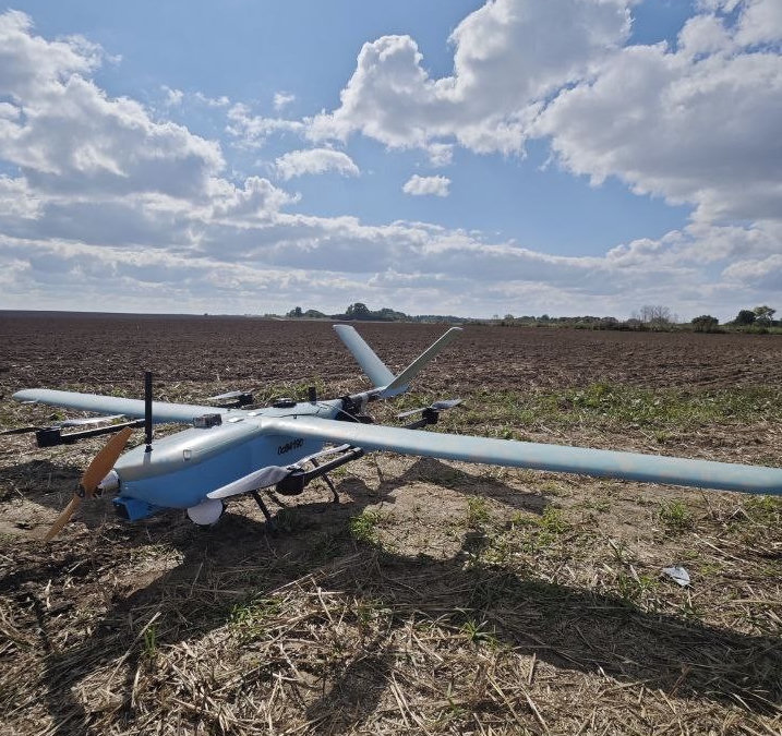

Hi everyone,
I’ve been working on GPS-denied flight for a VTOL QuadPlane (~15 kg, CUAV V5+) and wanted to share a custom EKF3 modification that solved the problem for us. The code is open, links at the bottom.
The problem
Stock EKF3 can’t initialize position without GPS. If there’s no GPS from boot, origin never gets set, the filter stays in AID_NONE, and you get:
  • No position reporting through AHRS
  • No wind state estimation (inhibitWindStates = true)
  • Zero-velocity fusion fighting actual flight velocity
  • No auto/guided modes
We tried feeding coordinates through MAVLink GPS input first, but that brought its own set of problems: EKF warmup conflicts, core disagreements, inability to initialize cleanly without a real GPS fix at boot. So we went deeper and modified EKF3 directly.
What we added
Two new functions in the EKF3 core, called through custom MAVLink COMMAND_INT commands:

This caught me off guard during testing. On the first forcePositionReset(), velocity is still zero from initialization, so we open velocity covariance wide (25 m/s) to let TAS fusion build it up from scratch. On repeat calls in flight, velocity is already correct from dead reckoning, and resetting covariance would destabilize the filter for several minutes until TAS fusion recovers.
Flight test results
Tested on a ~15 kg VTOL QuadPlane, CUAV V5+, custom ArduPlane 4.4.3.
  • Wind: 7-11 m/s
  • Altitudes: 100-1500 m
  • Distances: 1-23 km
  • Position correction: manual by operator using camera payload
Dead reckoning drift between corrections: 50-150 m over 5-7 km. Drift depends mainly on wind stability. Steady wind gives much better results than gusty conditions, which makes sense since airspeed + compass dead reckoning assumes relatively stable wind.
Auto missions work after forcePositionReset(). Guided and auto modes become available, waypoint navigation functions. Operator periodically corrects position, aircraft continues the mission.

Total modification is roughly 120 lines in the EKF3 core plus the MAVLink handler. The firmware is based on ArduPlane 4.4.3.
Has anyone else tackled GPS-denied flight on fixed-wing ArduPilot? Curious how others have approached it.
