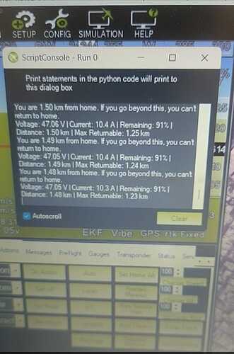

I’m working on a drone safety feature that monitors real-time battery voltage and calculates whether the drone can safely return to its home location. I’m using Mission Planner and a Skydroid T12 transmitter. The system estimates the returnable distance based on live battery data and GPS position, and it gives a warning if the drone flies too far to make it back safely. I’m currently testing it in simulation,i got on the simulation. will move to real-flight tests soon to ensure accurate behavior under nonlinear battery discharge conditions. Just i need i warning message in the skydroid t12 transmitter “warning:return to home not possible”. lets say my drone travells 7km from 50.2v to 42.7v. at the3.5km it should trigger a warning in rc.

ok jai i will go through the transmitter buitin messages. the above functions which you have sent i will add for the voltage,current and battery remaining%. what is the function for the distance to home. and i have simulated using the python script. i have attached
the output image.
instead of beyond this,you cant return home i will make it as “warning:return home is not possible”
