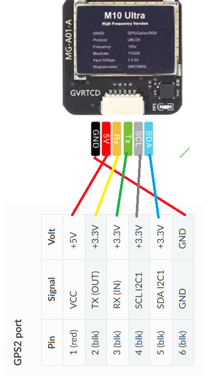

I am trying to connect a MicoAir M10G-5883 GPS unit to my CubeOrange Flight controller, however I get no connetion to neither the GPS nor the integrated Compass unit. I triple checked the connection (RX→Tx & Tx→ RX as well as SDA and SCA connected). The GPS powers on with a blue light, so it should have correct power. I plugged it into GPS2 port and configured Serial 4 for a GPS Receiver with auto discovery on (I also configured the other Ports to be GPS ports, just to be safe, but no luck). But neither GPS (GPS: No GPS) nor the magnetometer (does not turn up in list of magnetometers in configuration screen) appears.

@Juergen-Fahlbusch Concerning the connection, I connected it like follows:

I was able to establish a connection after enabling the TXRX Swap flag of the serial port. What is strange, is that I checked the connection between the Autopilot and the GPS again, and I wired it correctly as per instructions (See image somewhere above). I think that the documentation of the MicoAir M10G-5883 is wrong.

  2. The documentation of the MicoAir M10G-5883 seems to be wrong, as the RX and TX ports are swapped. To solve this, in the serial port options (SERIALX_OPTIONS), the swap TXRX option bit can be activated.
