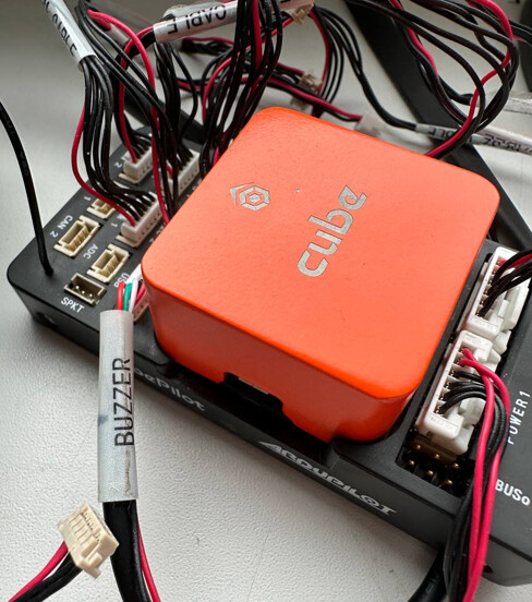

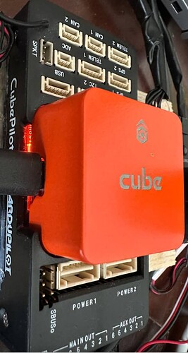

That doesn’t make much sense they are both flight controllers. Provide more detail of the hardware.
This one.
Once again when connected through the USB controller just make one long unstopped beep signal.

That looks like a Cube Orange, not a Cube Orange Plus.

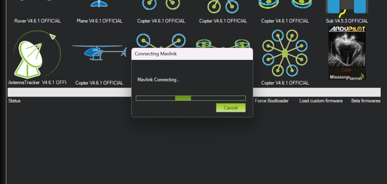

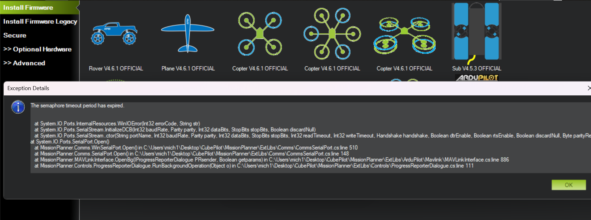

If your computers register that a USB device is recognized, try using mission planner to “force bootloader”. If this is successful, you should see some printouts in that same screen about STDEV or something. Try loading a firmware for a whole new vehicle type after that point, you might have to manually select the firmware details. I’ve done this dance to get a cube red back.
Force BootLoader trying to connect
and after some long time show an error

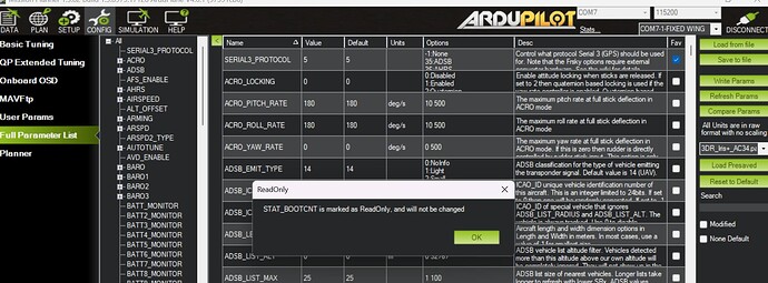

But i have found the solution.
  1. Disconnect Cube from ADS-B board (Physically)
  2. Connect it back to the ADS-B board
  3. With all disconnected devices run MissionPlanner, not connect
  4. In Mission Planner go Setup → Install Firmware
  5. In the Cube was programmed the Plane, that is why in the firmware options i have choose the Copter and updated with Copter.
  6. Cube Resurrected ! and i could connect in mission Planner
  7. Disconnected from Mission Planer and disconnetc USB

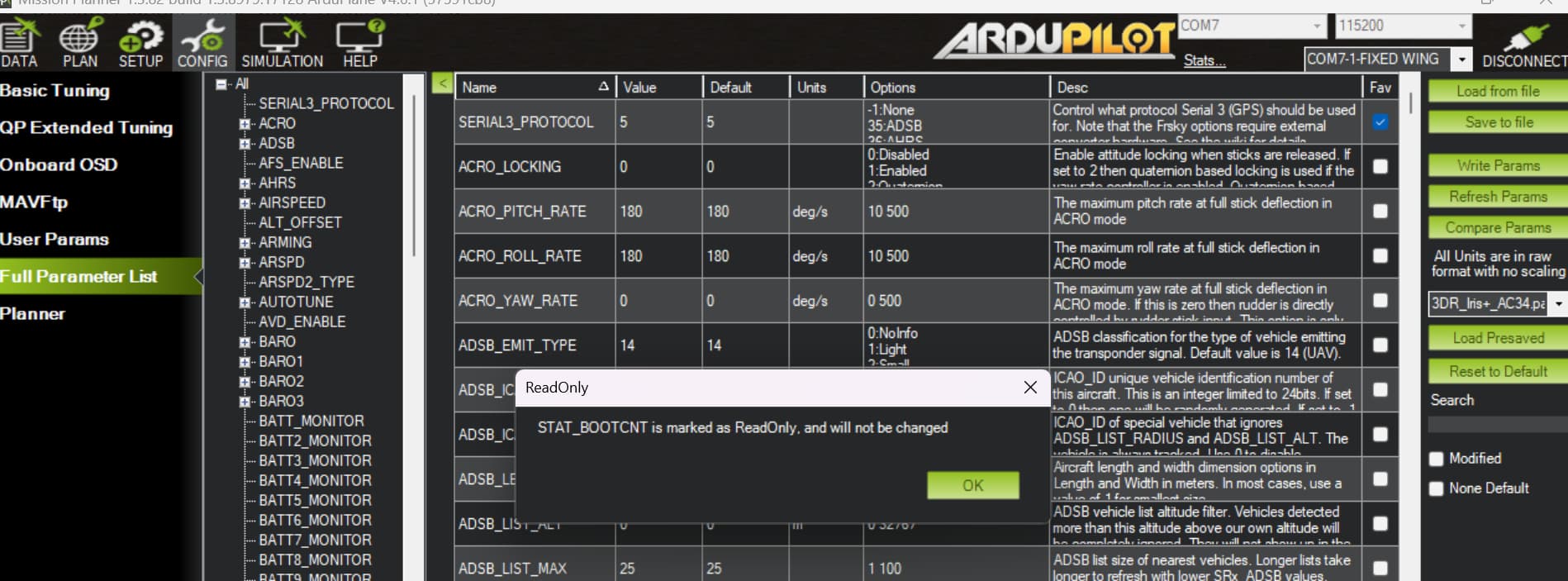

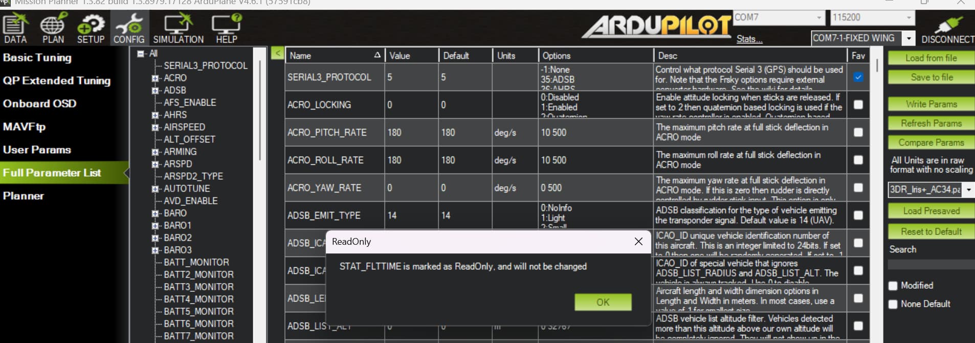

  8. Connect with USB and Update firmware again with Plane.

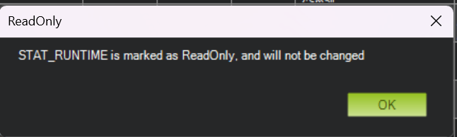

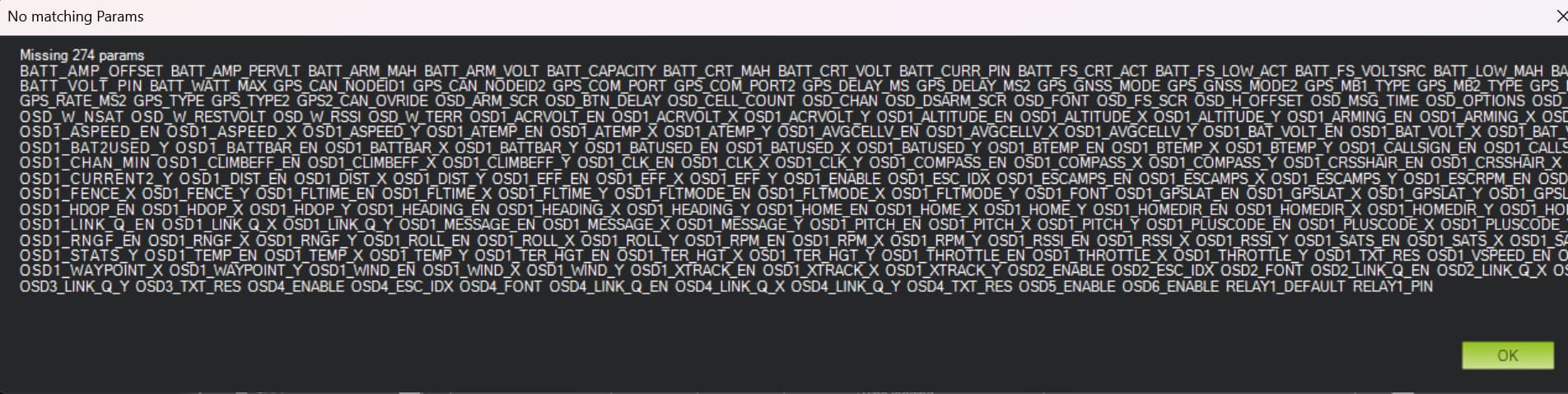

  9. Updated but all settings missed, when i tried to load setting from file it is sends bunch errors
Errors:
manual return settings back is working and Cube again alive
So this was the problem.
