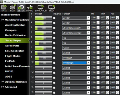

Use the Main outputs for the servo’s and 2 Aux outputs for the motors. What’s the problem?
Go here and page down to PWM Output
Thanks, i just read in some places that the BEC could not go into the AUX. One of the reasons i could find was that the BEC could be 5V and that would not work with the rails 3.3V setup.
This probably won’t exactly match your configuration but you get the idea:
Thank you very much. Have a nice rest of your day!
You don’t need for each servo an own control channel from the FC. You only need for each independent function a seperate channel. So for example the 2 elevator servos can just be connected via a Y-cable together to only one port. Maybe the same for the 2 flaps servos
Good point. Although on some Planes I have put them on separate channels anyway for future options.
