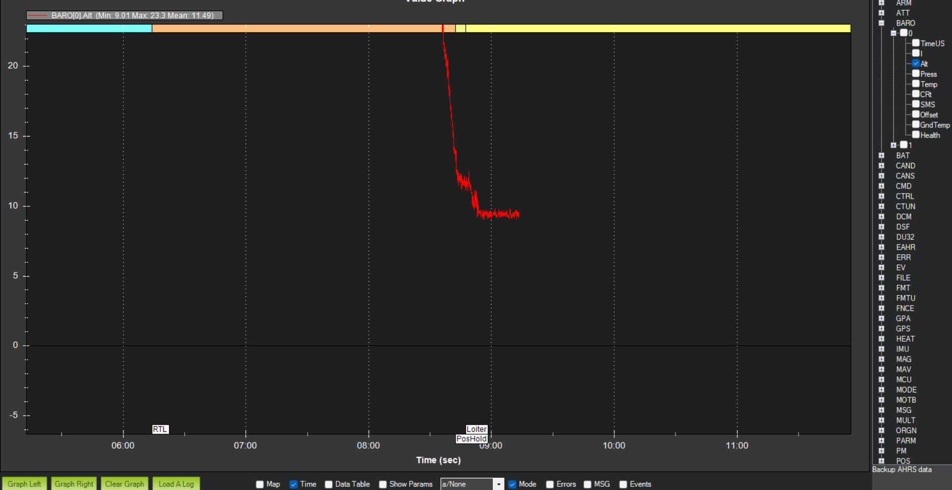

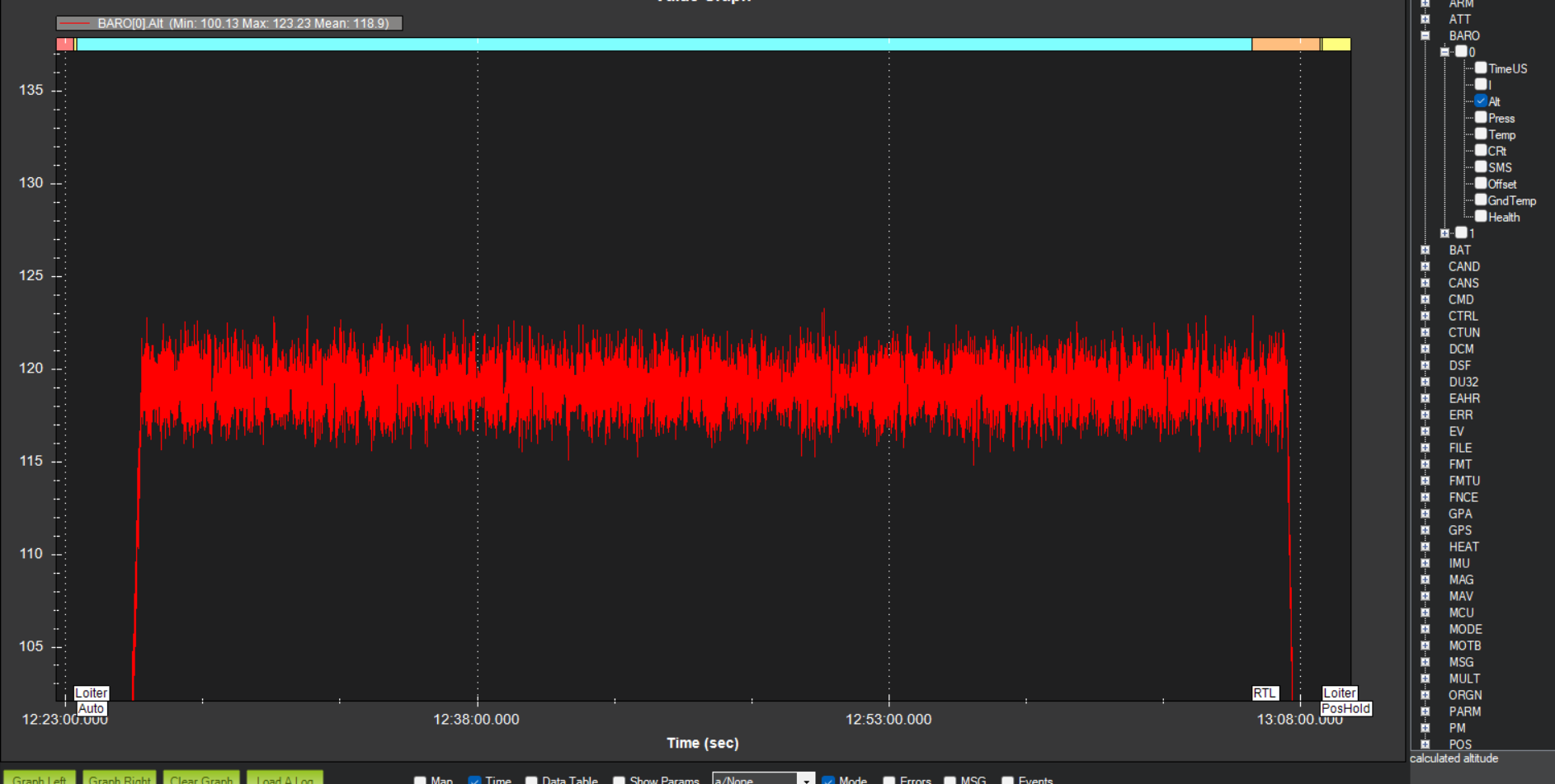

Hello Everyone,
My quadcopter is showing an issue with the barometer. I ran an autonomous mission as part of an endurance test for certification. I set the altitude to 120 metres, but the barometer readings exceeded the setpoint, ranging between 120 and 123 metres on the graph.
Additionally, during landing, there’s a variance of 7 to 10 metres in altitude, which appears to be temperature-dependent. In cold conditions, it shows a negative altitude error (e.g., -5 metres), while in hot conditions, it shows a positive altitude error (e.g., +5 metres).

And also i upload a full log for your Reference
You’re pretty lucky. Default pid tune, and no filters, and this is flying reasonably well. A little bit of work and you’ll have a good machine on your hands. Before you start chasing any baro issues, get the tune sorted out and I think that will help a lot. You’ll probably also improve your endurance testing.
