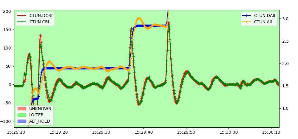

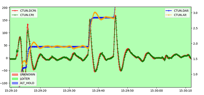

Hello All,
I am tuning a multicopter that I built, and it oscillates up and down in loiter mode after sharp altitude changes.
According to the logs (especially noticeable in the attached log, 339s - 340s), the CTUN.Alt keeps increasing while CTUN.CRt is negative. My understanding is that there is approximately a 1-second delay in CTUN.Alt that causes oscillations during rapid altitude changes. Please help me figure out what may be the issue.
Thank you!
Here is a link for the log: https://drive.google.com/file/d/1Deih9g_LQtdDLz32CgfZXqHaVTVvyLL7/view?usp=drive_link

I do appreciate the answers, but with all due respect, I still believe that filtering is not the problem here, as:
  1. The acceleration graph (PIDA.Act) follows the target relatively well and with a reasonable delay of 0.05 seconds. At this point, I am happy with how the acceleration controller behaves.
  2. The vertical velocity graph (CTUN.CRt) follows the target relatively well and with a reasonable delay of 0.2 seconds. At this point, I am happy with how the velocity controller behaves.
If anyone could explain why CTUN.Alt graph is increasing while CTUN.CRt is negative, and why there is a 1-second lag between them, I would greatly appreciate it!
Looks to me like it’s going negative because the altitude controller is over shooting the desired height and trying to correct. Try the P & I values I suggested before.
Yes, it is overshooting and trying to correct itself, but my question is:
Why CTUN.Alt is increasing while CTUN.CRt (derivative of CTUN.Alt) is negative?
Negative CTUN.CRt (climb rate) means that the drone is going down. Thus CTUN.Alt (altitude) should be decreasing, but it keeps increasing for about another second.
Also, if you look at the Baro and GPS data, you can see that CTUN.Alt does lag behind them as well.
Since CTUN.CRt follows CTUN.DCRt closely, there are no issues with filtering, acceleration PIDs, or velocity PIDs.

As for your original question, I don’t have a solid answer. The CTUN.Alt is very clean compared to the baro data, so I suspect it is an output from the EKF. Just as there’s positive alt change with negative CRt, there is also positive CRT with no Alt change. As such there may be a delay in the logging. That’s a guess. I’ll back off and see if anyone closer to the code has a better answer.
Thank you for your advice!
I changed some of the settings as you recommended, and it probably helped with overall flight performance, but it didn’t help with my issue.
I finally figured out what was the problem - It was the NewBeeDrone RemoteID module. It does not support GPS autoconfid and sends the GPS data to the flight controller with nearly a 1-second delay. After disconnecting it and installing a regular non-RemoteID GPS module, the problem was solved.
