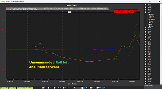

During an autotune flight I first noticed odd movements on pitch during roll tuning. The drone was able to recover those and continue. Then during pitch tuning the drone rolled left drastically and crashed full speed into the tree next to it.

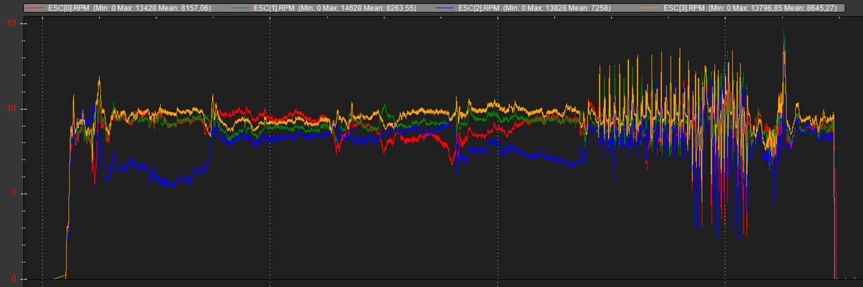

  2. Motor 3 (back-left, BF X reversed) seems to spin on lower RPM than the other motors. This is observable in the autotune log but here’s a screenshot of the RPMs from a later flight. Additionally the current readings from the esc seem quite odd to me as well. So I suspect there may be something wrong with the esc. Either faulty data or real data and a faulty esc or motor.

Can anyone help me explain what caused this movement on the pitch axis during the roll movement and later vice versa?
Could the RPM deficit on M3 cause cross-axis coupling during the large autotune roll step and could that be the cause?
Does the data point to a broken ESC or motor, and should I replace it?

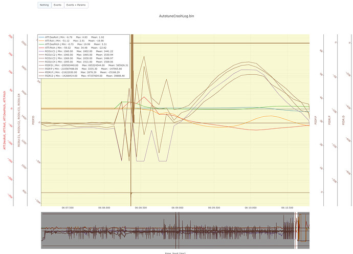

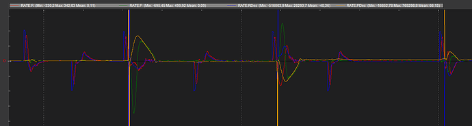

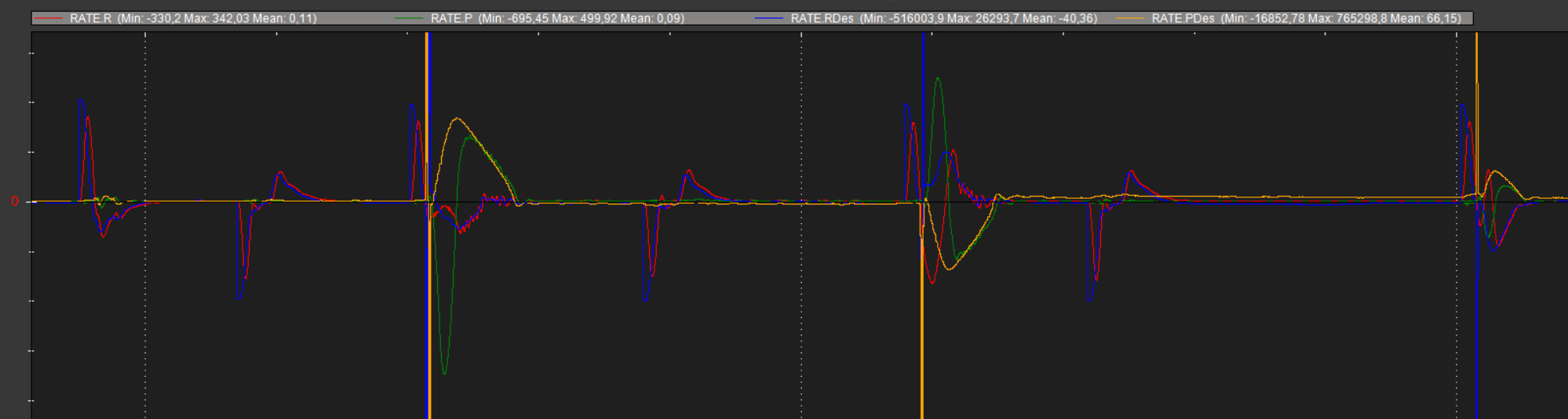

I observed something really peculiar in the crash log.
Right before things went to hell, PIDs on roll and pitch, in P and D, spiked to insanely high values.
I guess this should never happen, this is remarkably similar to division by near-zero, and should probably be investigated further by people like @andyp1per. It might be fastrate-related.
UPD: I have seen some of these in the same log earlier, which did not lead to the crash immediately, so I have no idea how serious or normal this is. I have never seen anything like this in my logs, including those with fast rates though.

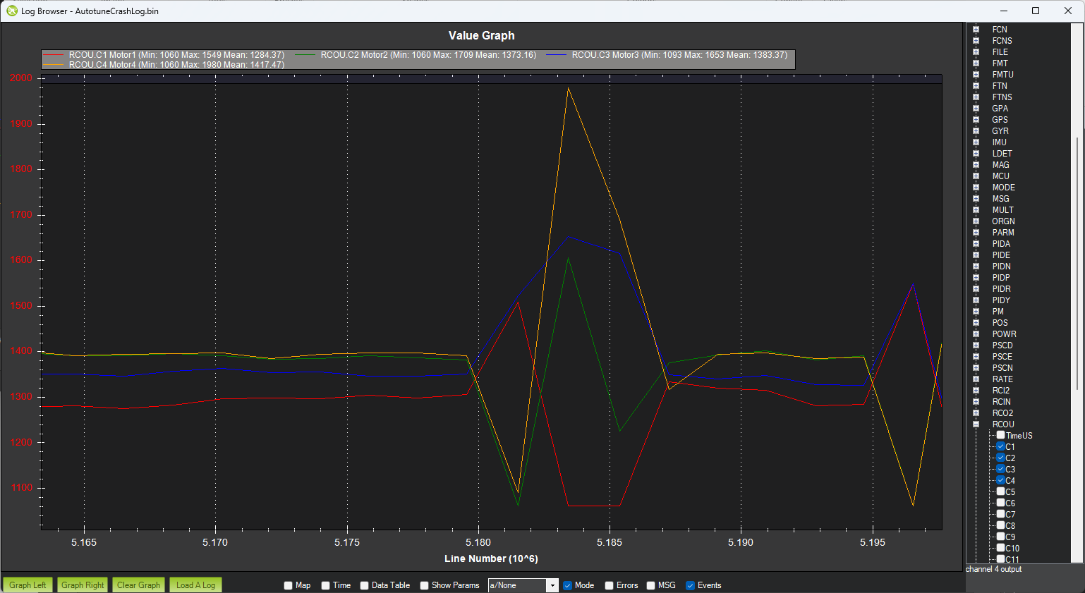

It looks to me like a failure (or partial failure) of the back-right ESC or motor. The reason that I think this is:

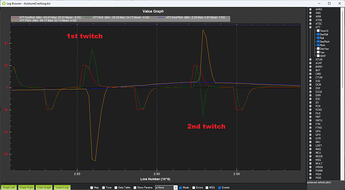

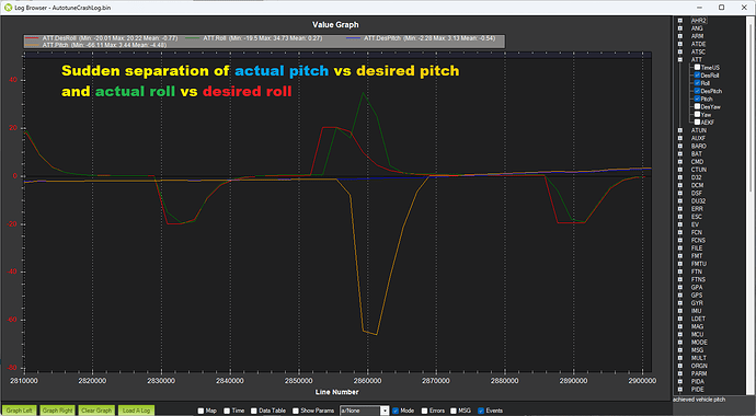

  1. Sudden separation of the desired roll and pitch vs actual roll and pitch
  2. The vehicle pitches back (ATT.Pitch becomes negative) and rolls right (ATT.Roll becomes positive) which is towards motor 1 (this is a Quad X BetaFlight style)

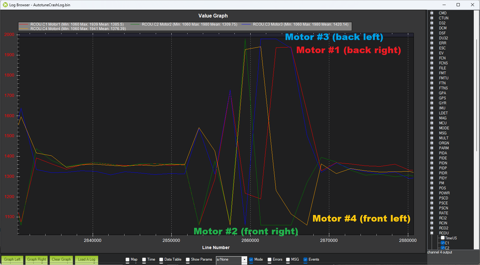

  3. Motor 1 (back right) and #3 (back left) go high while motors #2 (front right) and #4 (front left) go low but this doesn’t stop the vehicle rolling towards the back motors
This is the classic sign of a motor or ESC failure although I can’t say that I have a huge amount of confidence in this diagnosis because the incident is very short and it appears there is a twitch in the opposite direction a moment later.
I’ve added this to the 4.7 issues list so it will receive some attention from the likes of @andyp1per and @Leonardthall

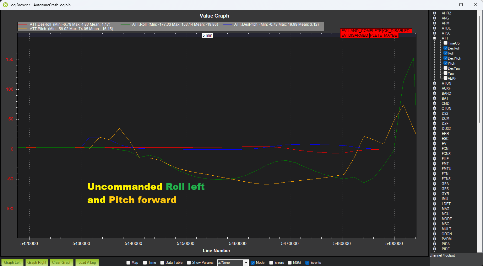

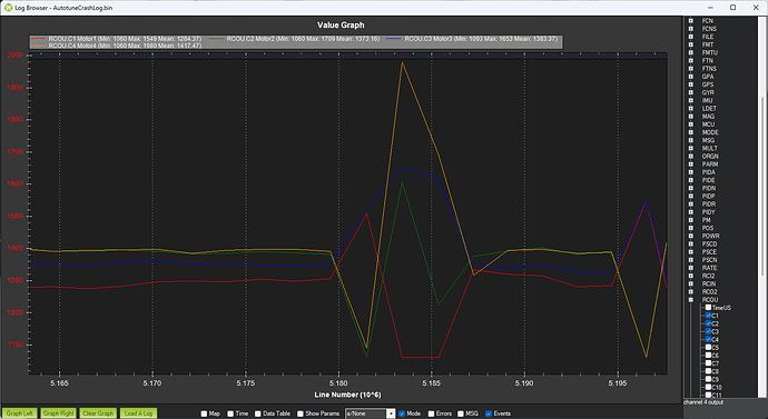

As a follow-up at the end of the log when it crashes, it is an uncommanded roll left and pitch forward towards motor 4 (forward left). In the RCOU motor outputs we see motor 4 go high and the opposite motor 1 go low. This again indicates an ESC or motor failure.
Motor outputs, motor 4 goes high, opposite motor 1 goes low
So I think it’s definitely motor/ESC related but it’s probably not as simple as failed hardware. Maybe a signalling issue or ESC configuration? .. or maybe the ESCs just can’t handle the stress that autotune puts on them?
From a 4.7 issue tracking point of view it would be good to know if these issues are also present in 4.6 and whether they only happen when fast rates are enabled.
