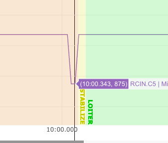

the drone was in auto mode doing the mission and then we lost radio and we already setup the RC Fail safe to “RTL”. However for some reason drone went into stabilize mode and then loiter mode. (By this time drone is already established link to telemetry). But again, there was no manual input from RC to turn to loiter or stabalise. Also in logs thats what we see. Please see in the image attached.

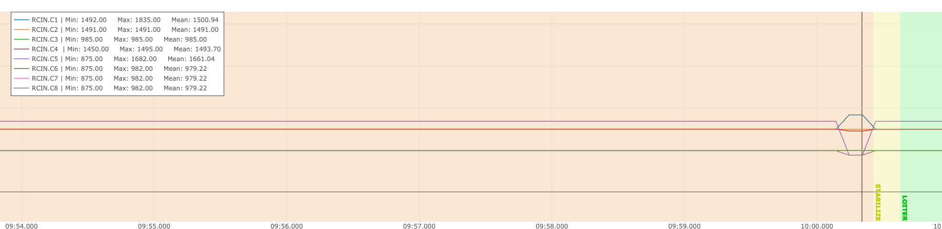

It does look like the flight mode channel had a change via the RC Transmitter, but that could just be another symptom of the reboot. Because of the same effect, the Arm channel came back to high after a short time too, so I think the copter would have been able to fly if the throttle was up.

Do you think the RC Transmitter could have had a power glitch or reboot? That might explain all the channels dropping then coming back? But it didnt trigger an RC failsafe either, so that would be strange. The RC glitch was only 0.3 seconds.

here is the setting and chart when the crash occur do you have and idea on why does it turn to stabilize and then loiter mode? nobody touched the remote control at that time
Either the TX or RX glitched, as all the channels changed briefly.

The Flight Mode and Arm/Disarm channels were both affected at exactly the same time - maybe that can lead you to a clue with your transmitter programming or something…

in the image you can see the drone changed mode to auto mode by GCS cmd
and from next 2 image it looks like something triggered chanel 5 to change the drone mode to stabilize and turned back to loiter right away (based on PWM value) in the range table match with actual value from the log file
can this be the cause ?

    Auto mission failed - mid air change to stabilize here is the similar case when lost connection and the CH5 value dropped to 875
drone listen to RC (STAB) => drone listen to ground station ( turn to auto mode ) => drone lost and regain connection with RC then get STAB mode ?
