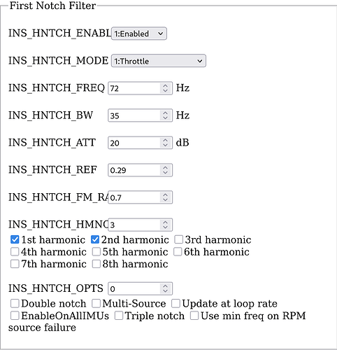

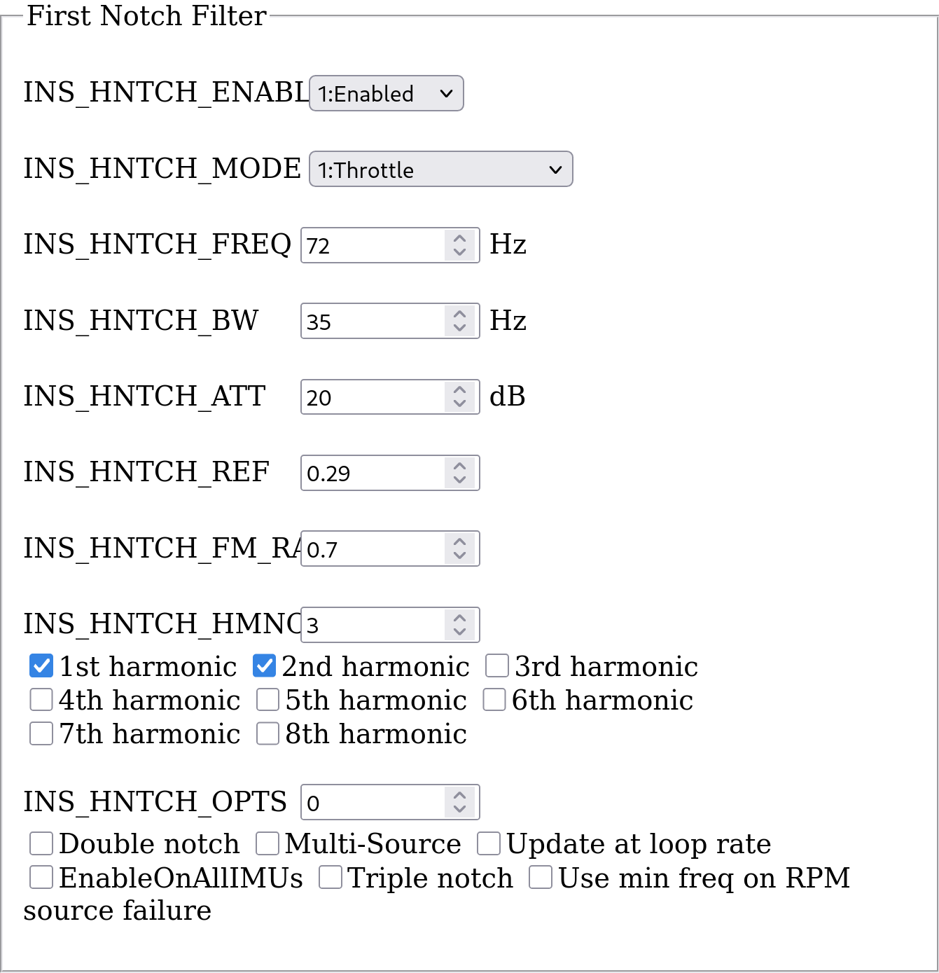

I don’t believe my ESC supports telemetry. Could you please guide me on how to properly configure the notch filter without telemetry data?
Additionally, during takeoff in AltHold or Loiter mode, the drone exhibits oscillations and vibrations for approximately 50–60 seconds before stabilizing. Once stabilized, it flies reasonably well, though not perfectly.
Your ESCs will probably do bdshot if you load the bluejay firmware on them and install the bdshot firmware on the flight controller.
Use these settings for throttle-based notch:
You have a few noise peaks, but not much is getting past the Gyro low-pass filter. I’ve selected conservative values here to provide good filtering without causing issues for the PIDs. If you go with more aggressive settings and more options the PIDs and stability will be affected.
