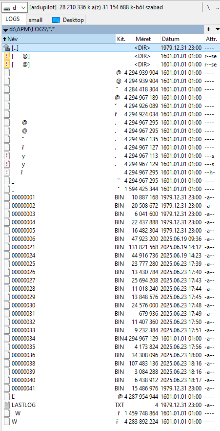

I have purchased a new SDcard (so it’s not used for years) and the LOGS folder gets corrupted, and there’s a lot of garbage. Like somebody shuts down a computer with the power switch instead a proper shutdown command.
Could you please guide me, where to start investigating?
How should I “turn off” the drone, to prevent filesystem corruption?

I suppose you know you have log disarmed enabled?
Hi Dave!
Yes, I know that. I have enabled it, do be able to debug “things” before lift-off.
But this makes sense, the logfile is always open for writing.
I’ll try disabling and do a test flight.
