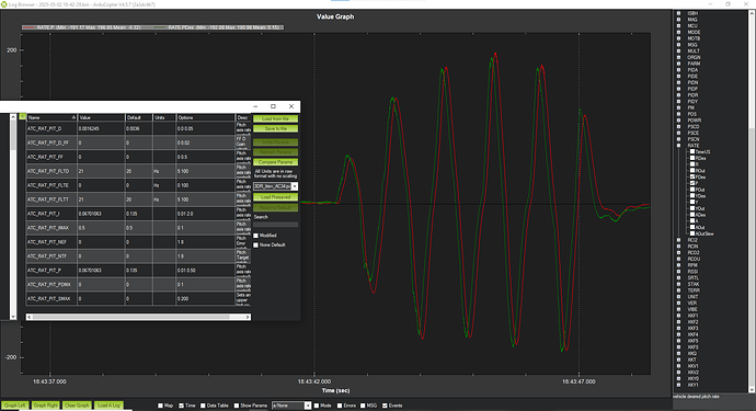

I’ll present my pitch and roll data separately - but would appreciate comments and suggestions on how to go about improving these results

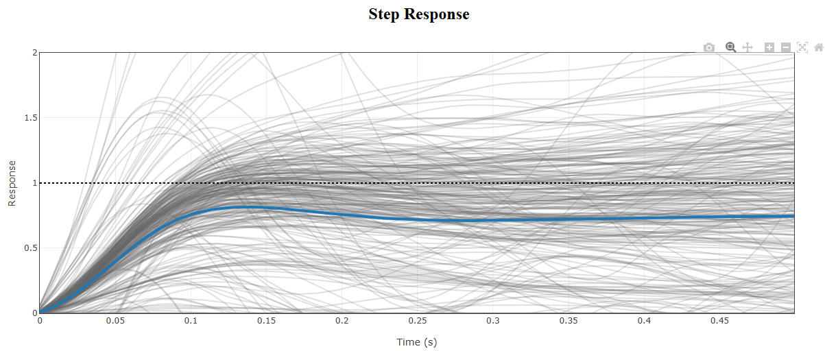

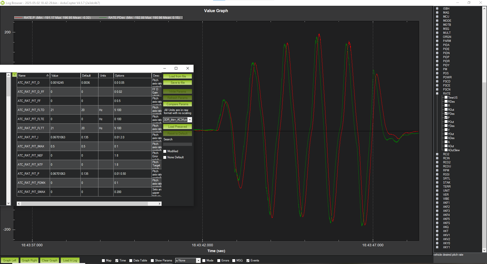

PITCH
Here’s the BIN plot of actual versus requested pitch:
Here’s the PID Review plot of pitch time domain:
And here’s the PID Review plot of the pitch Step Response:
In flight, pitch response properly - although the Step Response chart suggests that P-Gain should be increased.

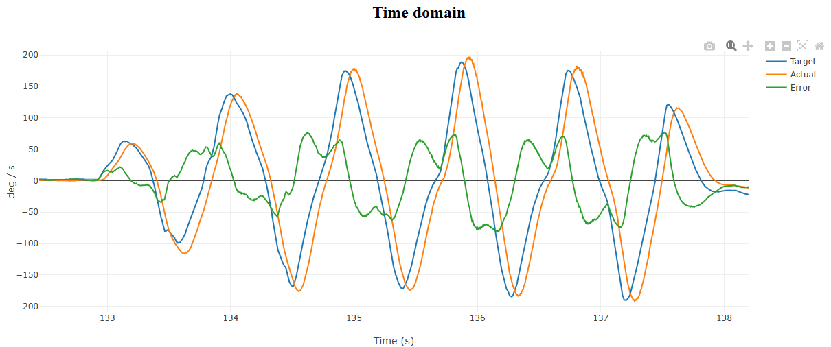

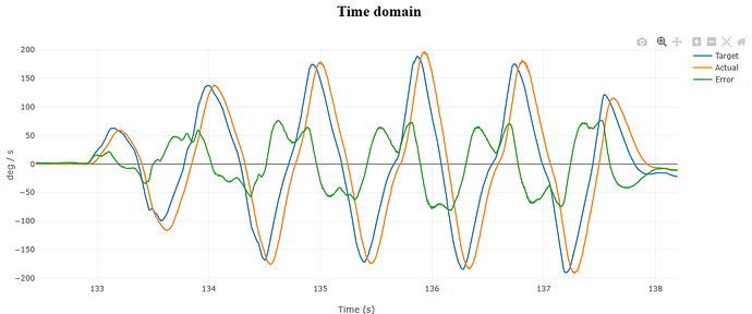

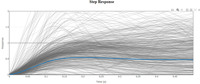

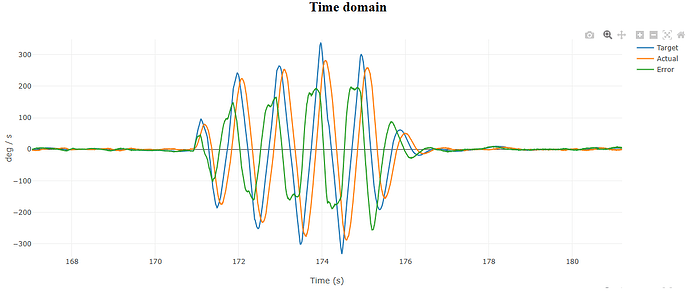

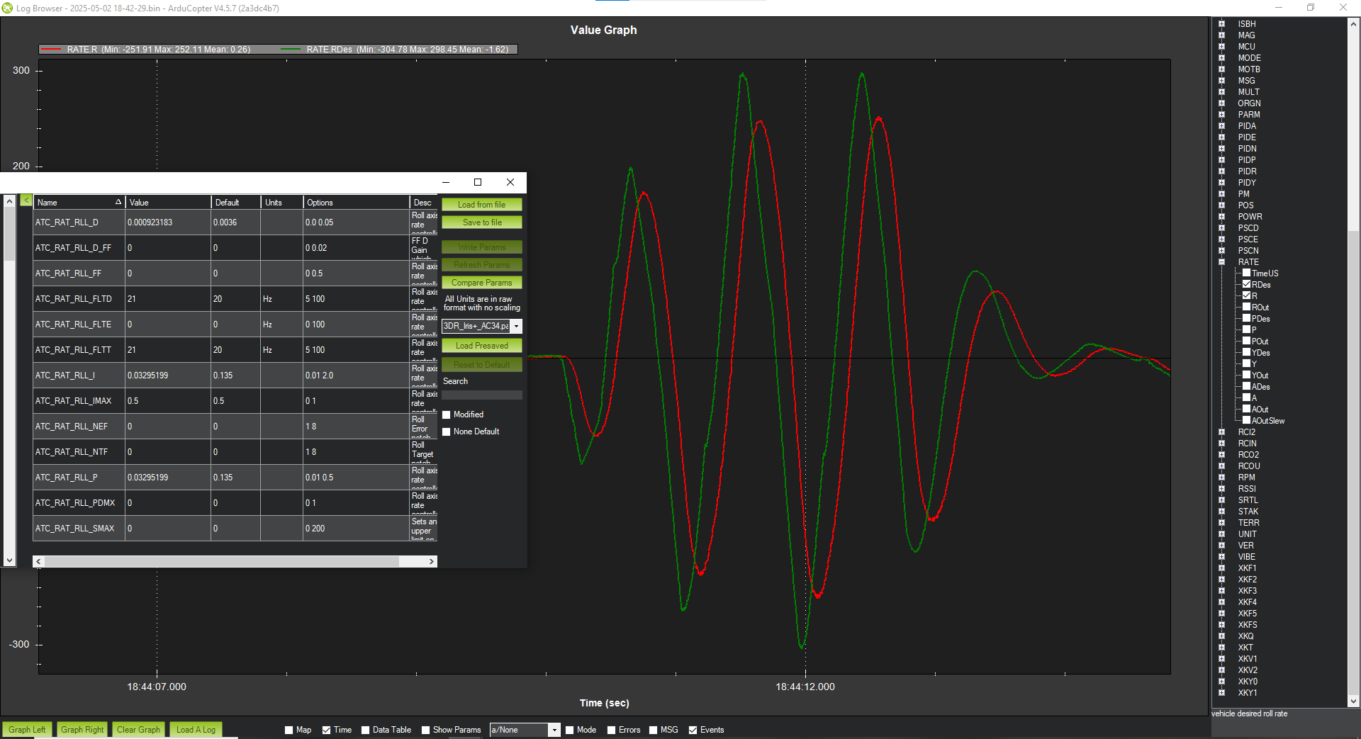

ROLL
Here’s the BIN plot of actual versus requested roll:
Here’s the PID Review plot of roll time domain:
And here’s the PID Review plot of the roll Step Response:
In flight, pitch responds more aggressively than roll - and will roll back and forth very slightly after releasing the sticks when returning to level flight. This behavior has been reduced a great deal as I’ve slowly raised all the roll PID gains.
The charts suggest that the P-Gain for roll should be increased, but as the copter rolls back and forth a slight degree still to settle, I’m wondering if roll P-Gain is already too high.

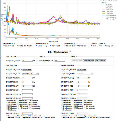

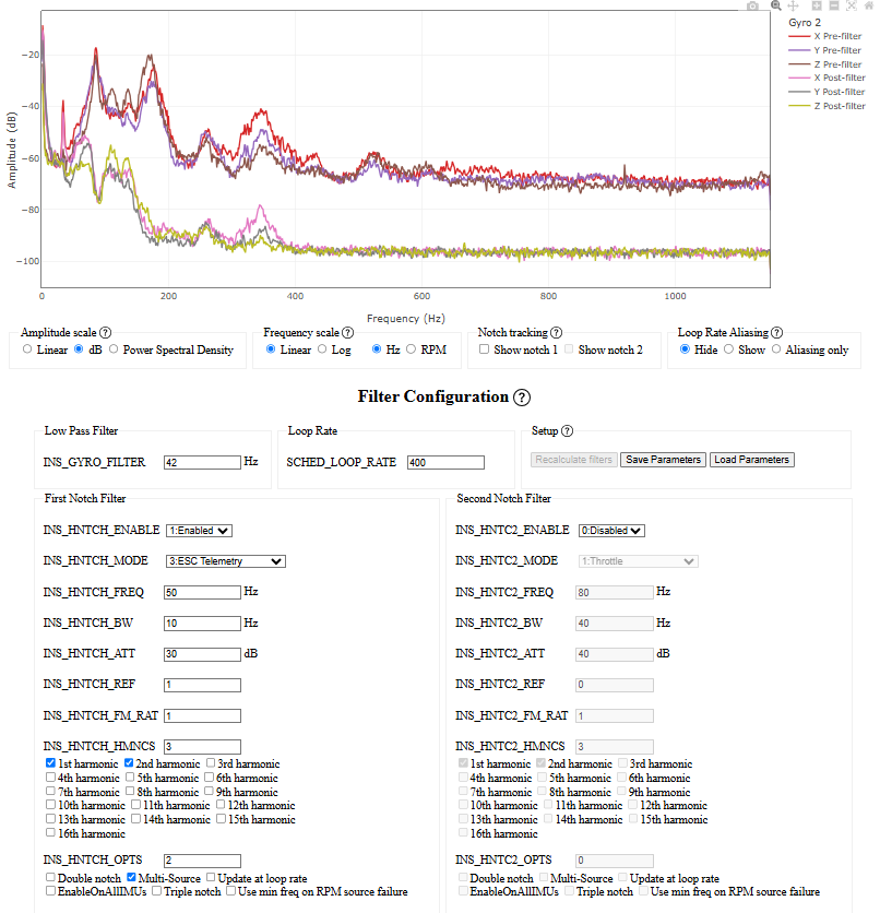

Use these settings. They do quite enough of noise filtering without causing too much lag or interference. The settings you had were actually doing almost nothing at all, post filter noise was almost equal to pre-filter noise.
If you suspect the notch filter is still interfering then deselect Multisource. Deselecting it wont hurt anything either so dont be afraid to go without it.
You really only need INS_LOG_BAT_OPT,4 - sensor rate logging is only important if you know what to do with it and you are looking for a specific issue. I’m sure I dont know what to do with it :slight_smile:
I cant recall if it’s required for the PID tool though.

Thank you for your analysis of my BIN file and detailed analysis. Sorry for my late response - I’ve been away for a few days.
Here are some thoughts/responses to your comments:
  1. I had noticed that the Notch Filter was doing very little. I explored a few ideas about this and then noticed that the vibration level on this quad is very very low. (especially on IMU0 and IMU1) I suspected that may have been the reason that the Filter Review Tool showed so little notch filter attenuation. You can see the low vibration level on the Amplitude vs Frequency chart on the Filter Review tool - and the VIBE levels in the BIN file.
Also - there’s something weird about the Filter Review Tool. If you load my BIN file but then add the check for displaying “Estimated Post Filter” - it shows the sort of filtering one might expect. And it does this without adding or changing the filter settings. So I’m wondering if there is a bug in the Filter Review Tool web site.
Here’s what it shows - with no changes to the filter settings - but including the “Estimated Post Filter” plot:
Regarding your proposed settings - I don’t know how you came up with them - perhaps you can explain. My understanding is that with a hover RPM of 5000, a notch filter frequency of 84 is correct. Maybe your results reflected that you simply included the “Estimated Post Filter” plot.
  1. Thanks for the tip about INS_LOG_BAT_OPT,4. I’m not sure how I came to include the sensor rate logging - but I’m happy to remove it and have slightly smaller BIN files. If you ever find out how to use sensor rate logging - I’d love to learn about it.

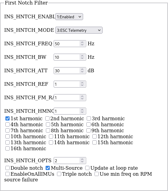

The frequency must be set lower what you would expect at hover (estimate your lowest usable frequency), since the notch filter will never go below this frequency. Similarly the bandwidth should be set proportionally narrow.
That is all because the RPM (from ESC data) will scale your values UP to the correct frequency as required, along with the bandwidth to suit too.
That’s my understanding and the way I’ve always used the ESC/RPM-based notch filter.
Thank you Shawn - your advice on setting INS_HNTCH_FREQ made all the difference.
I went back and re-read the wiki about setting this parameter - and it’s consistent with your advice - but the language in the wiki probably ought to be improved.
Following your advice, I achieved this result with the notch filter:

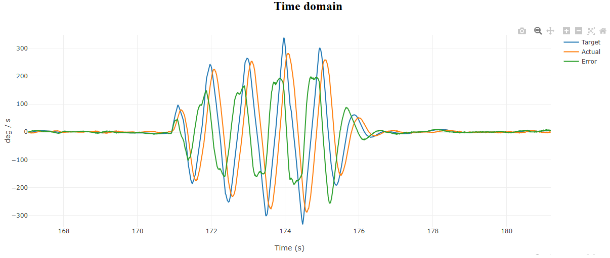

This in turn allowed the PID’s to behave properly - making it possible to use the PID Review Tool to set the PID’s properly. I did about 10 test flights yesterday making minor changes to both pitch and roll and achieved results that are satisfactory.
The only parameter I’m a little unclear about is INS_HNTCH_ATT. You suggested a lower value than I’m familiar with. Can you please explain how you dirived that value - “30”.

INS_HNTCH_ATT is the attenuation of the notch in decibels, how sharply it will punch down the noise. With a “MultiSource” notch, this value is “Per Notch”, so you will have N notches where N is the number of sources you have, usually ESCs.
When using MultiSource, it is good practice to reduce the Attenuation and Bandwidth, since in reality the noise you want to filter is an aggregate of all motors. If you yaw and half go high and half go low, you have two peaks and need 1/2 the filtering on each (roughly). You don’t necessarily want the notch settings that would track the aggregate peak to be in effect N times greater.
