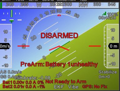

It can he confirmed in Mission Planners HUD. Is the artificial horizon correct when you pitch and roll the craft?
What Flight controller is it?
Horizon apears level, ±0.5° on room floor. It is a Cube Orange FC.
Not what I asked. But, it’s hard to get a Cube wrong. Look like this?
Roll right (left side high):
Pitch down:
Sorry, I missunderstood this. Yes it does and reacts as I would expect it.
Roll copter left → Horizon turns clockwise
Pitch copter up → Horizon sinks down
Turn around yaw CW → Compass moves CW
