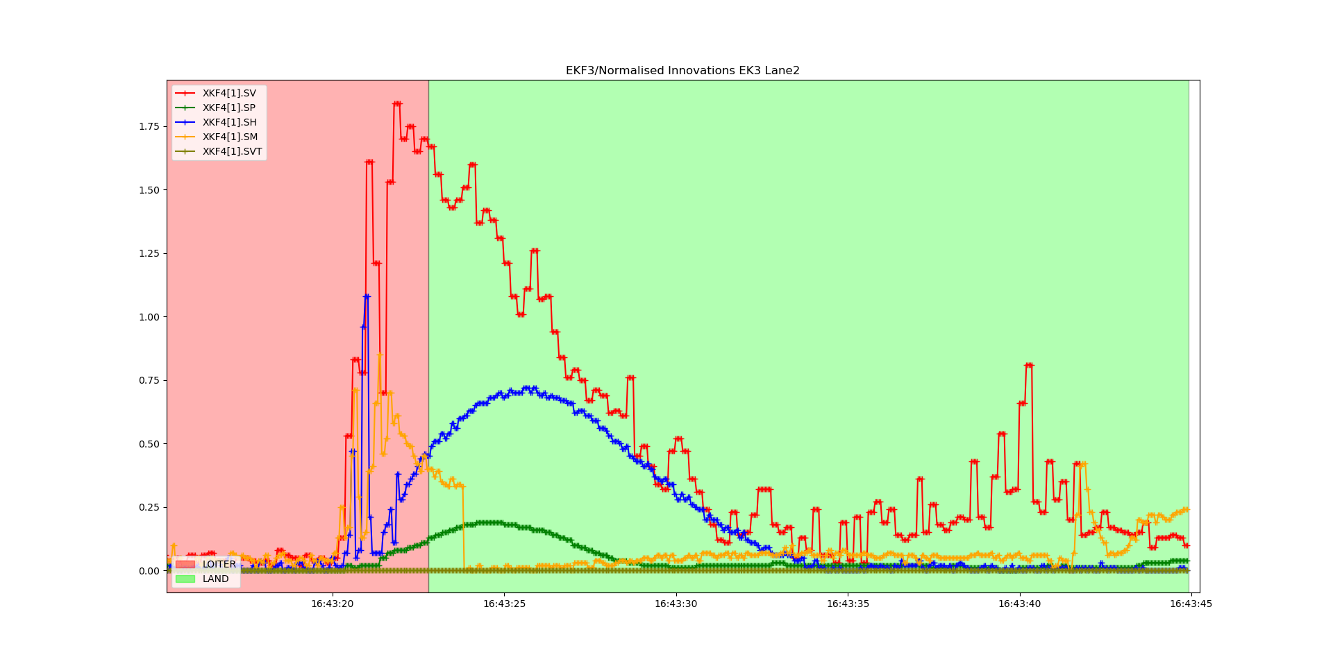

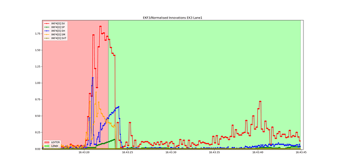

I’m not all this knowledgeable in this area - but it looks to me like there was a EKF3 lane swap do to high innovations, a EKF3 failsafe to LAND mode, and loss of control as the copter fell.

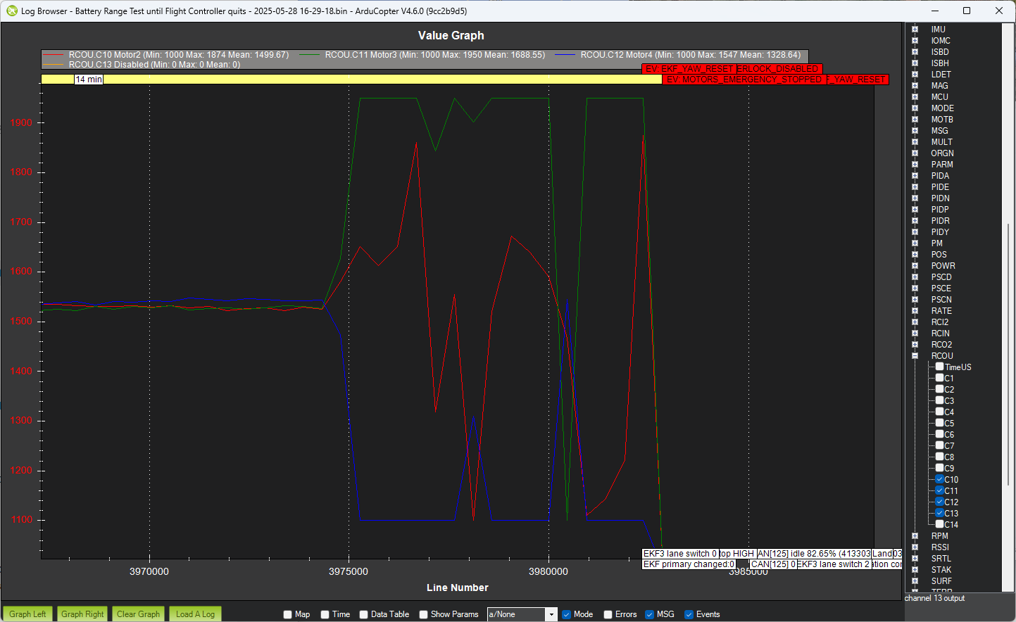

Here are graphs of Lane 1 and 2 innovations at the time of the crash:

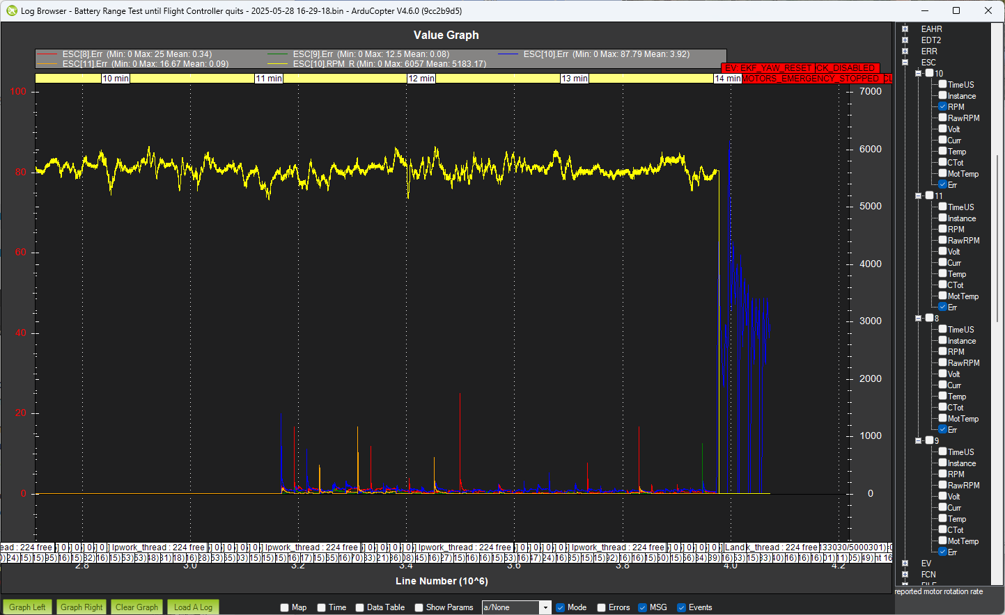

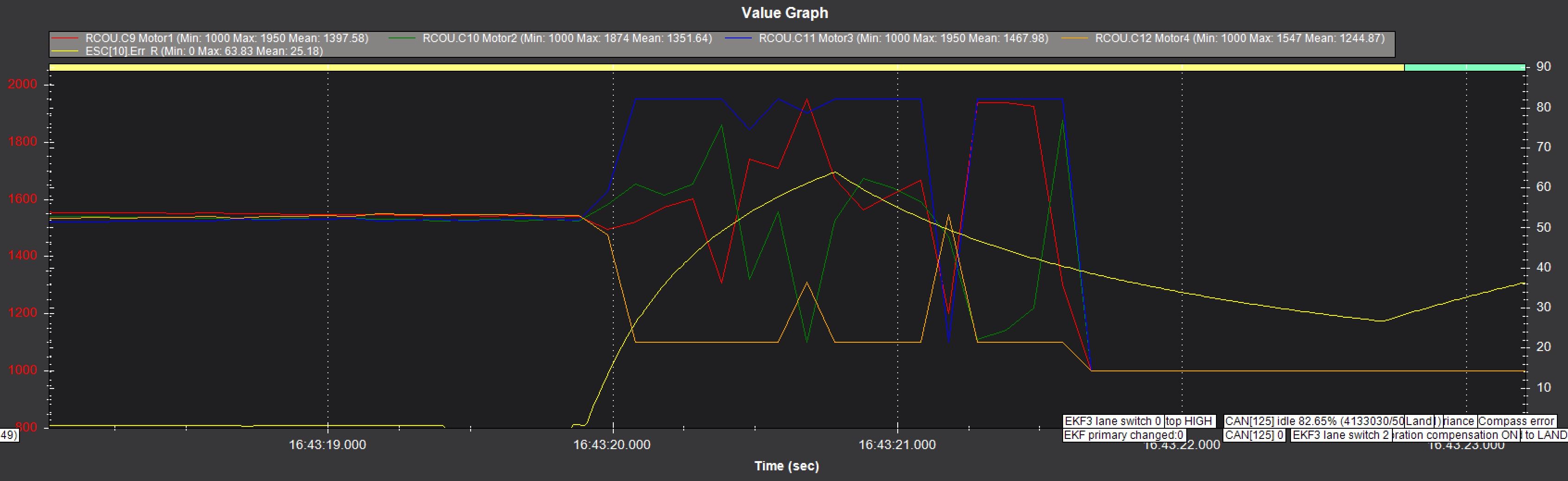

What you noted is after the fact. Thrust loss on Motor 3 in sync with an ESC error. Motor 4 drops and it’s done. Lane switching, EKF errors, Vibe comp and FS action comes after this.

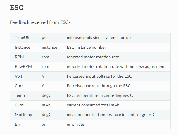

Thank you Dave. Excellent - I haven’t charted the ESC.nn.ERR parameter before. The wiki says very little about it - other than it’s a “rate” no an absolute.

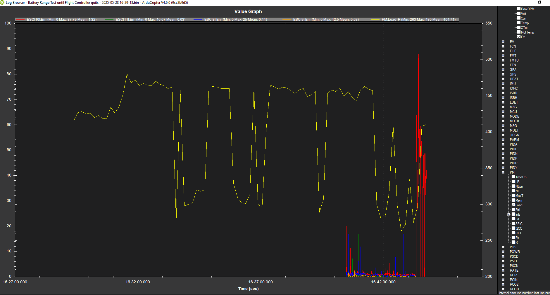

If you looked at my last post where I noted a sudden increase in X-axis vibes for IMU0 and IMU1, (no change for IMU2) there was also an increase in CPU load that happened a few minutes later.
The raise in CPU load is associated with ESC errors on this previous flight.
So that establishes a relationship there.
On today’s flight - it’s different - the CPU load hovers around 400 the entire flight.
So the question I propose from this: Do the ESC errors come from a failing ESC, or is there something about the Copter 4.6 BD-Shot firmware that causes it.

I agree with @dkemxr that this appears to be a failure of the front left motor (aka Motor3).
We see the classic signs:
  1. the desired vs actual roll and pitch angles diverge suddenly after having been close together until then
  2. the actual vehicle rolls forward and left towards motor 3
  3. the forward-left motor’s (Motor3) output goes to maximum while the opposing motor goes to minimum

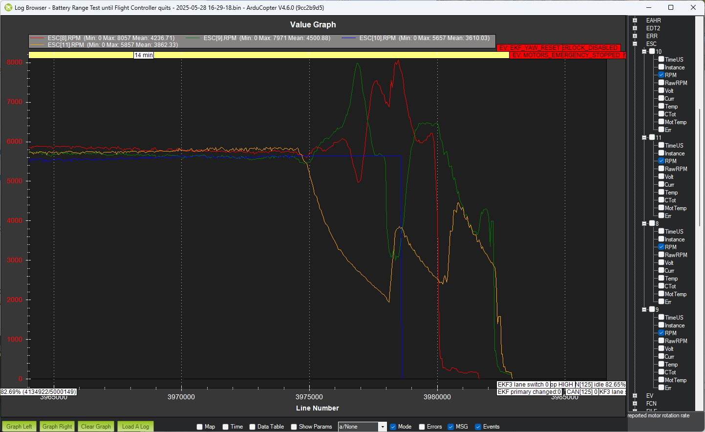

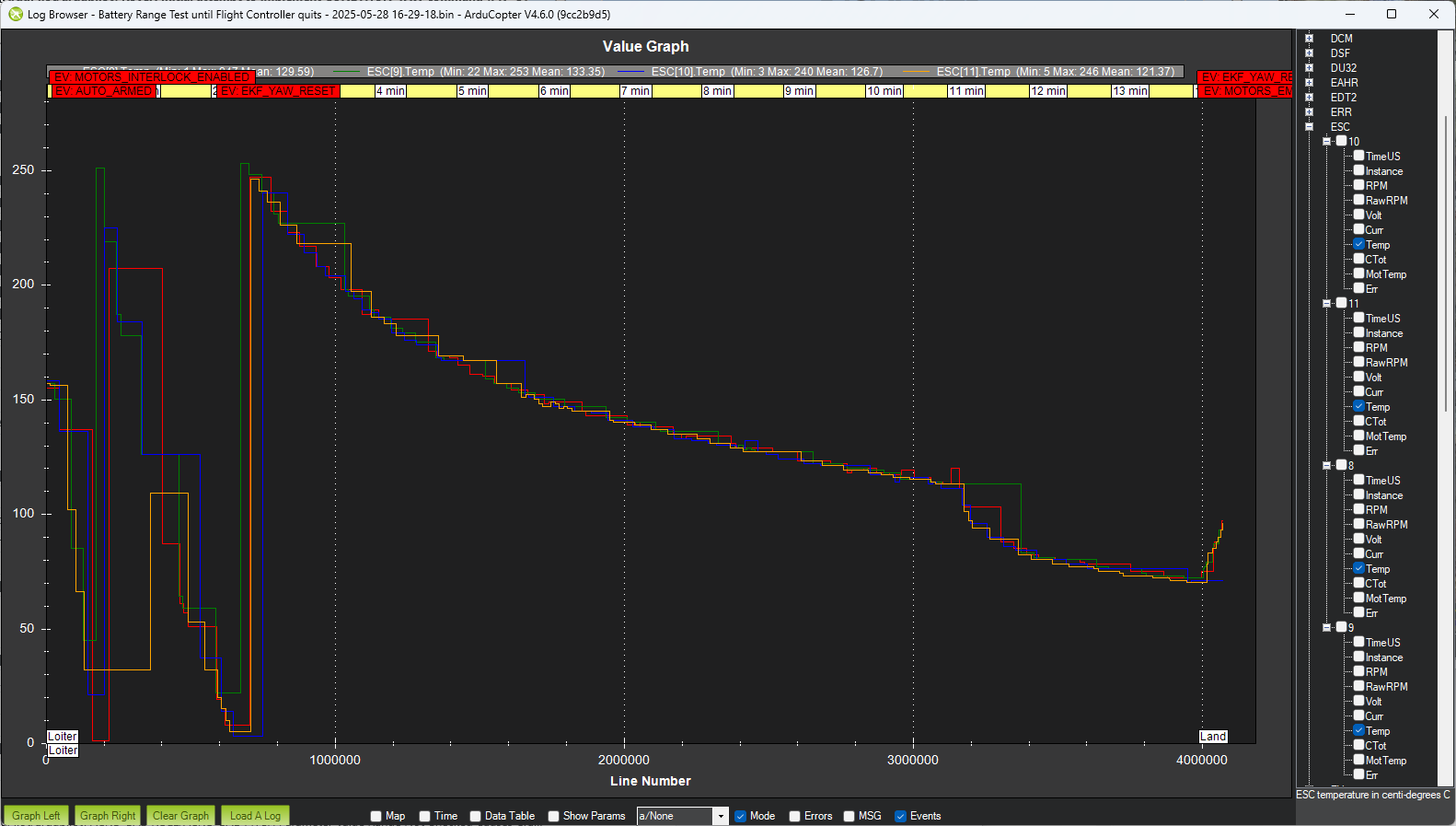

I think this may be the first time I’ve seen a log of a motor failure on a vehicle with ESC feedback. I’m sure others have seen this but it’s a first for me. Some interesting things we see:
  1. the ESC index is one-off from the RCOU field names. So for example ESC9 corresponds to RCOU.C10. This is slightly annoying but I can imagine why it’s happened. We normally use “0” base but for the RC outputs we use “1” based because it matches the labels on the flight controller.
  2. Motor3’s (ESC10’s) RPM output flat lines (see blue line below). This indicates to me the ESC has stopped working completely and is not even providing information anymore.
  1. ESCs 8~10 start reporting errors nearly 4 minutes before the crash. This suggests we should provide more visible warnings to the pilot
Thanks very much for this valuable log!

It also looks like the GPS (node 125) is spamming the autopilot (and GCS) with messages. If this is a Here GPS could you try updating it’s firmware as well? I’m pretty sure this was resolved in recent firmwares. You can see all the spam in the little white labels on the screen shots I’ve posted above

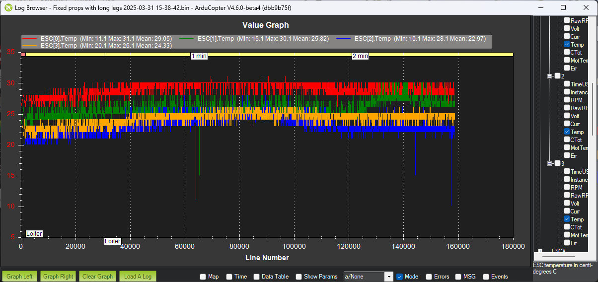

One last thing is I wonder if the ESCs are extremely hot or we have an issue with temperature reporting for DShot ESCs.
From a recent test on my own vehicle using AM32 ESCs with DroneCAN I get much more sensible temperatures
Anyway, I’ll raise this issue with other devs
Extremely likely I would say. Heat in the ESCs or motors causing failure.
To clarify the temperature reporting graphs I’ve posted above. Apparently AM32 ESCs temperature reporting is the ESC MCU temperature not the mosfet temperature.
@jstroup1986, I wonder if you’d be happy to show how the ESCs are placed and whether they’re wrapped or in a case, etc? No pressure of course, I’m just interested as to how an ESCs temperature could get this high.
Joseph had reported this temp anomaly, if that’s what it is, previously and I has suggested perhaps it’s the same issue seen with some other ESC processors (F4’s).

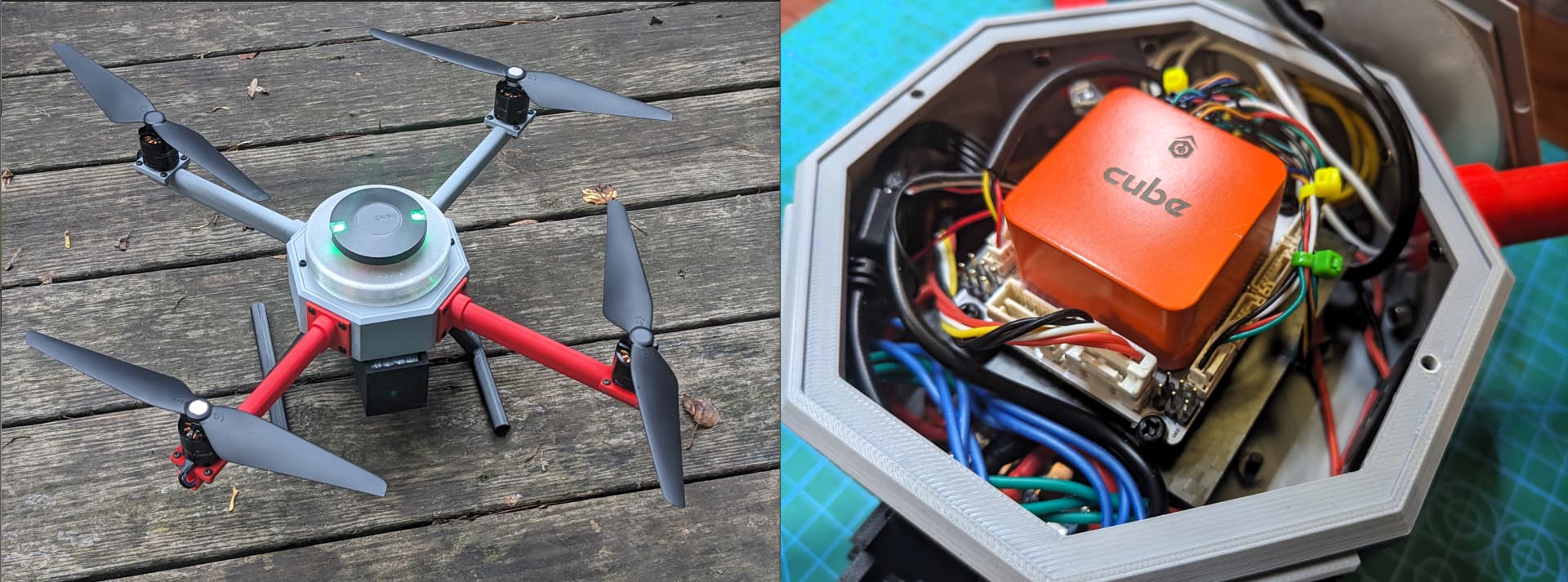

For reference, here’s the quad in question:
The ESC, a T-Motor Tekko32 F4 4in1 Mini 50A, sits in a 15mm space between the frame and the flight controller.
This frame was originally designed for the Holybro Pixhawk 6C Mini flight controller - this is an experiment to see how well it works with an Orange Cube.
The question of ESC temperature has come up before, notably with a Skystars KM55. But other 20x20 ESC’s have been OK. I was aware of the issues of the F4 reporting data. Fortunately, RPM data seems reliable.

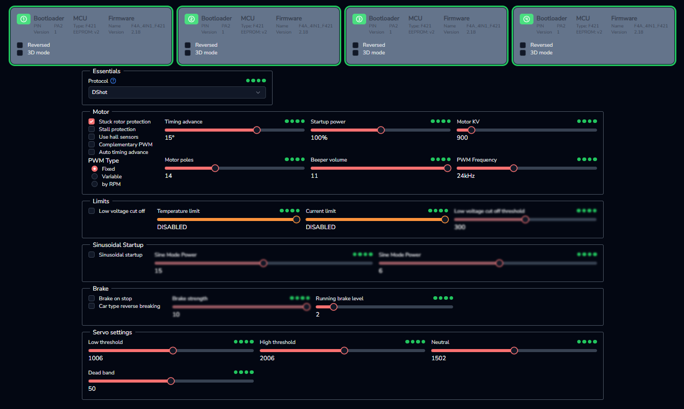

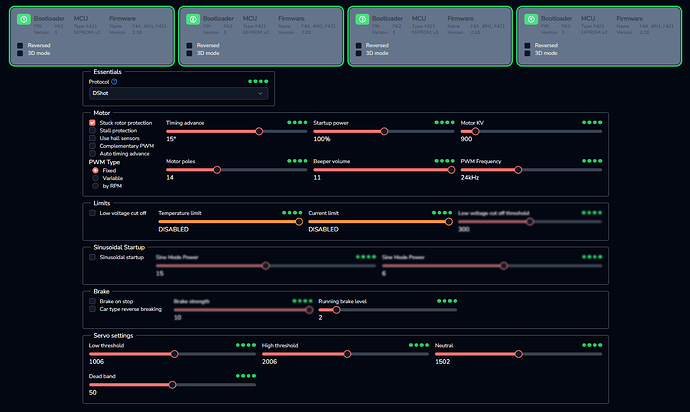

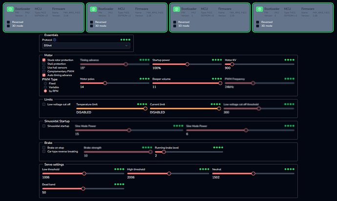

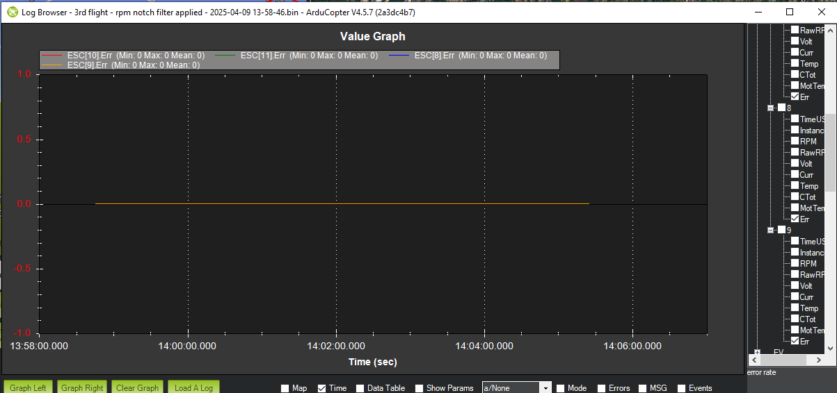

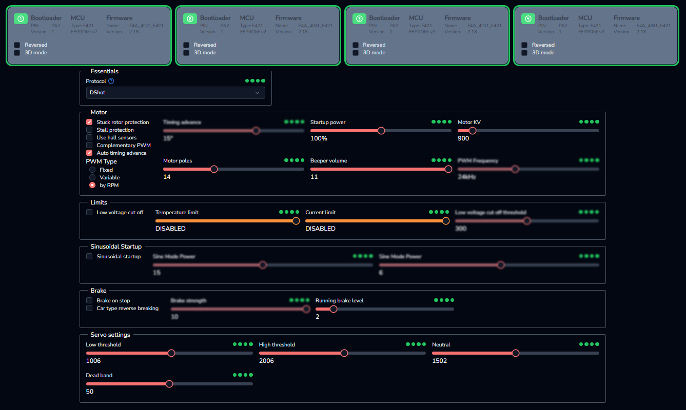

With the ESC errors that @dkemxr identified, I focused on the ESC’s firmware. I checked it ensure it was on the latest release - it is. Then I looked at the settings I’d selected. I decided to de-select the two remaining advanced options. These were my settings:
I deselected Auto Timing Advance - and set 15 degrees. And I deselected PWM Type - By RPM, and kept PWM Frequency at 24 kHz.
My thought was that perhaps by reducing the load on the ESC’s processor, it might generate fewer errors.

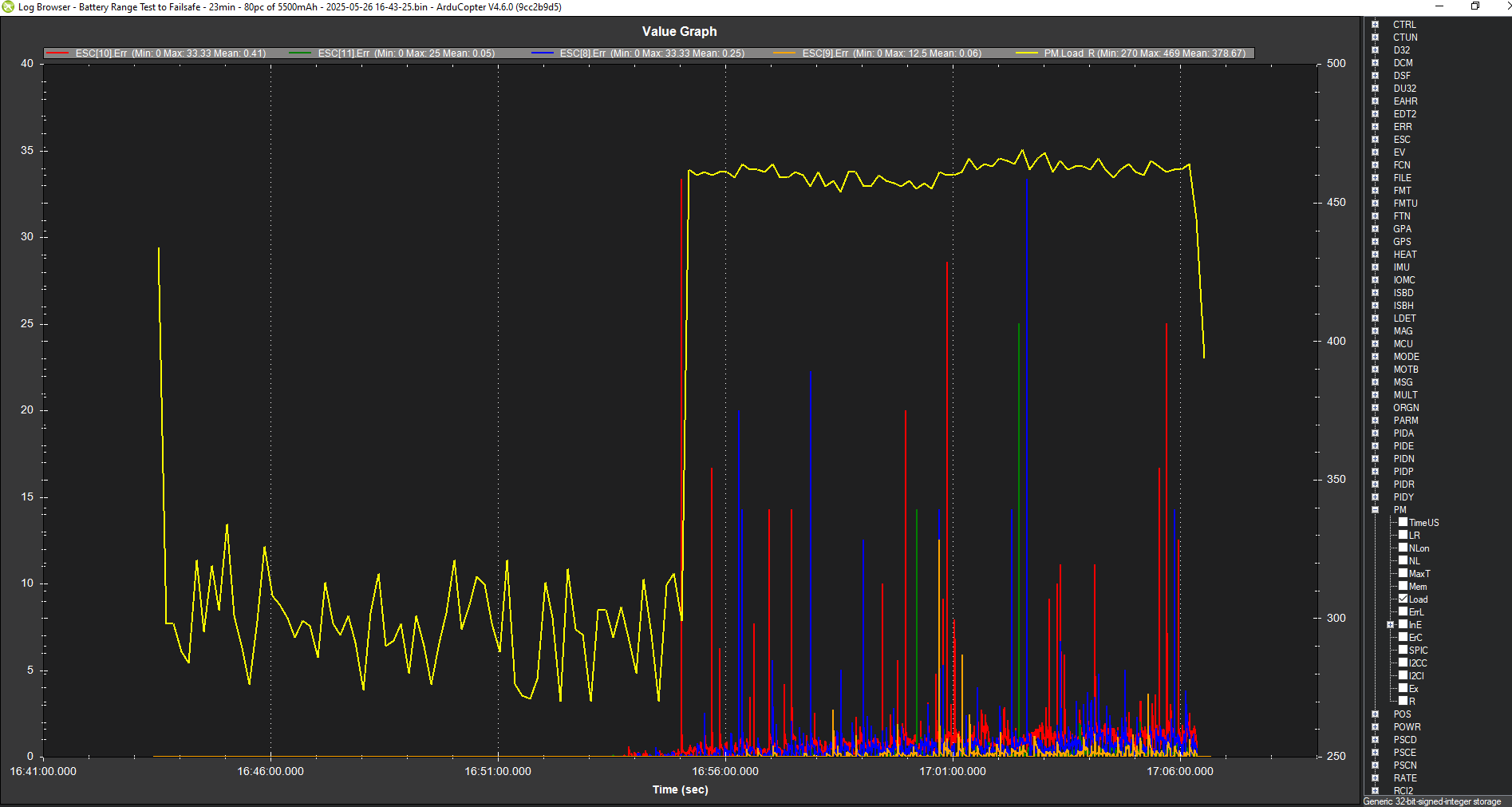

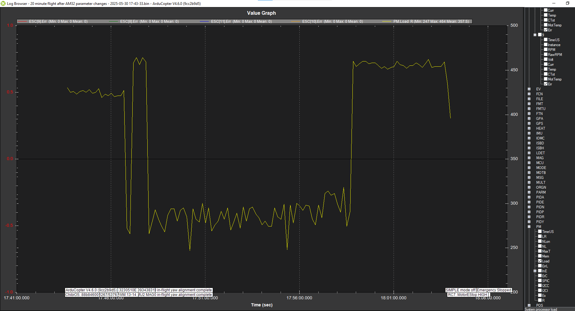

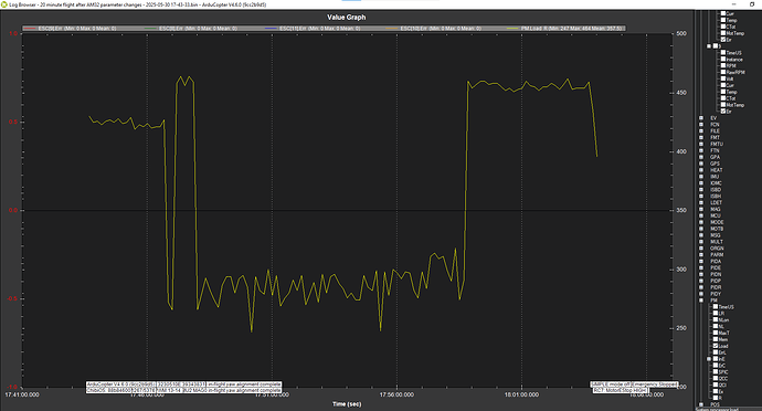

Lucky guess - I flew first a 10 minute and then a 20 minute test flight with no ESC errors.
Here’s a plot of the ESC errors (none) and the CPU load:

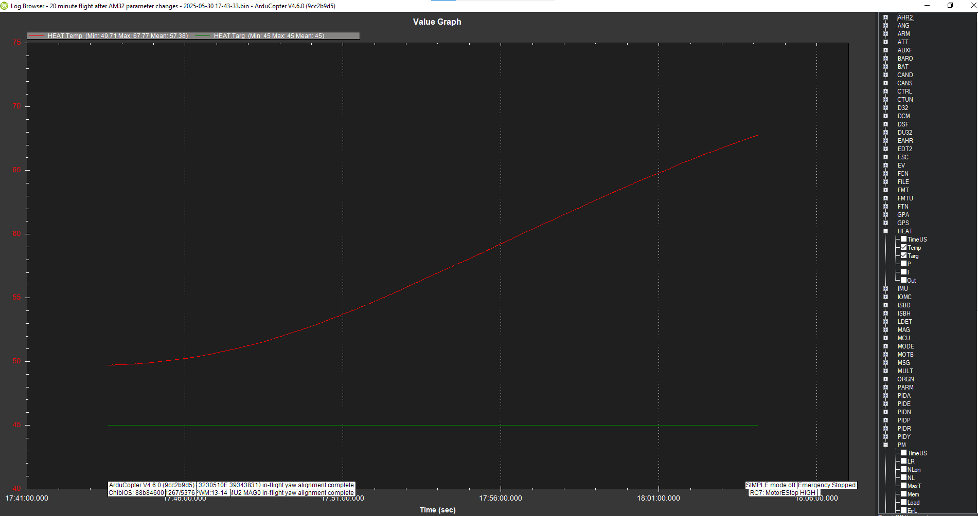

One other thing I did notice is that the IMU temp gets quite warm. I don’t know if this is OK - or a thread and should be addressed.

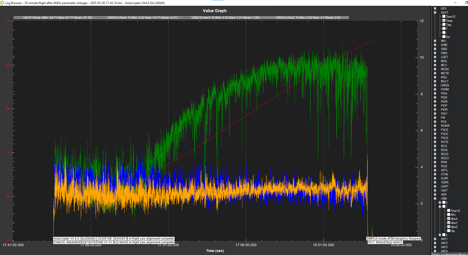

One more thing -
I reported earlier that X-axis vibes on IMU0 and IMU1 seem to increase - while IMU2 does not.
Maybe there’s something about the IMU isolation material on this Orange Cube that’s starting to deteriorate. @CraigElder has suggested just replacing it.
Hi @jstroup1986,
The IMU temp of 65 degrees is fine. There’s a BRD_HEAT_TARG parameter that can be used to configure this but 65 is an acceptable value.
I think AM32 ESCs should work fine and it looks like you’ve got it working now. Tridge demonstrated them at the Kaga developers conference and I have an aerial photography copter that uses them (although I haven’t flow it a lot yet). I use AM32 ESCs with DroneCAN though, not the BLHeli communication protocol. I must admit that I don’t know much about the AM32 settings yet.
No need to intentionally make the board so hot (by increasing BRD_HEAT_TARG), you just want to ensure that it still has a valid/compensated calibration when it does warm up. Probably best to leave BRD_HEAT_TARG at default, but perform IMU temperature calibration if you plan to fly above that value on a routine basis.
Boards with heated IMUs somewhat alleviate the need to perform a temp cal, but this is a case where it’s prudent to do it.
