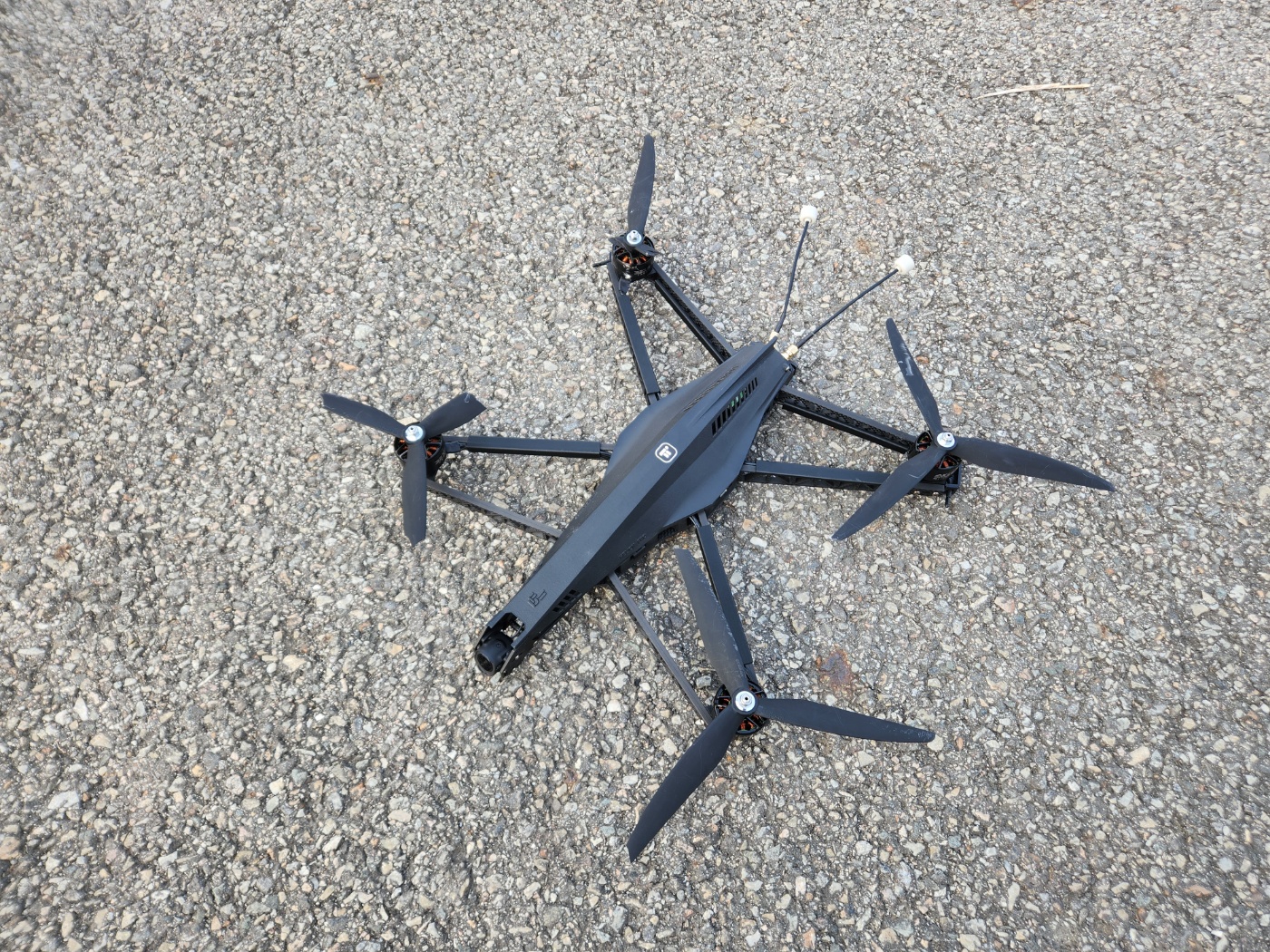

Today was the first flight of my copter, and it was the tuning phase.
Autotune was completed with AUTOTUNE_AXES Pitch / Roll / YAW on the first flight and YAW also set YAWD on the second flight to complete tuning.
Greedy for the third flight, raised AUTOTUNE_AGGR to 0.12 (wind about 8m/s)

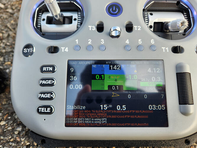

During the third Autotune, a photo-like message appeared and crashed.
Fortunately, the aircraft was not seriously damaged.
What happened to my drone?

Looks like watchdog issues per the messages on the controller.

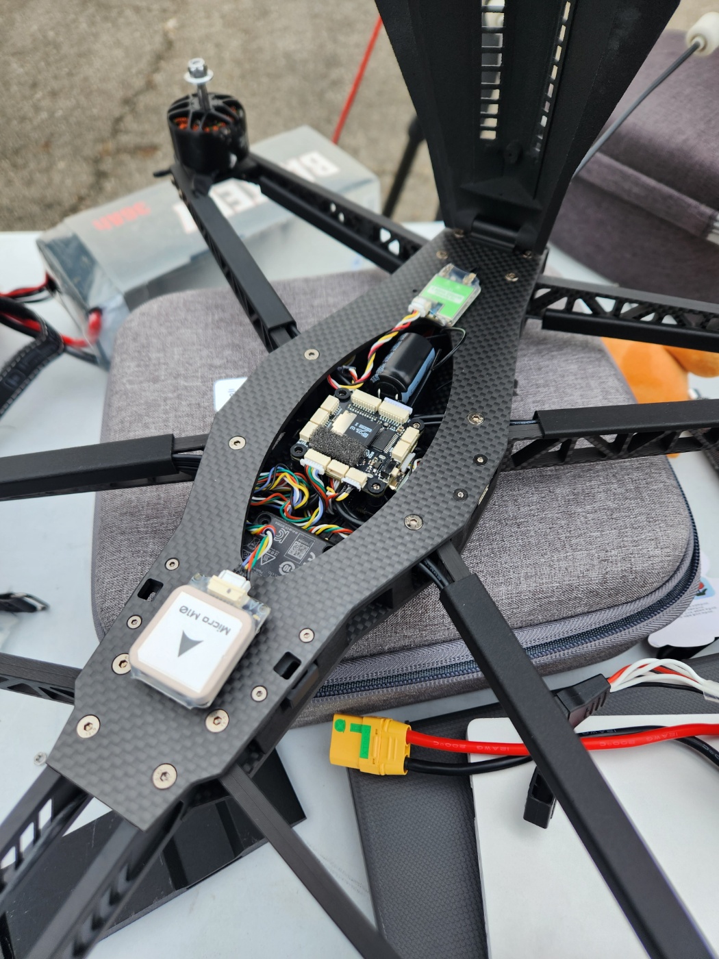

I looked at the Autotune2 log and the voltage and the current do make sense this time - HOWEVER logging stops mid-flight as if the flight controller lost power so maybe the copter crashed then.
Check your connections, and maybe even see if the regulator on the flight controller is overheating or something. Leave it connected for a couple of hours and see how hot it gets, or if the FC loses power.
