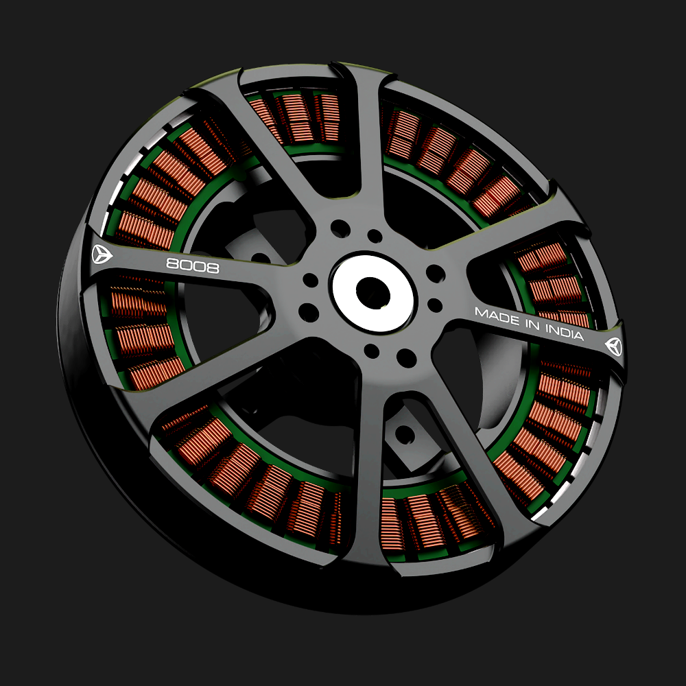

I am using 850mm x 850mm carbon fiber frame with 240kv 6s motors, 200amps mauch power module and Hobbywing 40amps Escs, 24 inch foldable prop with 33.6ah batteries connected in parallel. Was planned a mission after completion of 3 lines, in the mid-air it toppled and crashed. Can some one help me to find the root cause.

This seems like a potential clue as well. Customized how?
This is the one which we used 6s configuration with 24inch hobbywing propeller.

As I inspected the drone physically, there were no soldering issues, no ESCs and motors were burnt. After the crash I see the motor stator has been displaced. But it might happen after the crash. May I know any other possibilities for the crash.
