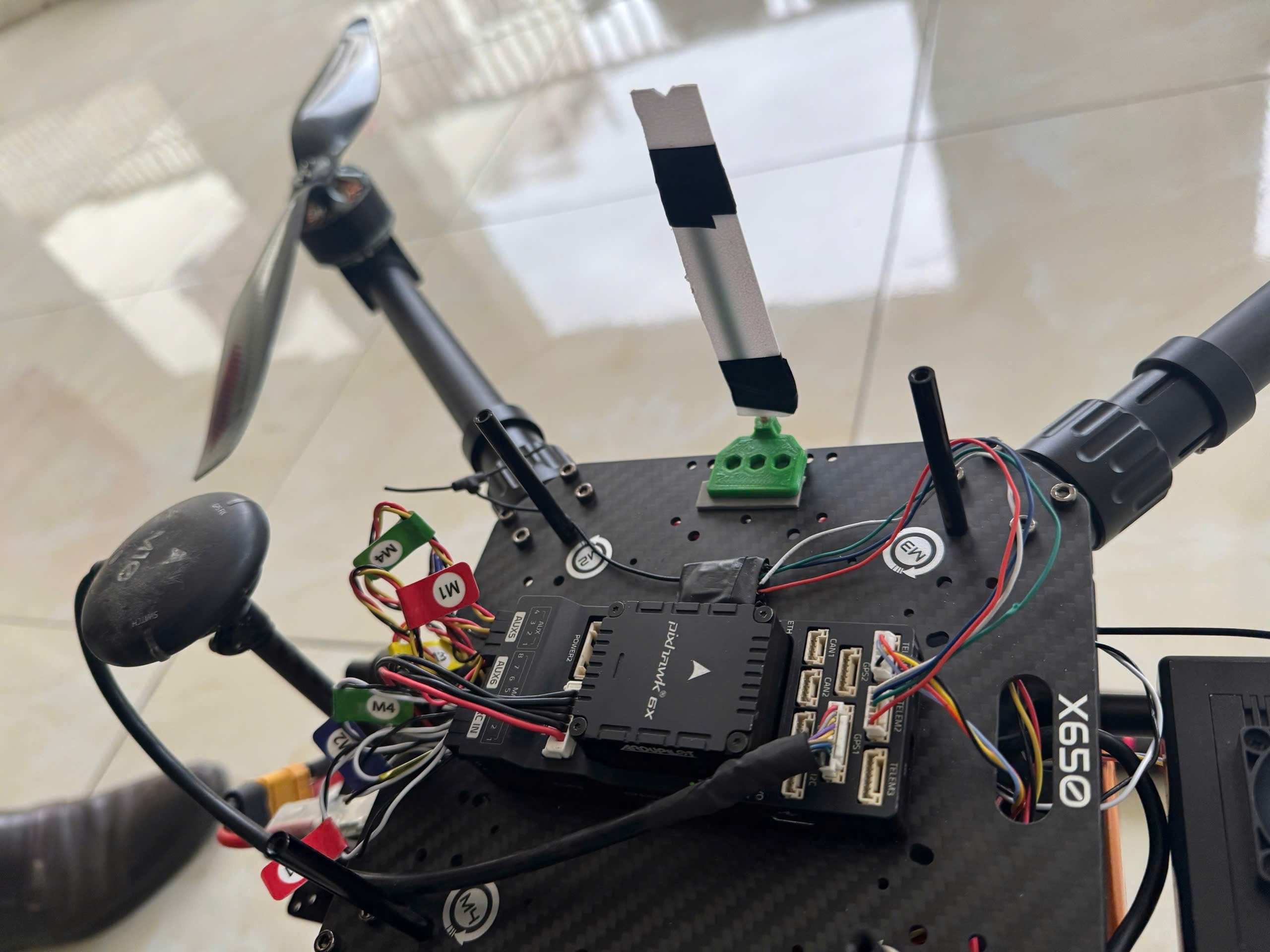

Hi, everyone.
I have bought Holybro X650 kit link here and tried to setup with FC Pixhawk 6x + battery 6s 10.000mah.

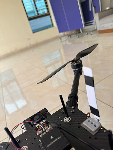

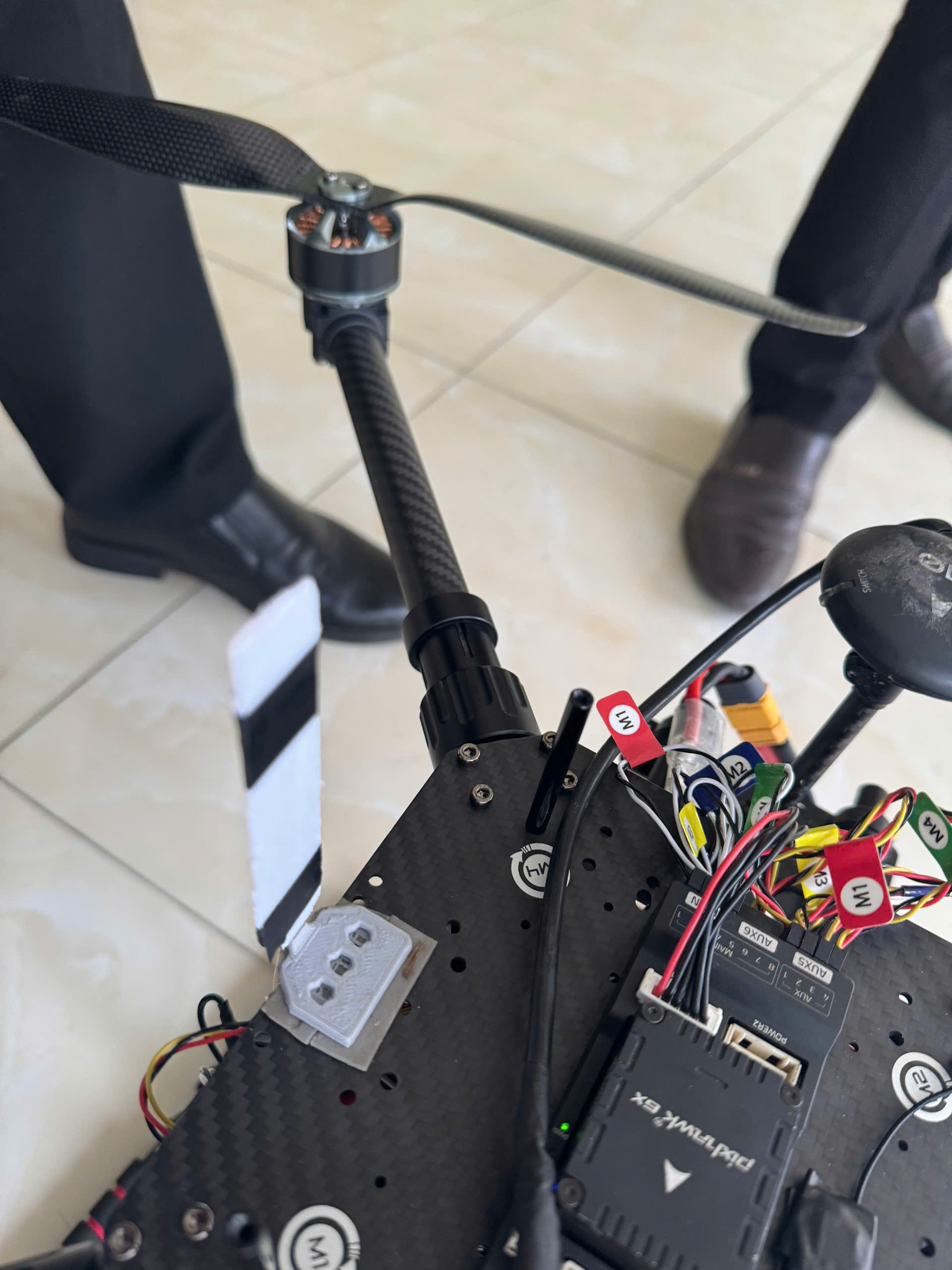

My problem is that my copter couldn’t lift off the ground (motors worked) even though throttle is controlled to the maximum.
I calibrated radio controller, Accelerometer, compass and ESC.
Help me please!!!
Props seem to be in correct direction

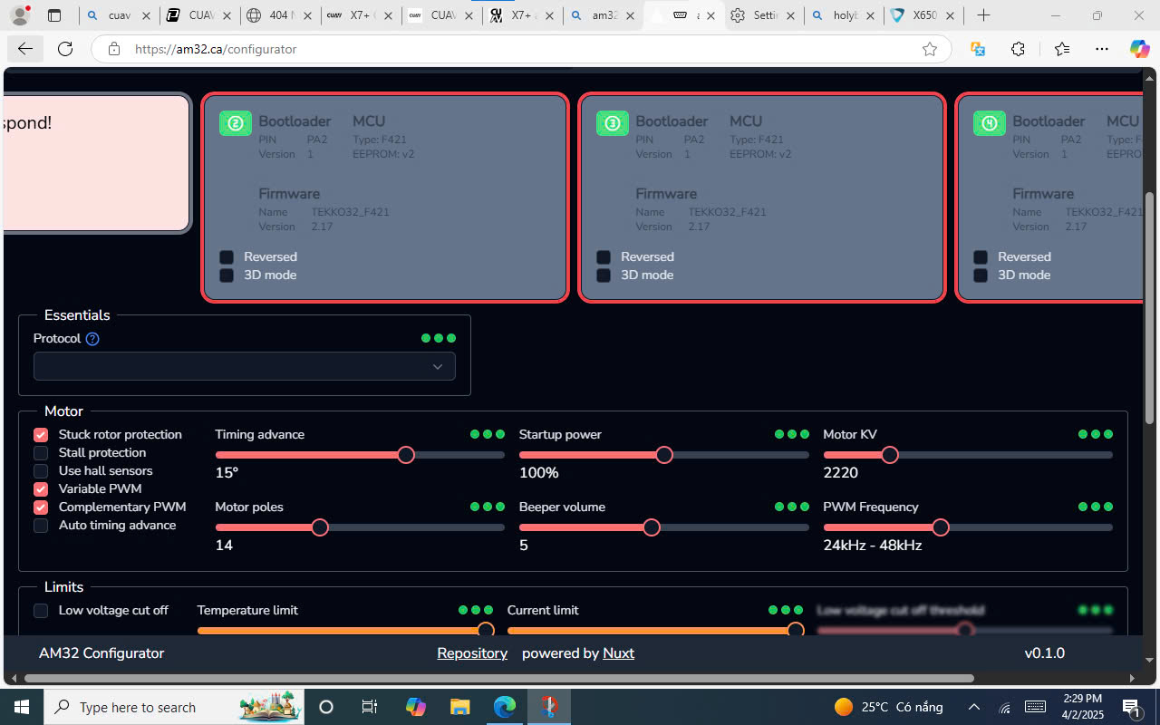

What version of AM32 firmware is loaded on the ESC’s?
Fully charge the battery as @amilcarlucas said.
Also screen shot your AM32 settings.

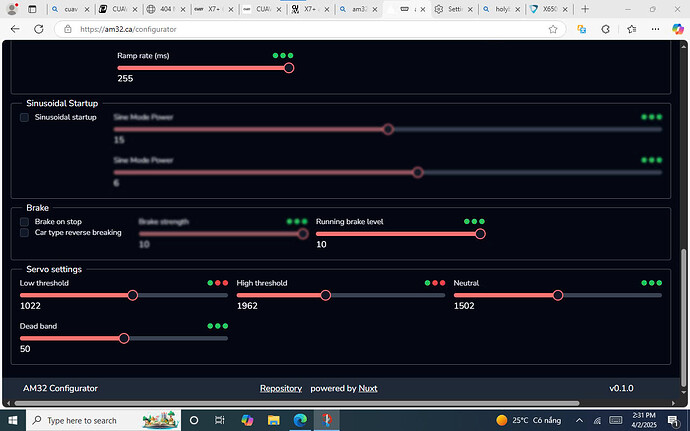

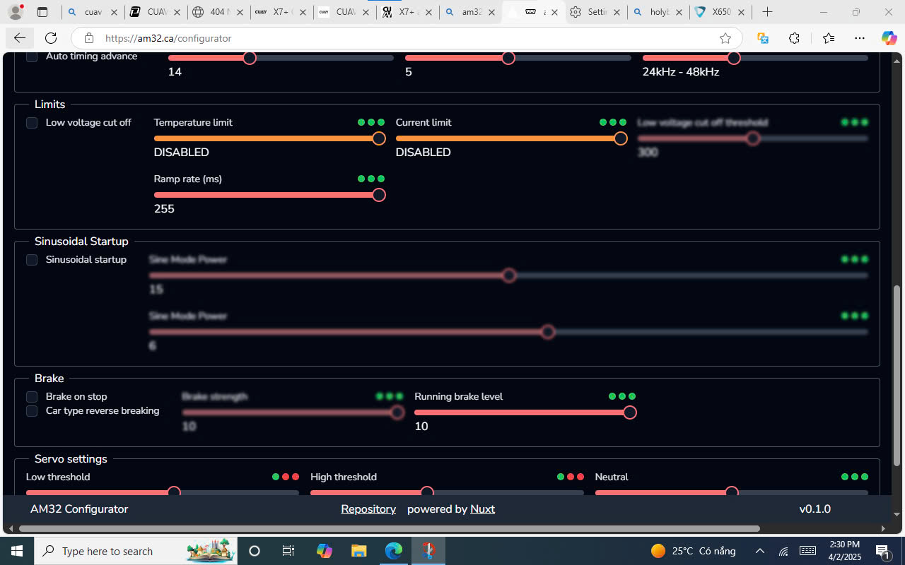

After changing to a different FC, I was able to access the AM32 settings. And here it is:
First try setting the correct Motor kV…
