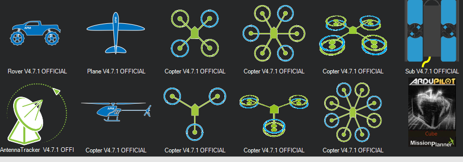

Has 4.7.1 been released?
Hi @Adam_Borowski,
Yes it started appearing late yesterday and it’s all built now. I’ll publish the announcement shortly!
We have so many autopilots now that the build time is really long and variable.
