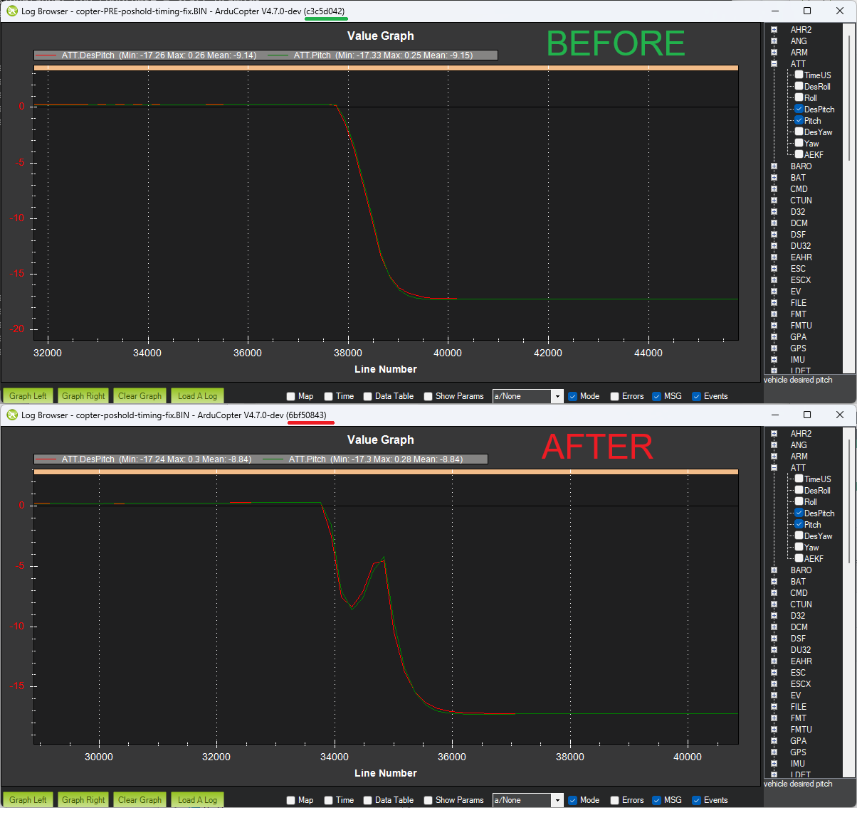

I tried today 4.7.0b7 and identified a strange behaviour in PosHold-Mode. When I push the stick in a position the copter first moves quickly into that direction but immediately levels itself and then starts finally to move into the desired direction. I moved back to firmware 4.6.3 with the same parameters and the behaviour is “normal”.

I push the stick slightly into forward direction, the drone starts to move forward. After 500ms it levels again (stops moving forward) shortly and then afterwards starts to move forward constantly.
This behaviour I do not have with the same parameters on 4.6.3

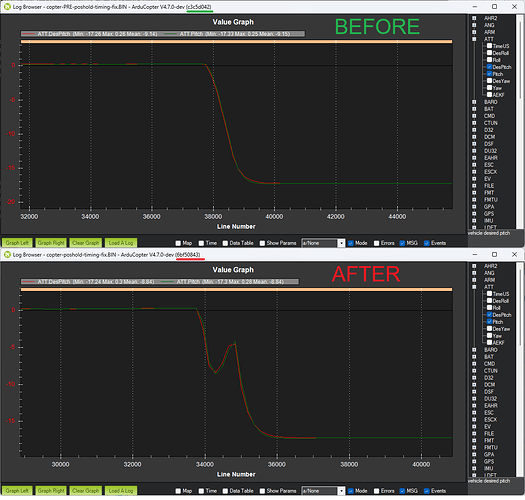

I have reproduced this behavior in SITL and opened a GitHub issue for it here:
Copter: PosHold desired attitude briefly reverses during sustained roll or pitch input · Issue #33588 · ArduPilot/ardupilot
It includes SITL reproduction steps, current master vs Copter-4.6.3 comparison plots, and logs.

OK, I’ve reproduced the issue in SITL and it appears that it was caused by this PR https://github.com/ArduPilot/ardupilot/pull/30358
I’ll talk to @Leonardthall and I’m sure we can get it resolved soon possibly using @zbr3550’s PR. Txs!
Thanks for narrowing the regression down to PR #30358. I’m happy to help with any further debugging or SITL testing, and to update my PR as needed.
