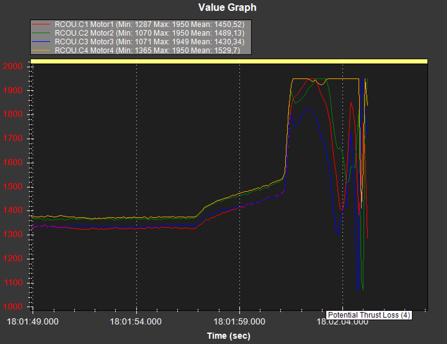

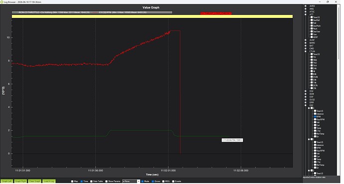

I did some testing today… and my quad crashed. During ascending motors just stopped, and felt from the sky. Logs a video will be available shortly.
Micoair H743v2 + Micoair 70A ESC.
Log: https://drive.google.com/file/d/1WVIKocqrSLXjxIJ4FBzs2vwr9ZULGQ5Q/view?usp=sharing
Video: https://www.youtube.com/watch?v=UFzTyciDJ44
No idea what is the reason - after motors went quiet I released throttle stick, so it returned into middle pos.
Test on desk after crash - all motors working fine, ESC seems to be working fine. Same battery pack as used in test flght.

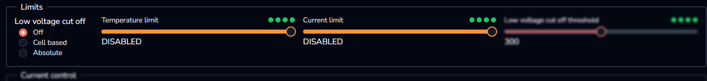

Checked - ESC teperature/voltage limits disabled.
Last tested with beta5 without any problems. This is a first time I see thrust loss in this one since 4.5.7
Not sure what FCN is in log, but looking at graph seems to be related to motors output.
Not sure why it goes to NaN value (not a number) mid flight.

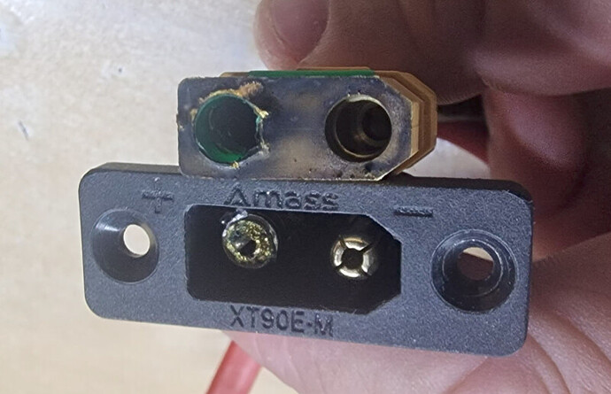

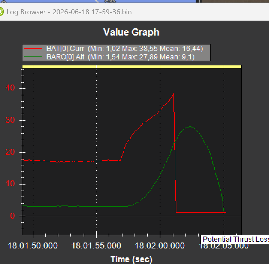

Look at the current (BAT[0].Curr)—it suddenly drops off, then goes down. Could a cable have come loose or a connector have burned out?

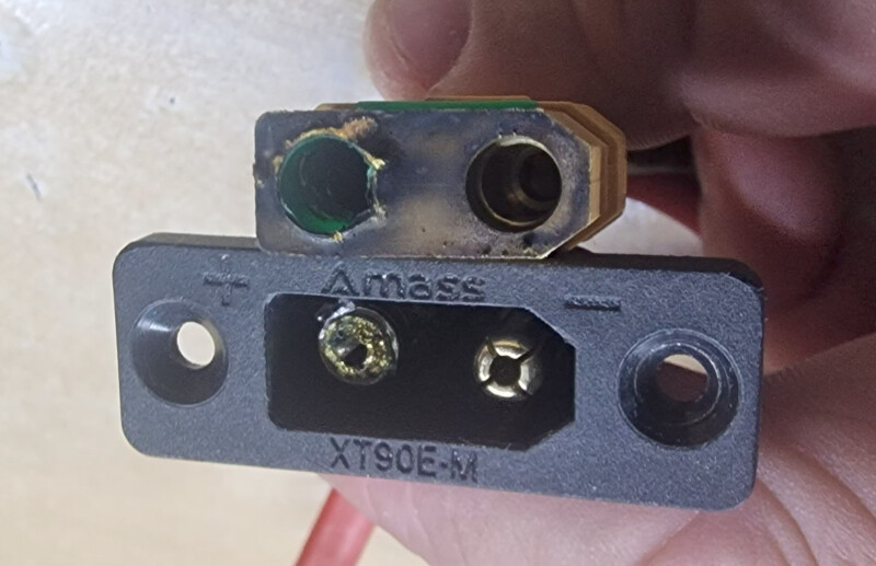

Current drops because all motors went off (just like that). Connector ix XT90 with anitspark. Also no signs of damage.
But according to the log file, the motors continued to be driven by Arducopter.

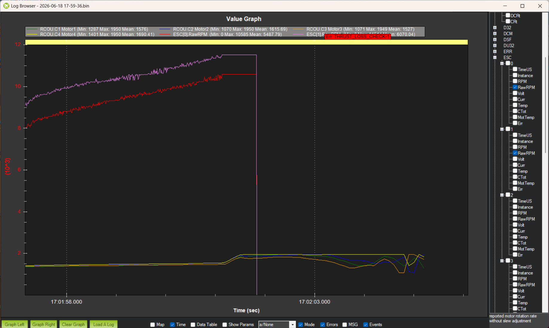

Seems so, but they went just dead silent. I suppose this is expected reaction of ardupilot trying to keep altitude as hard as it can. Too bad this ESC has not serial port telemetry.
I wonder what is ESC[n].Err as that spiked up all at once on all channels when motors stopped.
bdshot issue? esc - fc communication break down?
The throttle signal was still at 1500 when the RPM went to zero.
I have no experience with quads, but I’m wondering if your punch-out at the end exceeded some threshold on your ESC (e.g., got too hot)?
Yes. It was in loiter, so 1500 was when I released stick to mid position after motors went silent. Throttle channel in loiter is not directly translated to motors output. AP keeps some limits of velocity and acceleration too, so this was barely 10m/s ascending. I tested it way harder before (with 4.6.3) up to 25m/s vertical ascending and over 70A current which is still in specs of ESC (theoretically 4x70A), so 70A total is just 25% load, and 40A reached in this test is just around 15% max of ESC capabilities.

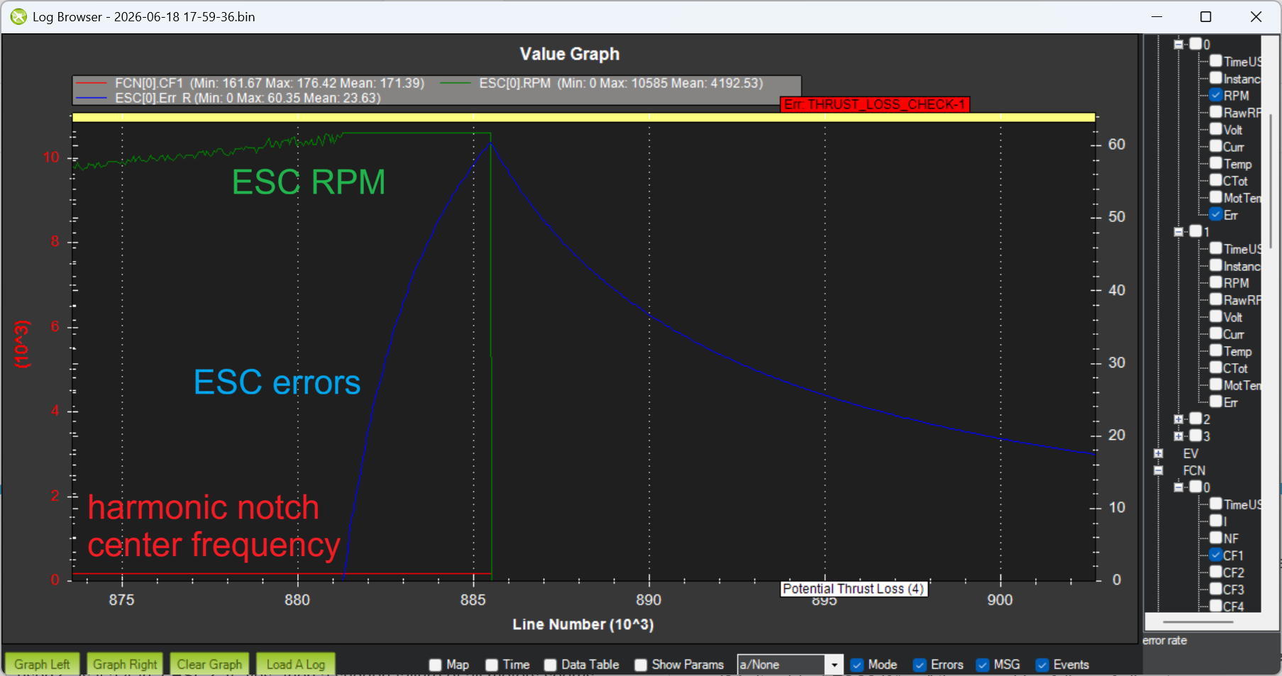

Hi @Adam_Borowski,

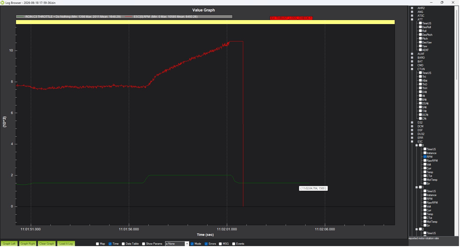

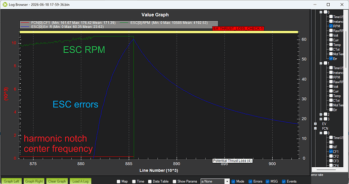

Thanks again for the report. I had a bit of a look at the log (not complete yet) and it looks like the vehicle is using:
  • BLHeli / Dshot 300 with ESC telemetry arriving on Serial7
  • Harmonic notch is setup to use ESC telemetry
The ESC log message has errors telling us that the ESC telemetry stopped arriving from the ESCs. This in turn leads to the FCN log message displaying NaNs because the harmonic notch feature no longer had a reference for where to filter.
You said you haven’t seen this since 4.5.7 so I guess you have seen this before? If you have any additional background on that, that would be great.
I think an ESC failure is probably the most likely cause but we’d like to be sure especially at this critical phase of the 4.7 release. Can I ask which ESCs are being used? Is it a 4-in-1 ESC? If “yes” then a sudden failure of all motors seems possible. If they’re independent ESCs then that’s less likely
You can see that the ESCs stop receiving RPM data at the same point as the throttle increases -
On that board PWM1/2 and 3/4 are on different timers so unlikely to be DMA issue.

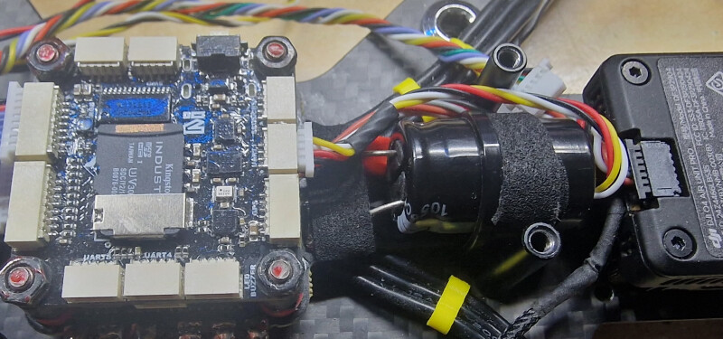

Worth checking the cap you are using is oversized - I know this can be a problem
That was on a small side (only 470uF - I belive that was value that came with stack) from unknown brand changed to nichicon. This time I put 2200uF for Panasonic :slight_smile: Should be plenty :slight_smile:
Pro TIP: Always make sure new ESC has + and - in same orientation as the old one… Somehow everything survived. Nothing better that adrenaline spike at the end of rebuild when You try to pull apart connectors that decided to weld themself. :slight_smile: At lease I know my welds on 21700 pack are done well :slight_smile:

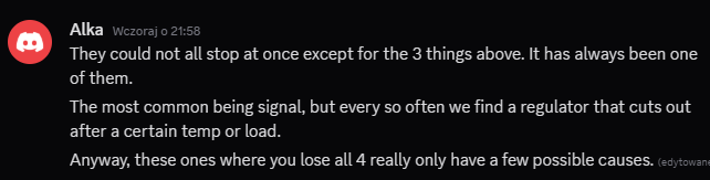

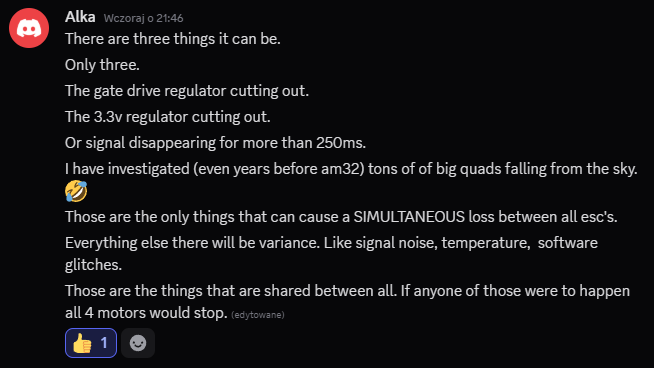

BTW - I had a little chat with alkamotors dev about this.
