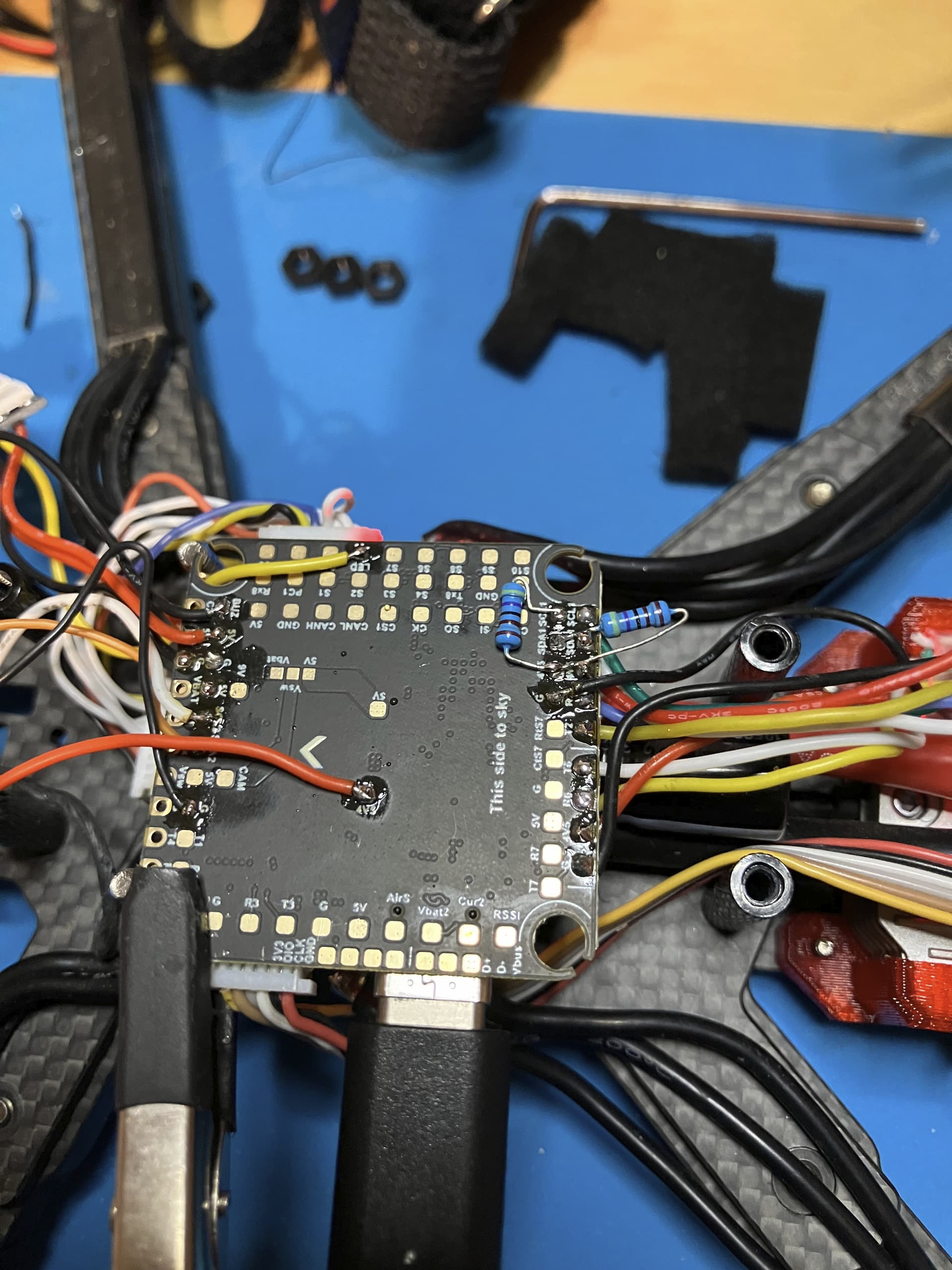

There are apparently no pull-ups on I2C1 - I suspect this could be the cause.

This is because there are no pull-ups on the I2C bus. If you add a 4k7 resistor between 5v (or 4v5 depending on how you have your device powered) then it will work. I jerry-rigged something for my compass:

We’ll see - I just put it on my Chimera. There is a software fix for the pullups in hwdef you can try - AP_HAL_ChibiOS: add pullups to I2C bus on TBS LUCID H7 by andyp1per · Pull Request #29674 · ArduPilot/ardupilot · GitHub
