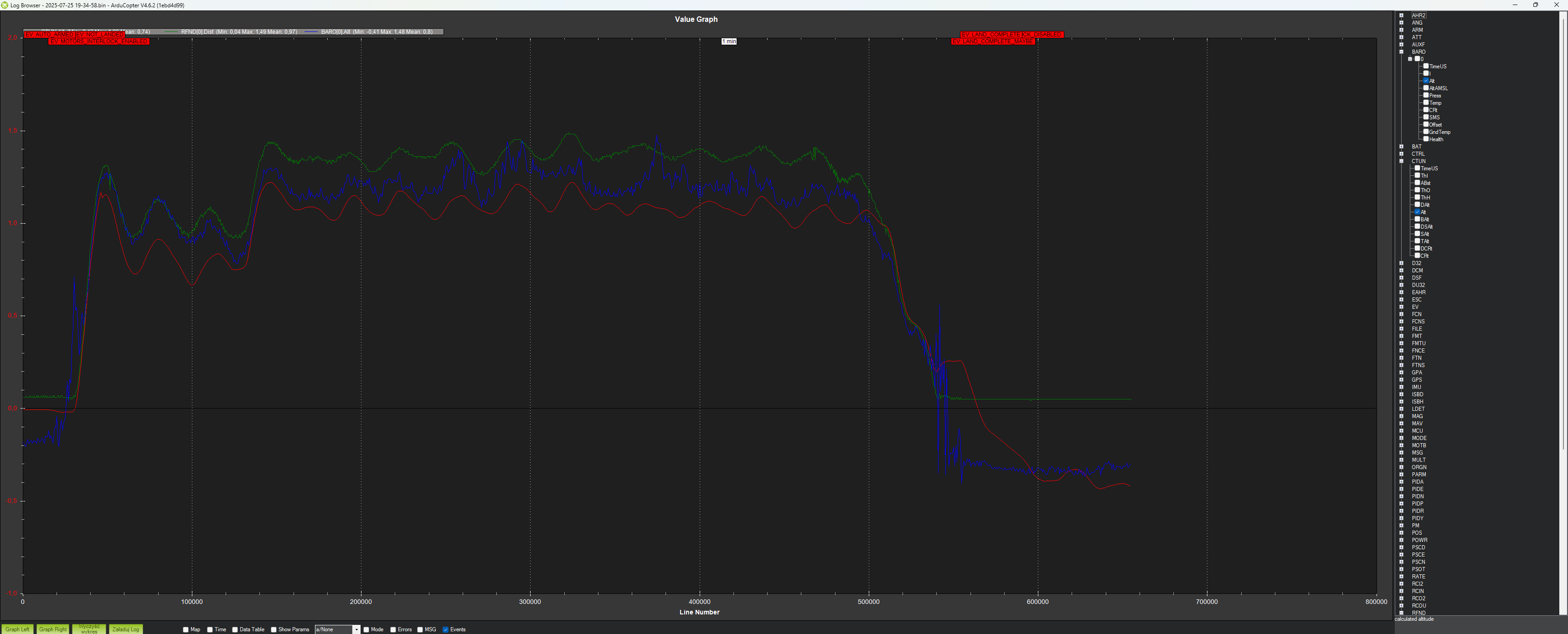

Were there any significant changes in altitude controll?
I noticed that after switching from 4.5.7 to 4.6 (not sure which one exactly 4.6.x) I have some slow vertical oscillations that were not present with 4.5.7. (data from 4.6.2).
Hi @Adam_Borowski,
Thanks for the report.
I’m not aware of any changes in the altitude controller. I guess I’d recommend trying two things:
  1. try turning off surface tracking (SURFTRAK_MODE = 0)
  2. to back-to-back tests with 4.5.7 and 4.6.2 to confirm the issue really is software related and not environmental
