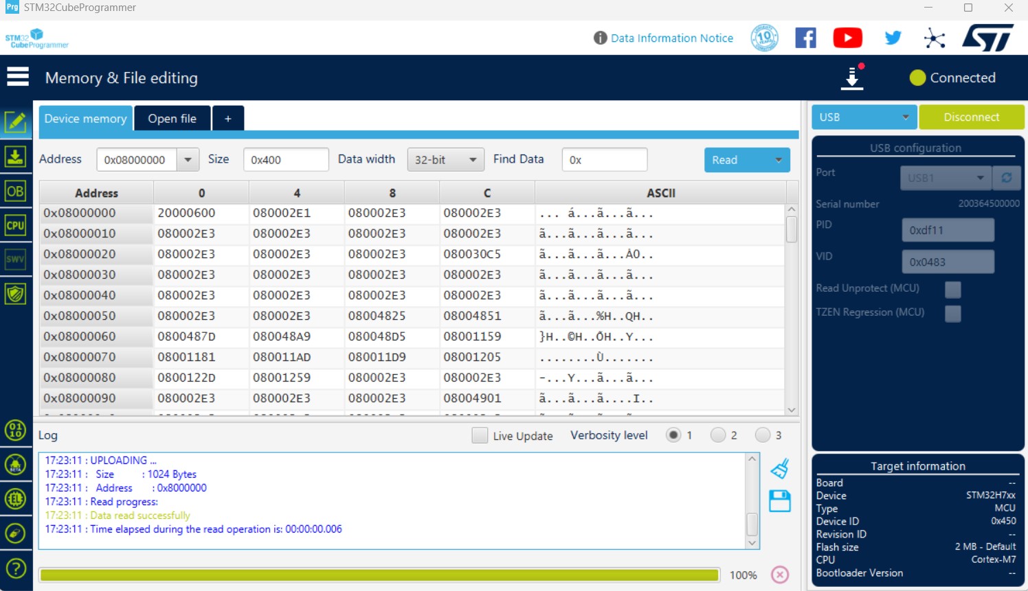

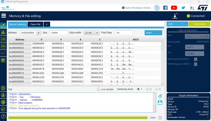

@dkemxr - Took your advice. I do see “DFU in FS Mode” under USB Serial Devices (screenshot below)in Device Manager. The board was recognized, screenshot below.
FCinDFU mode
rd.
After flashing, with full chip erase, the same behaviour is observed. Upon connecting the FC to the PC, Device manager shows USB Serial Device (COM10) under Ports(COM&LPT) in Device Manager. AP does not recognize the board. Maybe we are onto something :slight_smile:

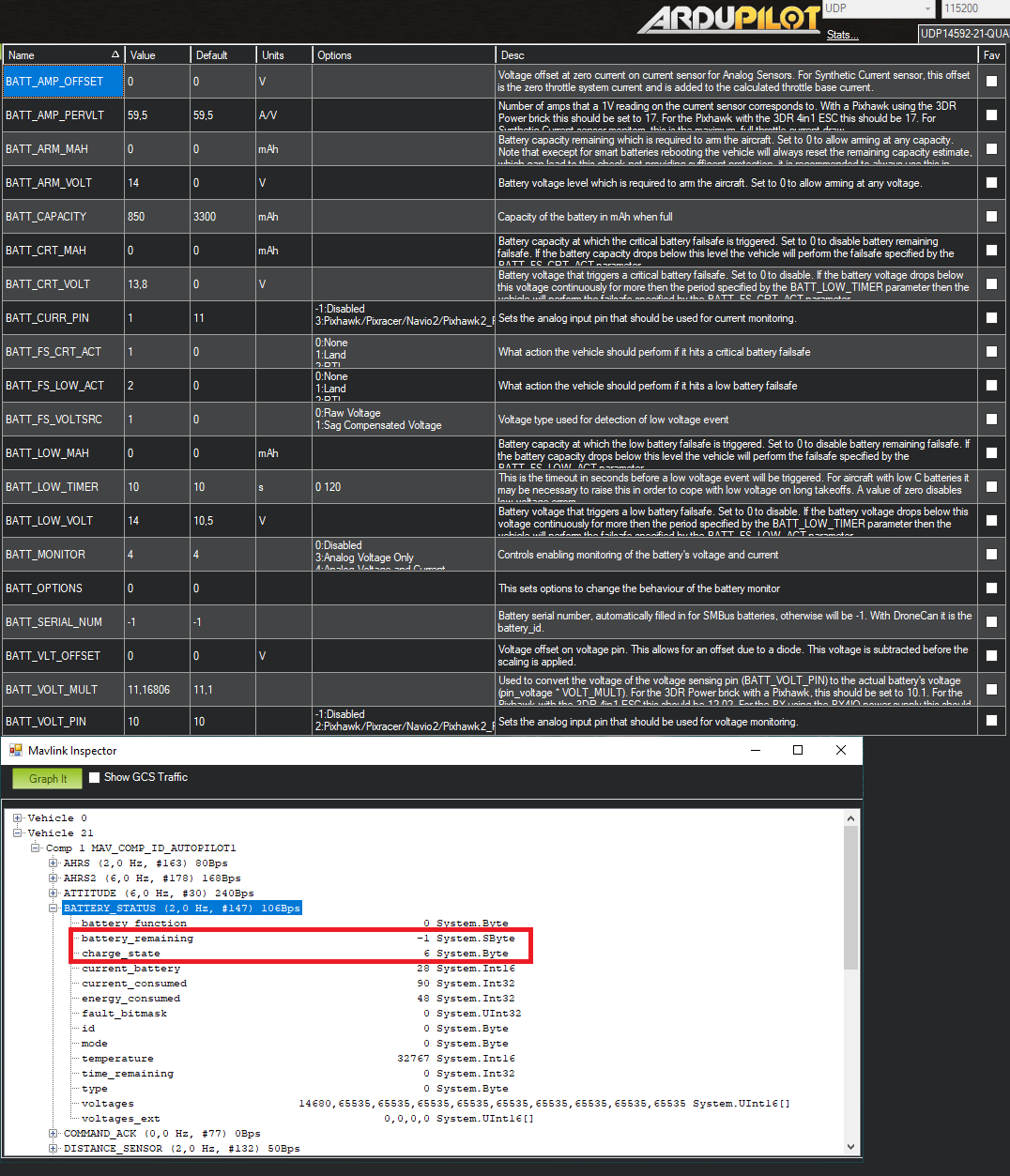

Hi.
Copter 4.6.0 stable.
With Copter landed, connected to MP, disarmed, showing battery voltage (4S) 14.7V and current 0.4A (5.5A flying), message “Bad battery” is heard every 10s. In MavLink Inspector BATTERY_STATUS:
battery_remaining -1
charge_state: 6
which indicates some kind of confusion.
Changing bits in ARMING_CHECK message “Battery unhealthy” is heard instead.
Main battery parameters:
BATT_MONITOR, 4
(Voltage and current battery pins are assigned and show correct measures)
BATT_CAPACITY, 850
BATT_LOW_VOLT, 14
BATT_CRT_VOLT, 13.8
BATT_FS_VOLTSRC, 1
BATT_FS_CRT_ACT,1
BATT_FS_LOW_ACT,2
BATT_ARM_VOLT,14
MOT_BAT_VOLT_MAX,16.8
MOT_BAT_VOLT_MIN,13.2

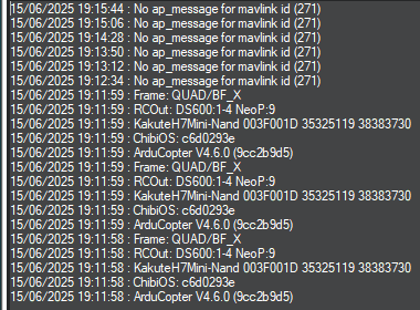

In adition, there appear a few “No ap_message for mavlink id (271)” after boot:
Hi @Webillo,
Thanks very much for the report. I’ve added this to the 4.6 issues list.
We have a fix coming in 4.6.2 which will remove the annoying “No ap_message for mavlink id” message.

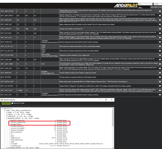

0.4A seems like a lot for small quad.

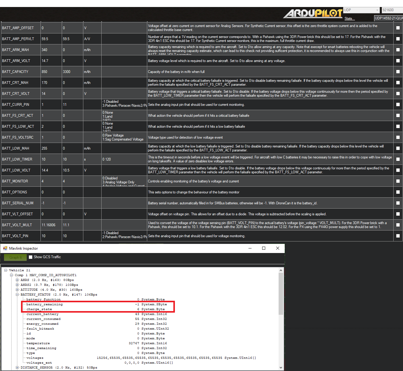

These are the correct voltage settings for 4S Lipo:
BATT_ARM_VOLT,14.70
BATT_CRT_VOLT,14.00
BATT_LOW_VOLT,14.40
Set BATT_CAPACITY,0 to see if the problem goes away. You may not need the capacity settings at all. These are the capacity settings for your battery capacity of 850mAhr:
BATT_ARM_MAH,340
BATT_LOW_MAH,255
BATT_CRT_MAH,170
Good. These are other confusing messages on the Messages MP DATA tab:
16/06/2025 13:01:48 : No ap_message for mavlink id (271)
16/06/2025 13:01:34 : Arm: Battery failsafe
16/06/2025 13:01:21 : PreArm: Battery failsafe
16/06/2025 13:01:10 : No ap_message for mavlink id (271)
16/06/2025 13:01:07 : Arm: Battery failsafe
16/06/2025 13:00:50 : PreArm: Battery failsafe
16/06/2025 13:00:42 : Arm: Battery failsafe
16/06/2025 13:00:32 : No ap_message for mavlink id (271)
16/06/2025 13:00:26 : Arm: Battery failsafe
16/06/2025 13:00:19 : PreArm: Battery failsafe
16/06/2025 13:00:06 : Arm: Battery failsafe
16/06/2025 12:59:54 : No ap_message for mavlink id (271)
16/06/2025 12:59:48 : PreArm: Battery failsafe

No change: same “Bad battery” every 10s:
No change. I had also tried exagerated high values without success.
