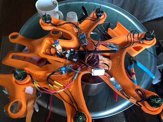

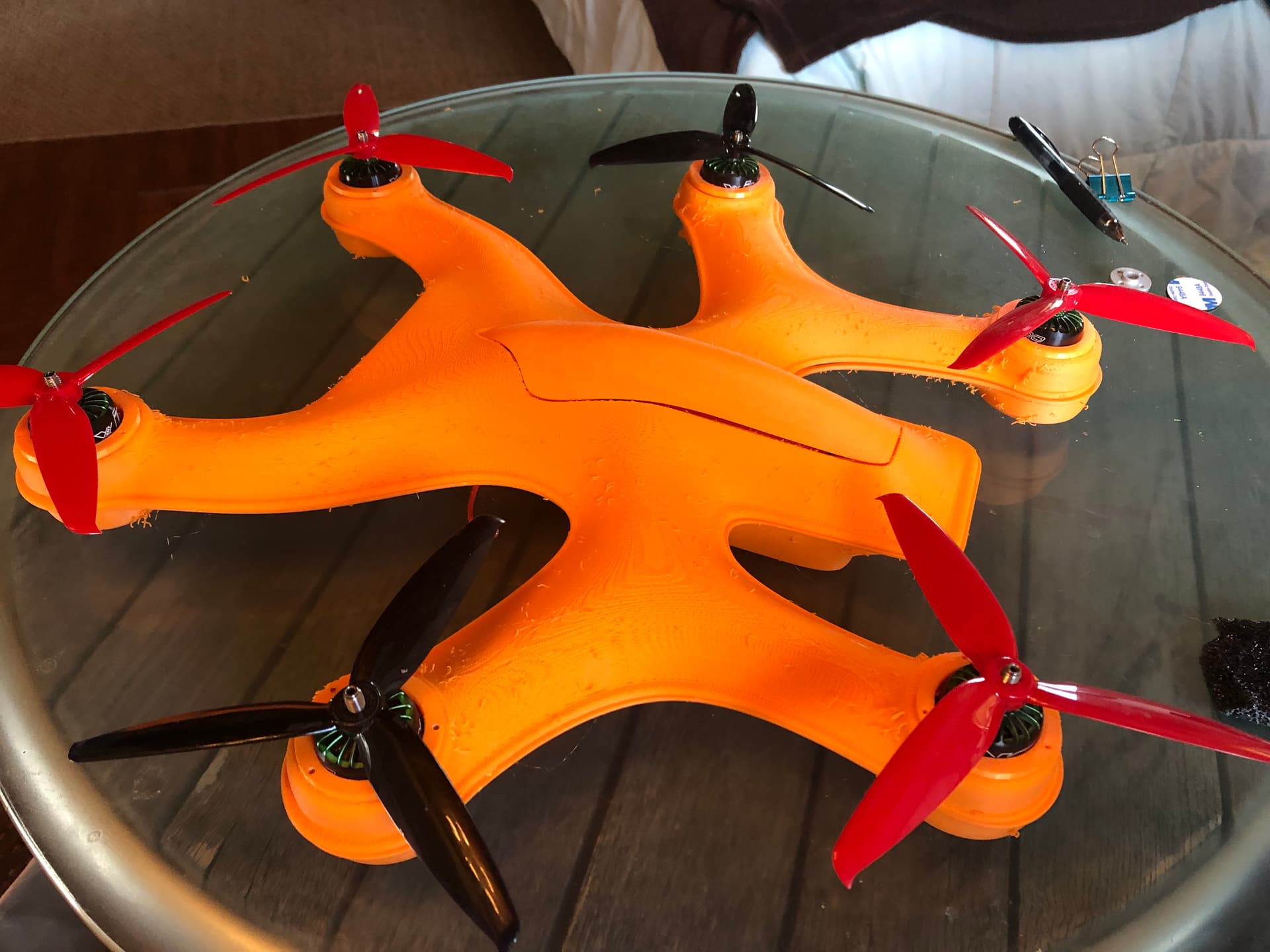

New build using Hexa.
Swapped one of my quad builds to this new frame.
Seems good overall
3/20/2025 6:32:48 PM : GPS 1: u-blox saving config
3/20/2025 6:32:26 PM : u-blox 1 HW: 00080000 SW: ROM CORE 3.01 (107888)
3/20/2025 6:32:16 PM : Frame: HEXA/X
3/20/2025 6:32:16 PM : IMU2: fast sampling enabled 9.0kHz/2.3kHz
3/20/2025 6:32:16 PM : IMU1: fast sampling enabled 8.0kHz/2.0kHz
3/20/2025 6:32:15 PM : RCOut: DS600:1-6 PWM:7-8
3/20/2025 6:32:15 PM : mRoPixracerPro 00360044 30305109 37393435
3/20/2025 6:32:15 PM : ChibiOS: 88b84600
3/20/2025 6:32:15 PM : ArduCopter V4.6.0-beta4 (dbb9b75f)
PID seems compatible from Quad to Hex x so no changes yet.
Enjoy.
