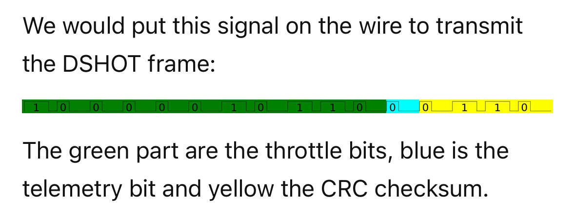

Good question. FETtec one wire does have a rudimentary checksum that AFAIK DShot does not have, but I might be wrong here.

DSHOT also has a checksum for it’s data, but there would be quite a change of wiring to connect up the ESC to do DSHOT. It would be interesting to see if the same problem existed.

Dshot does have checksum.
