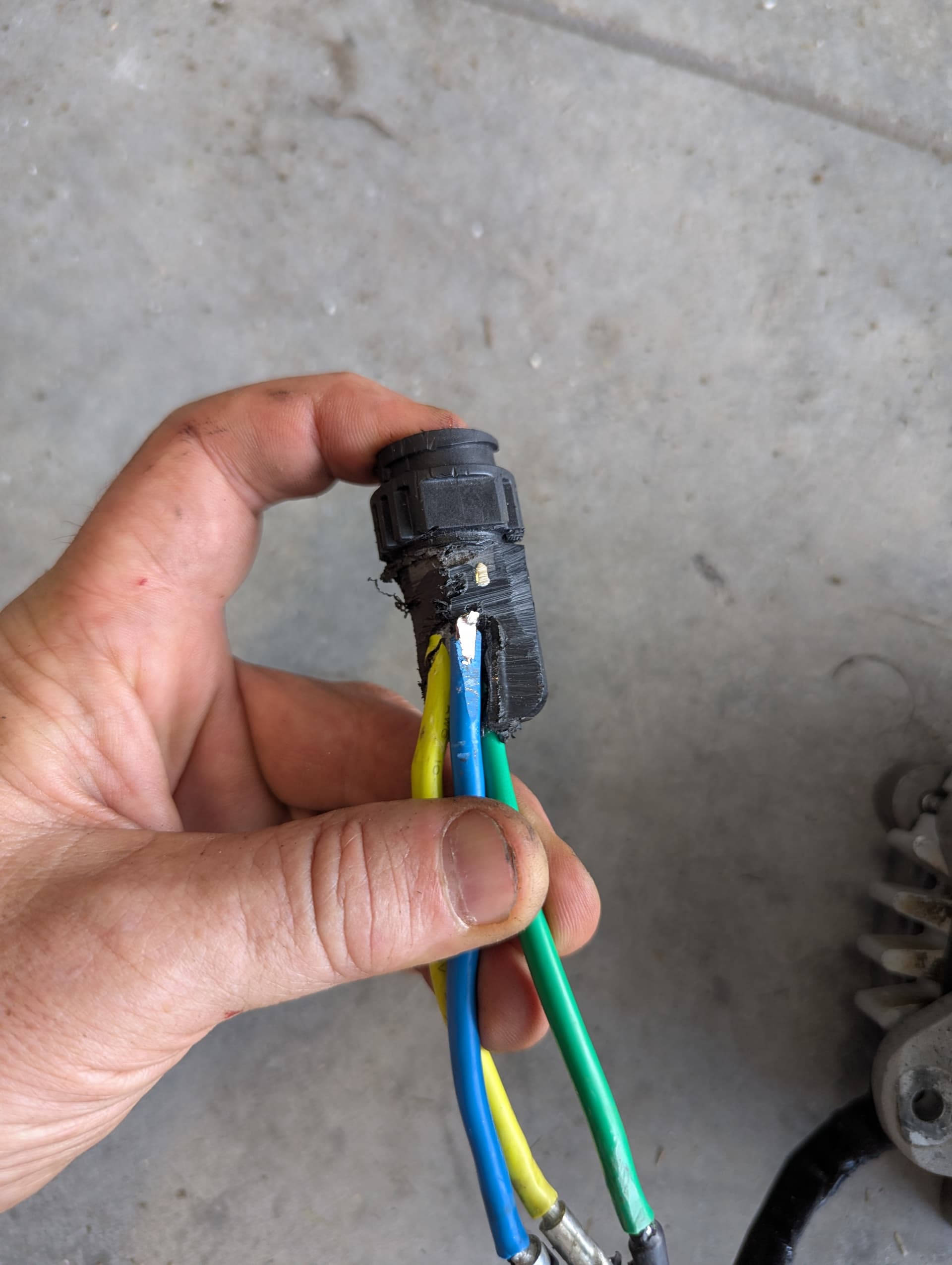

I had an interesting experience with the Ryobi yesterday. I converted it to Lifepo4 and was using it to cut the grass in manual mode. After a while of cutting I noticed the blades wouldn’t stay running; they’d just start and stop a couple seconds later.
Batteries dead already? No, voltmeter says 53 volts.
I’ll spare you the long sorted troubleshooting details mainly because I’m too lazy to type them but the issue ended up being one of the motor phase wires developed a bad connection inside the molded connector! Very surprising. I was able to cut it open with a bandsaw and resolder it. It’s back to working fine again.
