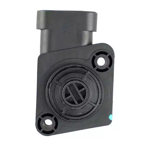

I am assuming the control arms on the mower uses a form of rotary encoder. Is there a PWM interface/module to connect to main out of the pixhwawk board to the encoder pot/switch plug? Have seen other zero turn mower conversions where a high torque server is attached to the actual control arm.
Just starting and hoping to expand this thread with progress…
There is not likely a direct interface to that hardware. If you could reverse engineer the signal, it may be possible to create such an animal.
Thanks,
Looks like this it the part used 996499001 - SWITCH SPEED CONTROL (HOMELITE ORIGINAL OEM) Might see about buying two, and 3d print a bracket to attache a servo to the switch. Or, a bracket and replace the damper with linkage to a servo. Still have to buy the mower first. :crossed_fingers:

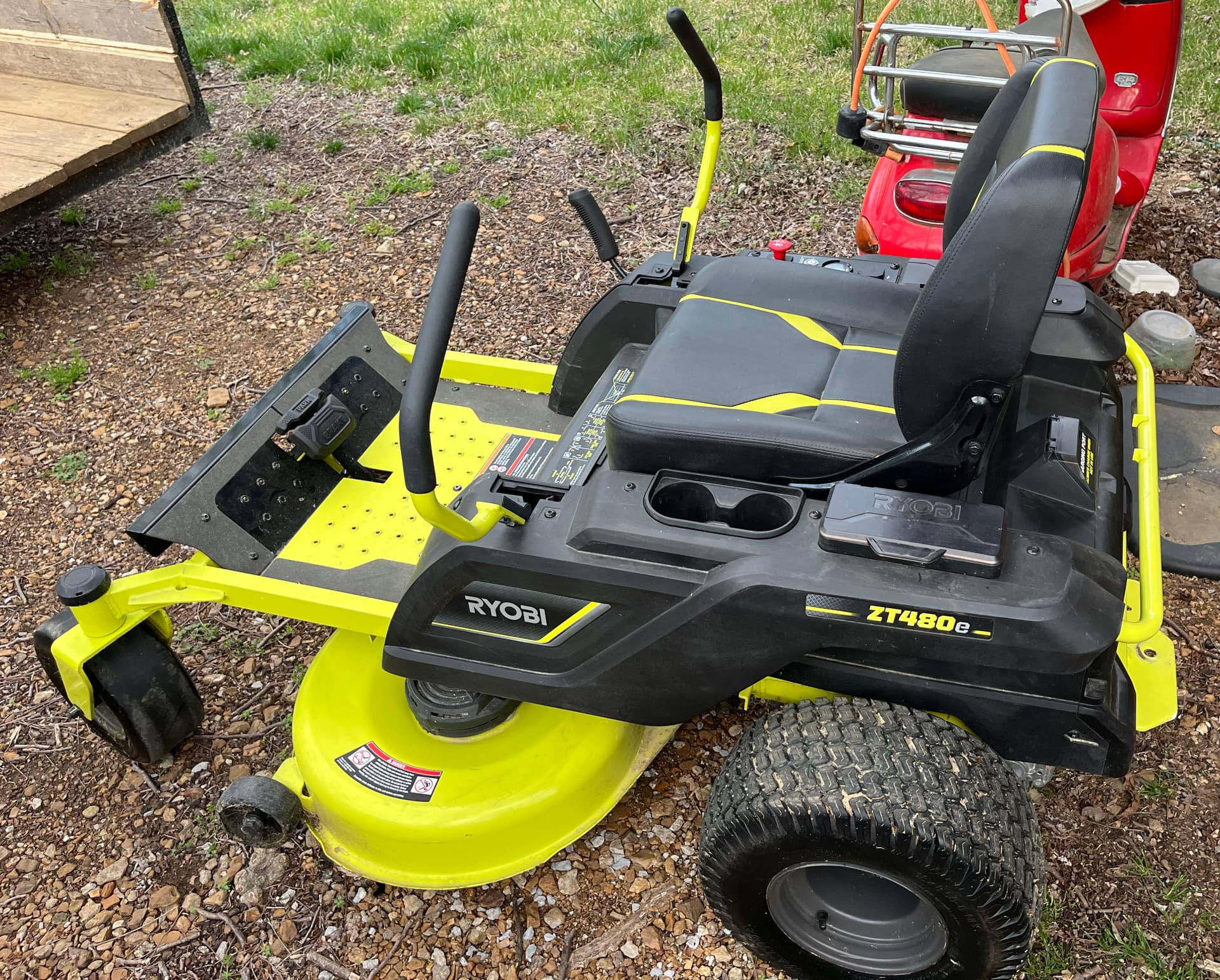

Here is the mower, Got it for $400. It has two storage boxes, same on both sides. Thinking of making an adaptor to fit into them to mount servos to drive the control arms. Want to do the make it where I can drive it and it dives itself also.
Just got is and still figuring what to do…
You could try and how the control arms function then try and duplicate that signal with a switch to swap between the control arms and electric control.
Looks like the control arms are using a throttle position sensor. Looking into maybe using a digital potentiometer to control. Still researching.
