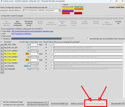

Post the .zip file that you get when you press the respective button at the bottom of the AMC interface.

We really need to see an onboard log. As we say, it’s all guesswork without a log
Jus press the button and post the .zip file here:
And post a .bin file as well so that we can help you.

I am still getting the “Bad Battery” message appearing in mission planner and OSD when attempting to arm. On a second arm attempt it will actually arm despite the message. Attaching the zip file.
I’m also attaching what I think was one of the flights with the pids produced by the process (unfortunately a lot of test flights, not careful tracking, and having to roll back the pids). The final tune had some bounciness in my pitch and roll. I noticed a very minor wobble for a couple of seconds after performing exaggerated movements. I’m assuming I need to go back and maybe change the notch filter settings and lower the PID rates, because there may have been to much oscillation/vibration from where I started with the rates that possibly propogated forward throughout the process.
I’m more interested in figuring out the “Bad Battery” message as I can always retune and better understand the process. Thank you.
AMC ZIP
BIN FILE
