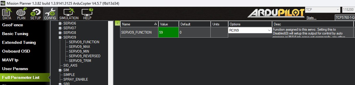

I’ve watched ever video I can find and can not figure this out. No vide has my setup. I have the following hardware
Taranus X7
XR8 receiver
Pixhawk 4
sbus connection
Taranus X7 has switch SC 09 set up and I can see it in mission planner when I throw the switch.
I want to put my servo on Aux 01 and power the rail with a BEC, no problem!
I for the life of me can’t find where I set this up in mission planner so when I hit SC switch the servo moves.
Can someone take mercy on me and tell me how this is done.
SERVO9_FUNCTION,59
Meaning Aux 1 (servo 9 output) will be controlled by RC chan 9 input. I assume that’s what you mean by SC 09.

Got it!!! Thank you!!!
Got it thank you!!!
You can configure it here too.
The one thing that still confuses me is that I don’t understand how it knew I had the servo in Aux1, what happens when I add a second servo in aux 2?
And thank you again.
It didn’t know, I put it there as an example. Those fields are pull down menus.
