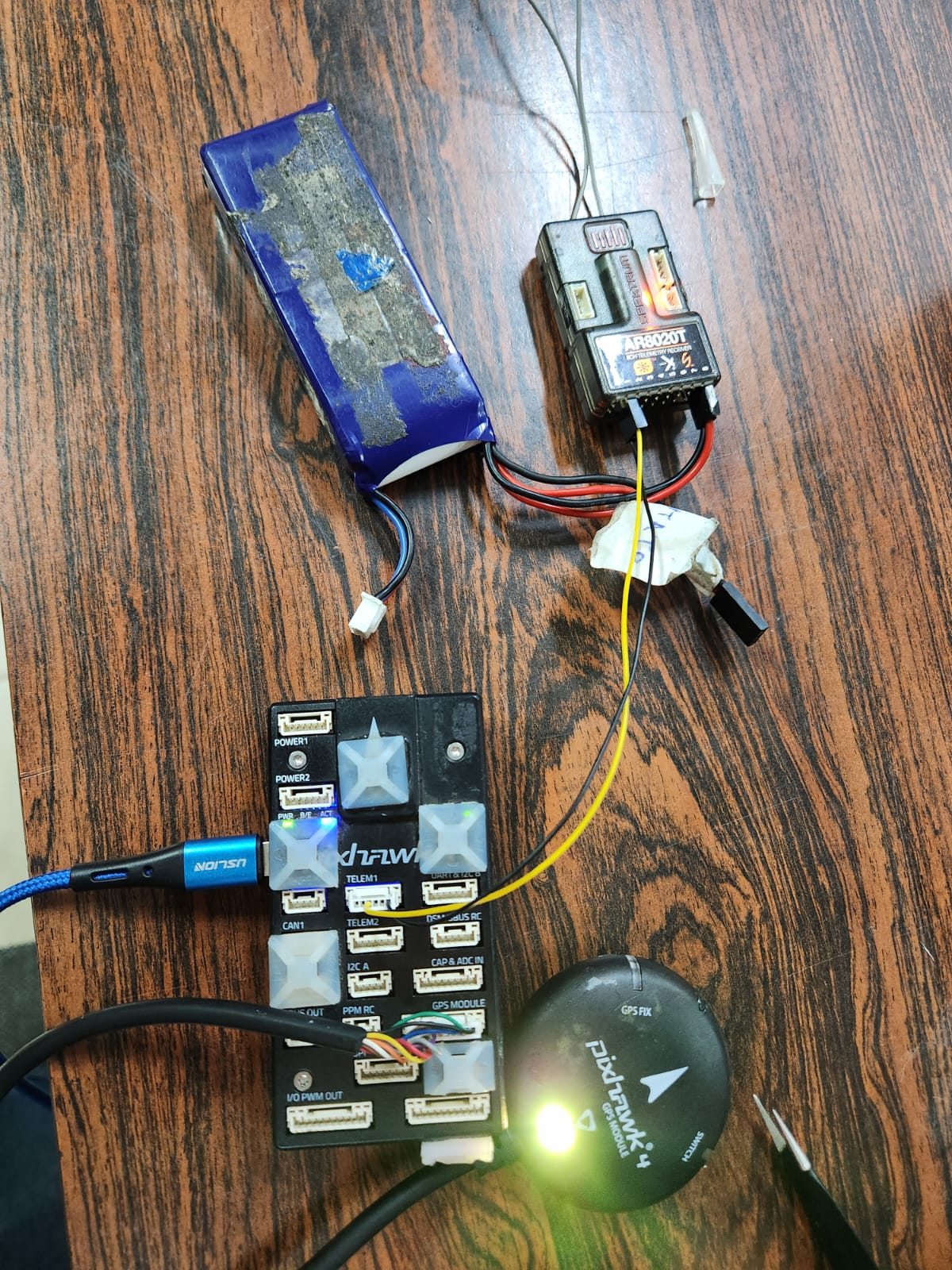

I want to connect the AR8020T receiver to a Pixhawk 4. I’m following the instructions given in the wiki.
This is my setup. Since I’m powering the receiver with an external battery, I’m not using the VCC wire. I’m plugging the SRXL2 wires to TELEM1. I also changed the parameters to the ones the wiki recommended (I’m attaching the parameter file).
I’ve seen other user saying they used the port 1 in the receiver instead of the one pointed as the SRXL2 port and tried this, but it didn’t work either.
