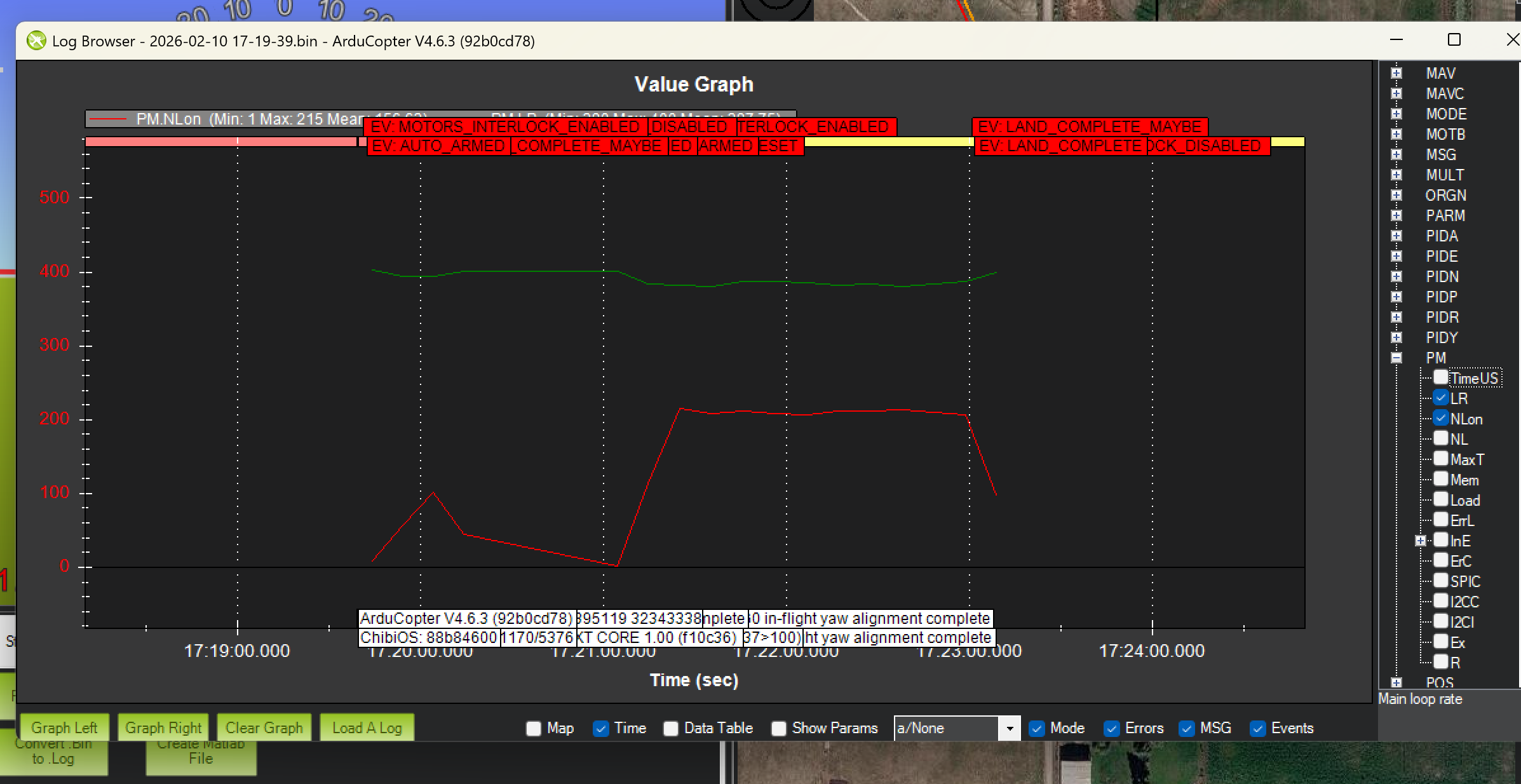

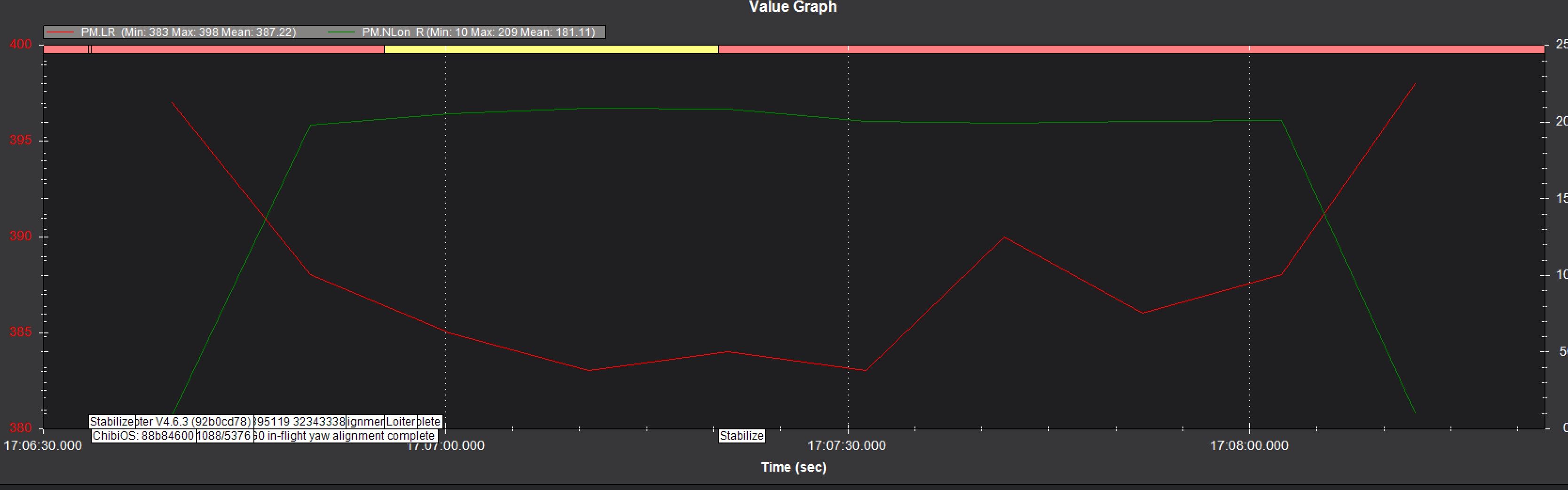

The loop rate is not stable because the processor is overloaded. See for yourself by graphing the PM messages.

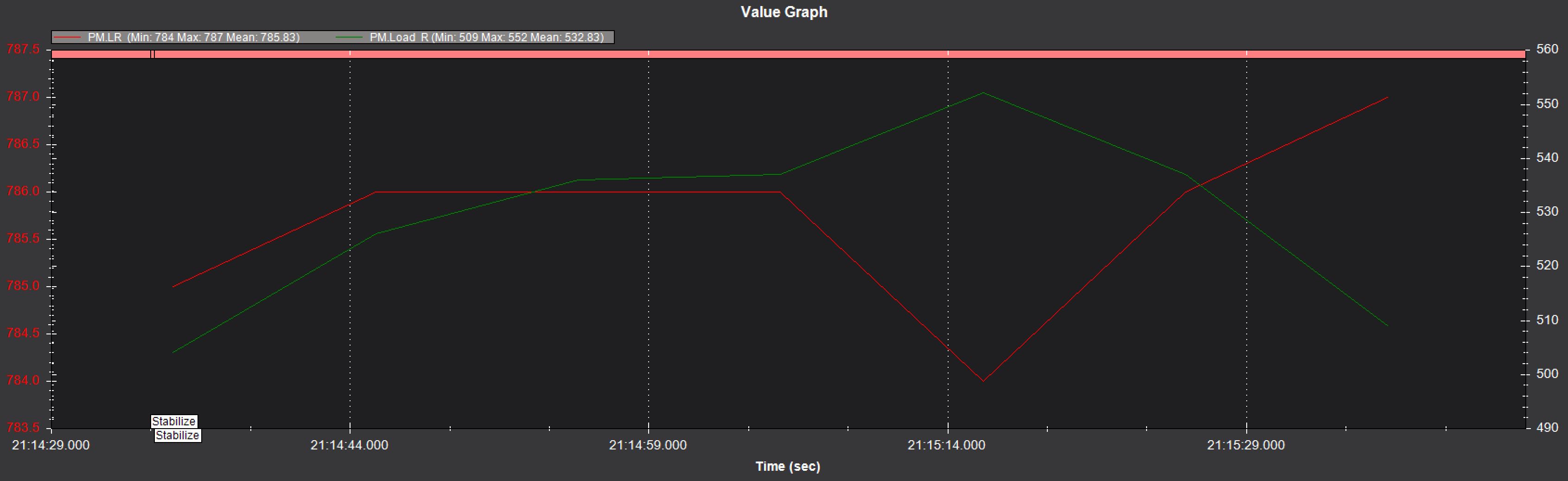

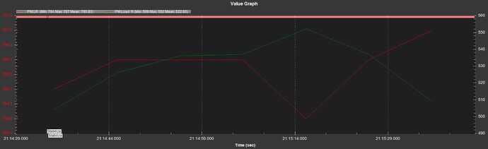

On the processor load what should a normal graph look like I guess is my question? It looks like there is less load now.

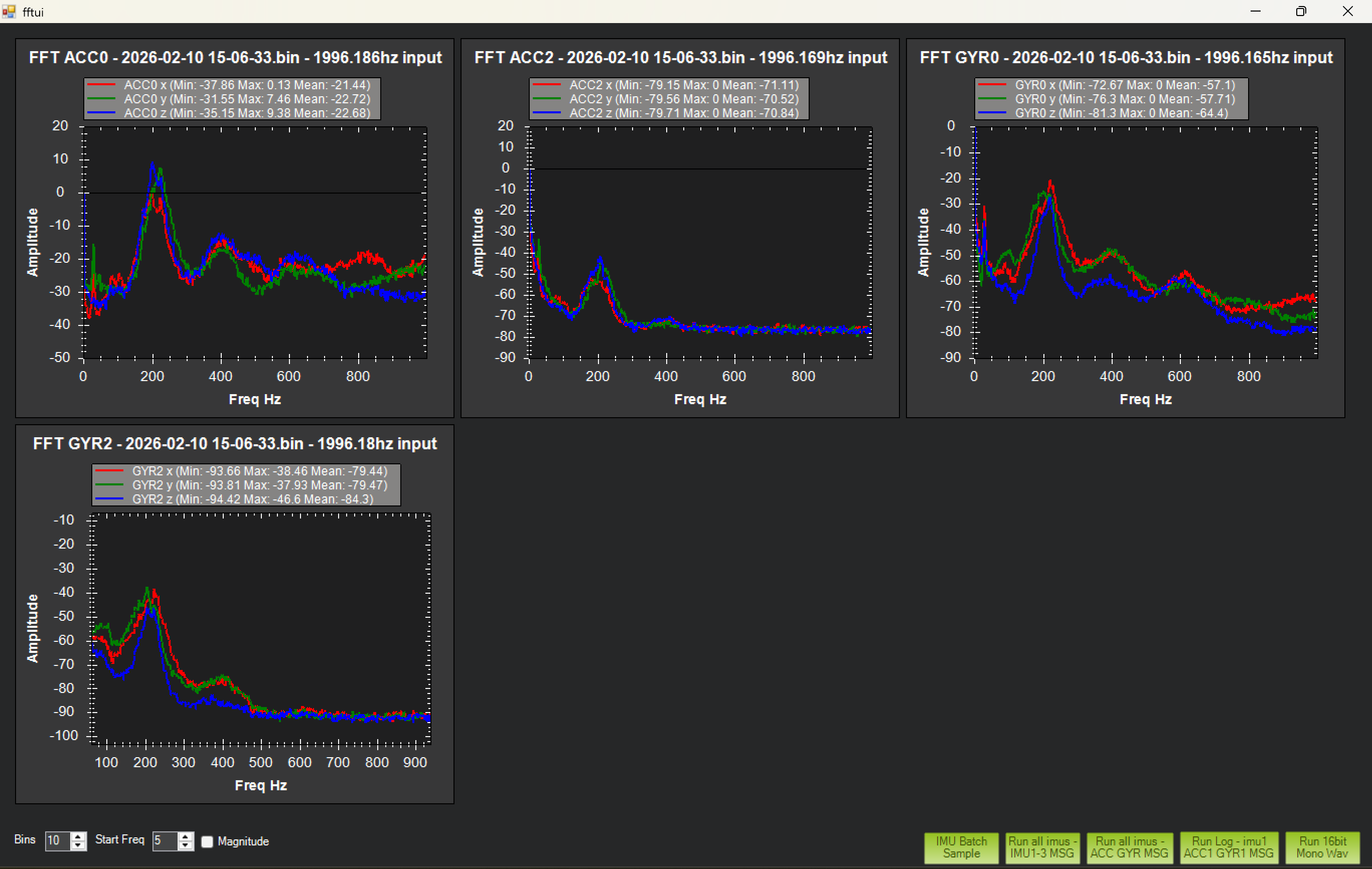

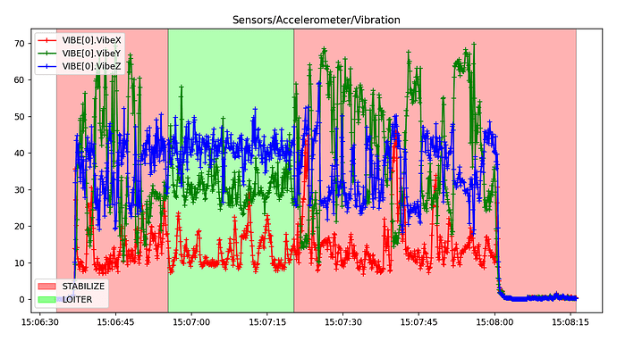

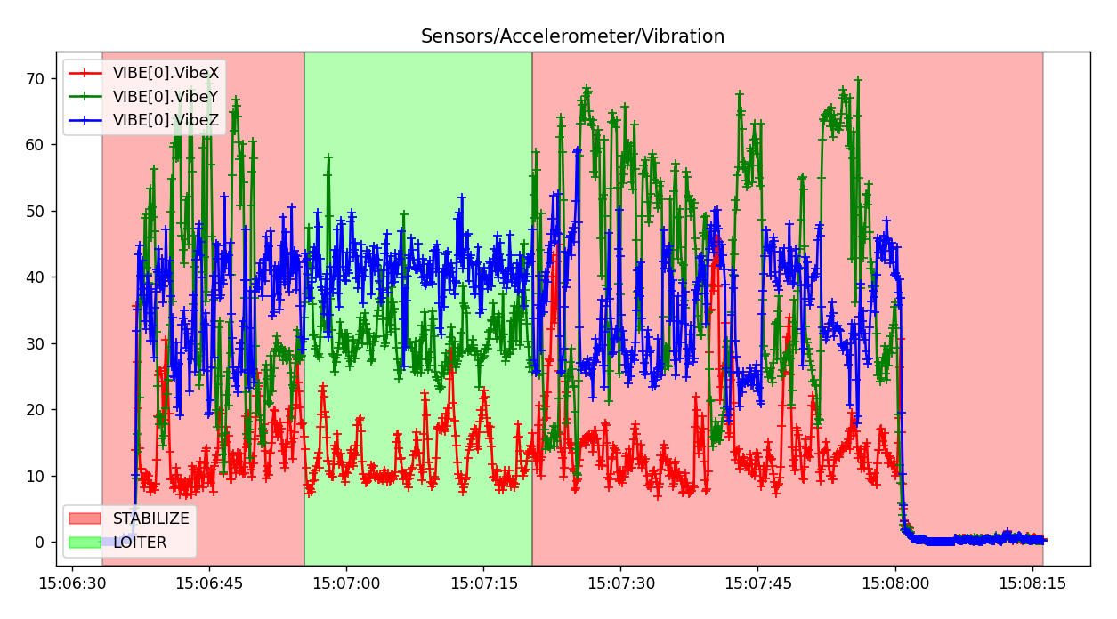

Looking at the graph I see a peak around 200hz but then I get a little lost on everything.
You need to deal with the mechanical vibrations before you go further. Something is loose or your props are bad.
You can add a filter, but that’s a band-aid on the mechanical vibrations. Consider these settings temporary until you have the mechanical issues addressed.

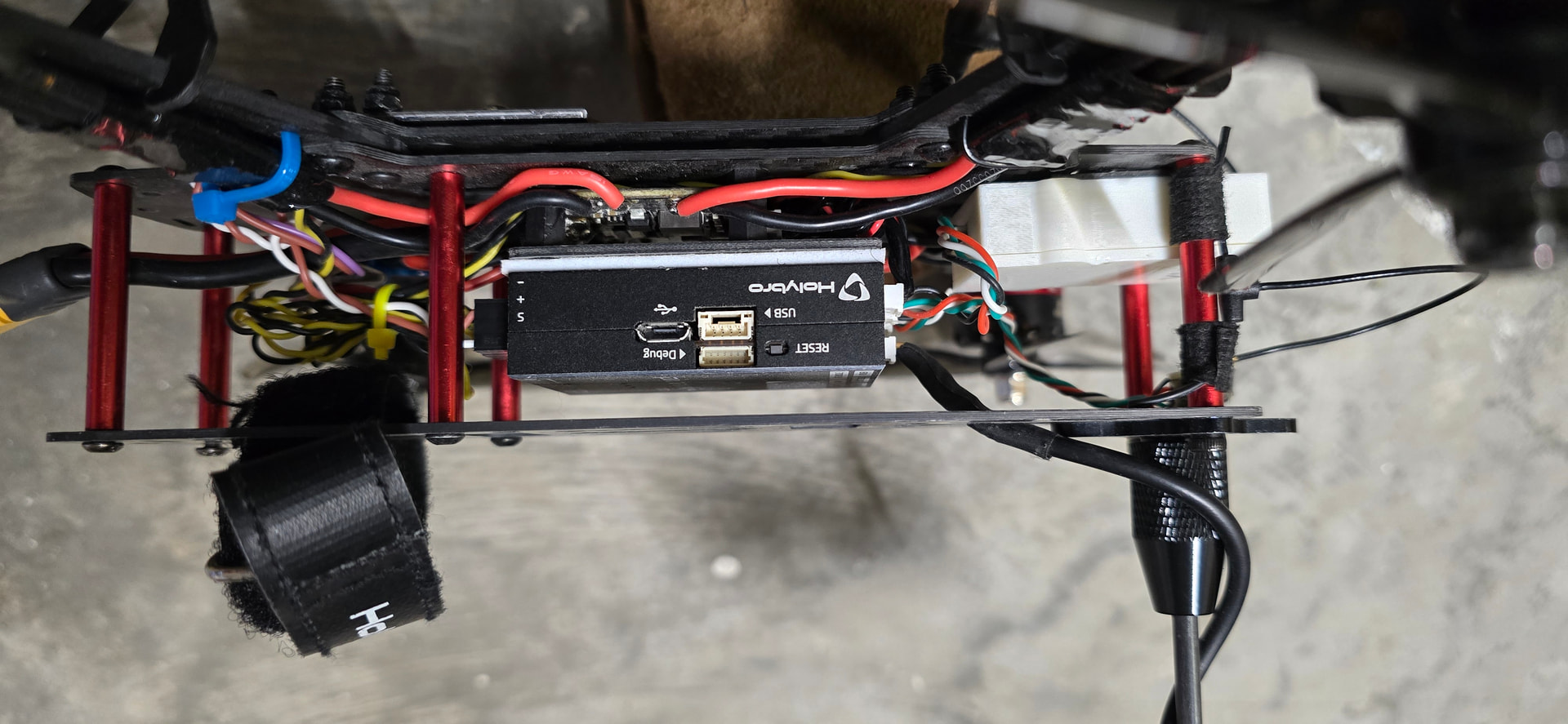

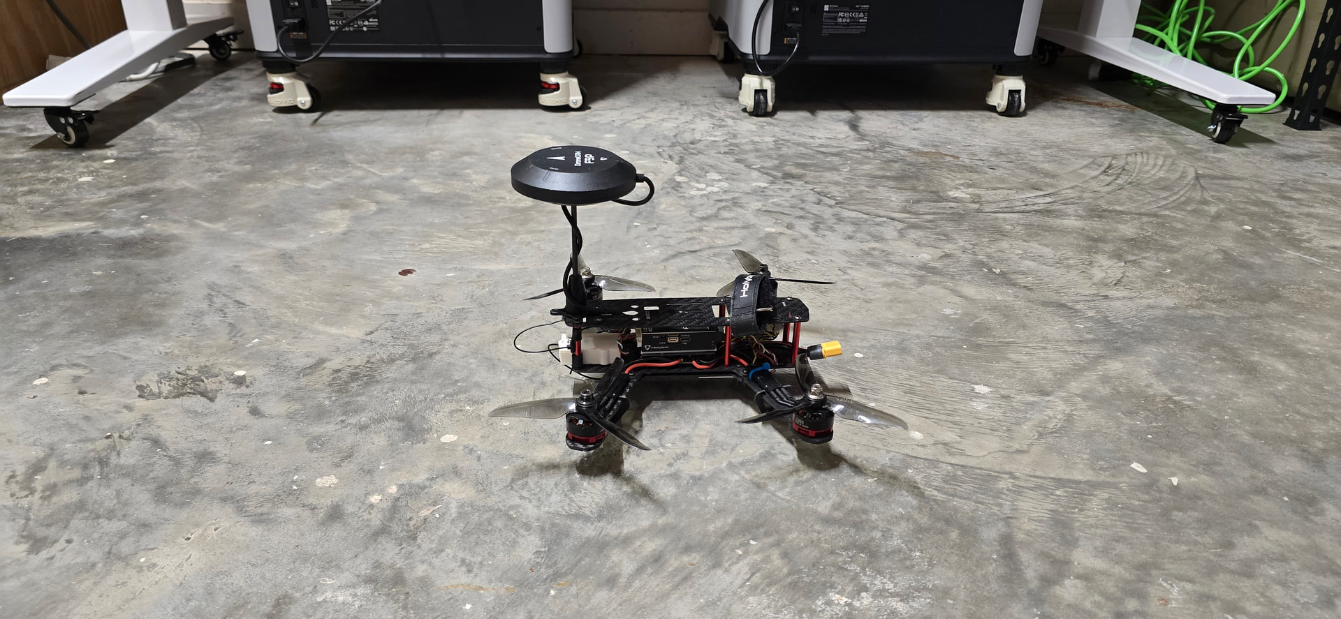

I would guess its from the massive GPS and GPS mast wiggling about. I haven’t found anything loose on it anywhere and all the wires have plenty of extra where they don’t seem to be tugging on anything. I could clean up the extra wire in the back but other than the mast I cannot find anything that would be causing vibes. I do have a smaller (also less weight) RTK GPS but I think a lot of the vibes are from this mast possibly. Will keep looking!

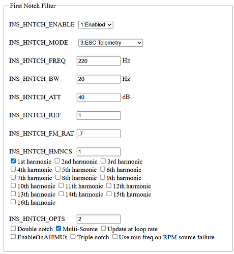

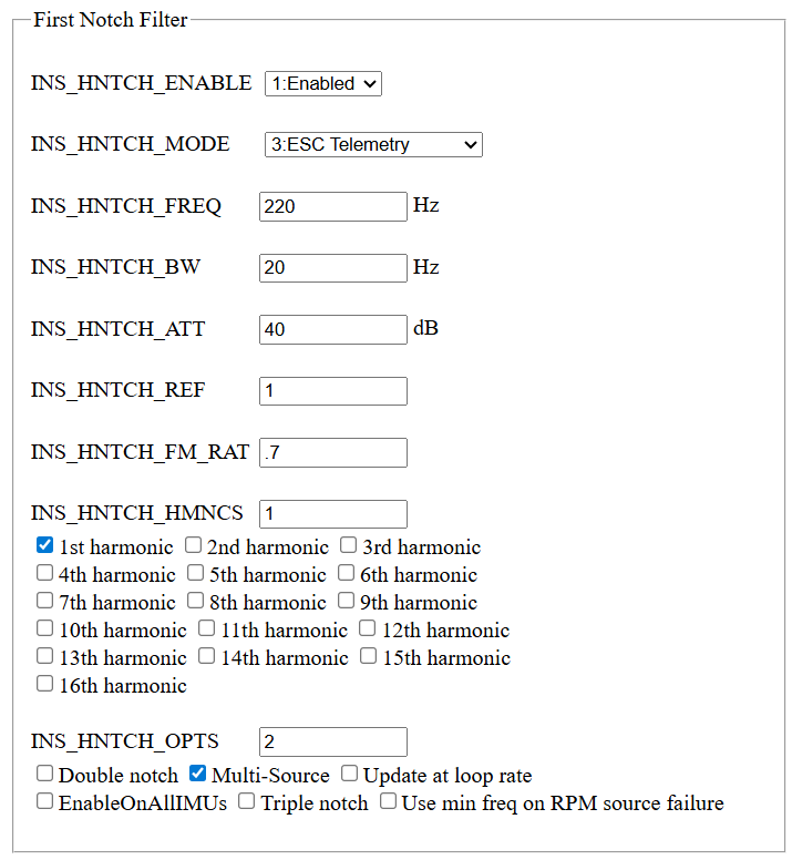

Understand those filter settings would be a band-aid but other than the 220 where did you come up with the BW and ATT numbers and you choose INS_HNTCH_OPTS 2 (multi-source) so it track each motor correct?
Yeah, that monster of a GPS receiver and the loose wire wrapped around the mast are probably a big part of the problem. Those masts are also notoriously issues. You need to find a different way to mount that GPS.
I have a GPS mast that isn’t of this folding type and a smaller F9P that is much less mass. Will throw that on and see what difference that makes.

And even with the parameter settings you have now the loop rate is unstable. Got another Flight Controller? That oldie is wheezing.
so are you telling me that even a F7 is incapable of running ardu in any capacity that allows for anything of usefulness? How can a gps (can based), crsf rc and a telemetry radio be overloading that much? what does normal look like, the scales to me are french what is a good PM NLon and PM Lr number. I just see 2 lines and a scale that makes no sense.Vibes aside would cutting a bunch of non needed stuff out in custom build be worthwhile such as all the rc protocols I won’t use airspeed sensors that would not be used on a quad copter, etc….
non-can based GPS

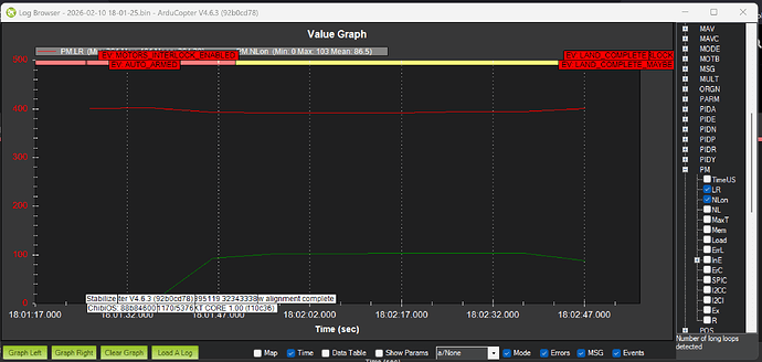

custom build with a bunch of stuff cut out thats not needed for what this quadcopter is about listed below. It looks like PM.LR (Performance Monitoring - Loop Rate) is remaining fairly consistent at 400hz ish so that shows fairly stable. PM.NLon (Performance Monitoring - Number of Long Loops) is not zero but didn’t steadily climb. Is this showing a somewhat stable loop, what is a bad number for PM.Nlon?

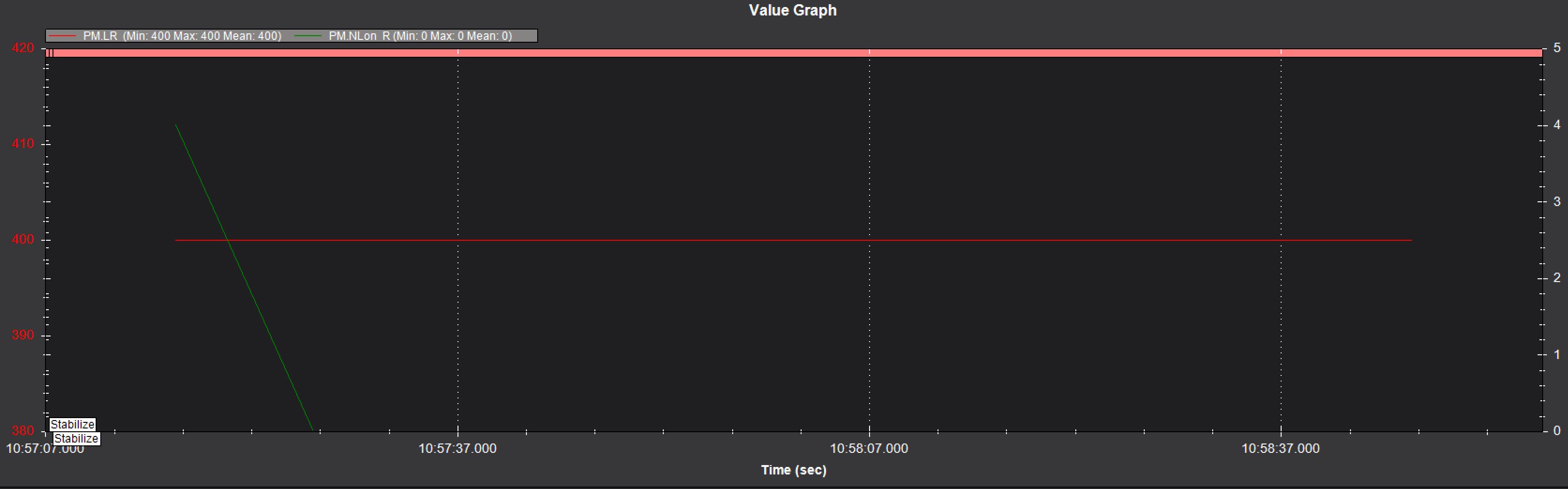

Here is a Kakute F7 Mini with the default loop rate of 400Hz. Typical configuration with ESC Telemetry notch running as multi-source. Stable Loop rate and no Long Loops to speak of.

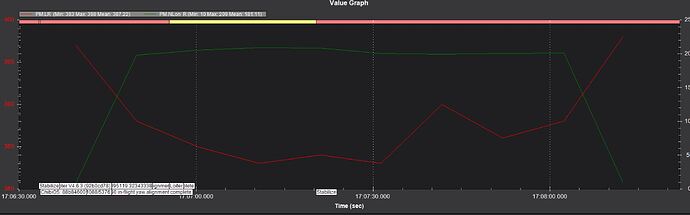

Here is an H7 with an 800Hz loop rate with a similar configuration but the Notch running on all IMU’s. Processor load shown here as ~50% It’s burdened but running fine. At 400Hz of course it would be dead stable.
