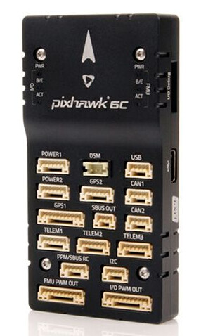

Benewake TF Series (mini-S, mini-Plus, 02-Pro, Luna) LiDARs can be connected with the IIC port of PixHawk 6C and 6X Flight from HolyBro. There are three IIC ports available on PixHawk 6C:
1. On GPS-1 > pin-4: SCL1, pin-5: SDA1;
2. On GPS-2 > pin-4: SCL2, pin-5: SDA2;
3. On I2C > pin-2: I2C2_SCL, pin-3: I2C2_SDA;

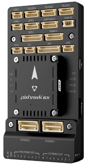

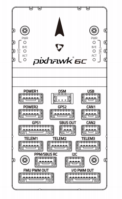

Figure-1: Pinout sequence of available ports on PixHawk 6C
Please pay attention that Pin 1 starts from the flight controllers “right side” like in the diagram shown above.
Note:

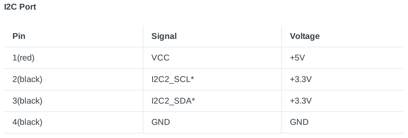

  1. Default cable sequence of LiDAR and PixHawk (6C and 6X) is different, please pay attention to the wiring sequence. LiDAR connector is 4-pin JST with 1.25mm pitch and controller needs JST GH 1.25mm 4-pin connector to interface LiDAR with I2C port. Or you can also make an intermediate cable for connecting TF series LiDAR with flight controller. Looking at the pinout of controller (6C), pin configurations are:
Figure-2: Pinout description of I2C port on PixHawk 6C

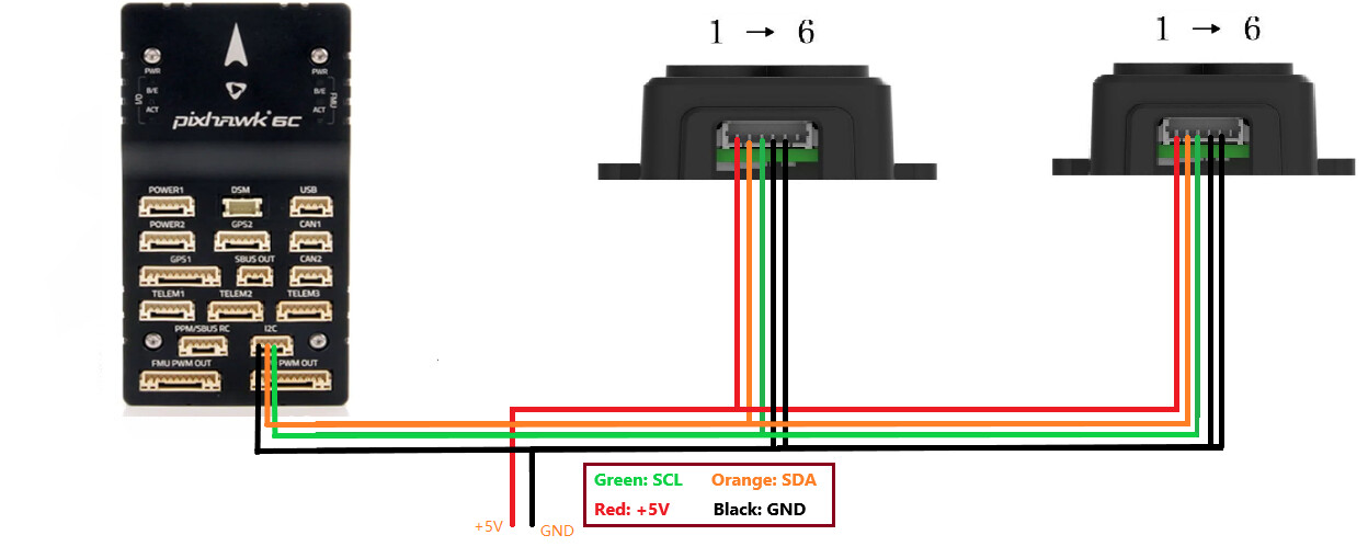

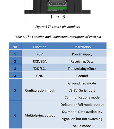

  4. The communication interface of TFmini-S, TFmini-Plus and TF02-Pro can be switched by sending commands. However, in case of TF-Luna, it can be switched by connecting its 5th pin to ground. Please see TF-Luna IIC communication pin details as below:
Figure 3: Pin sequence TF-Luna

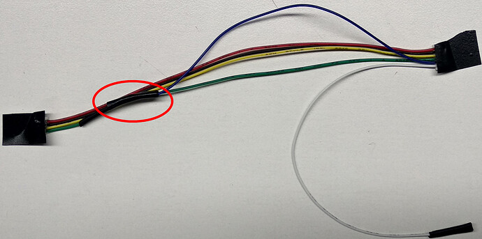

If we look at the pin configuration of TF-Luna, IIC can be set by grounding pin-5 in addition to the other four pins. For this purpose, a customized cable is needed because in IIC mode we need to connect both pin-4 and pin-5 to the ground.
The modified cable is shown below. I have connected green wire (pin-4) and blue wire (pin-5) to single pin which will go to the GND pin of the source. Leave pin-6 connected. Please ignore the color standard in this case as black wire represents SDA while yellow wires represent SCL, just follow the pin numbering according to the product-manual.
So, based on the above discussion, you will need to add an extra wire (for TF-Luna) in the diagram (Figure 3) in order to use TF-Luna in IIC mode. For more understanding, I have added a separate connection diagram for connecting multiple TF-Luna using IIC interface.
Figure 4: Schematic Diagram of Connecting TF-Luna to I2C Interface

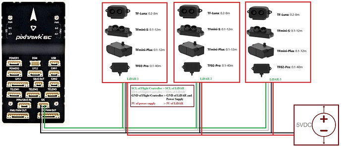

2. PixHawk 6C (from HolyBro) Connection:
Please refer to the product manual for wiring sequence of LiDAR:
Figure 5: Schematic Diagram of Connecting three TF-LiDARs to I2C Interface of Flight Controller

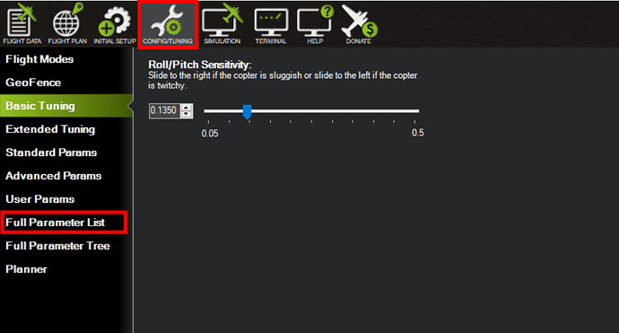

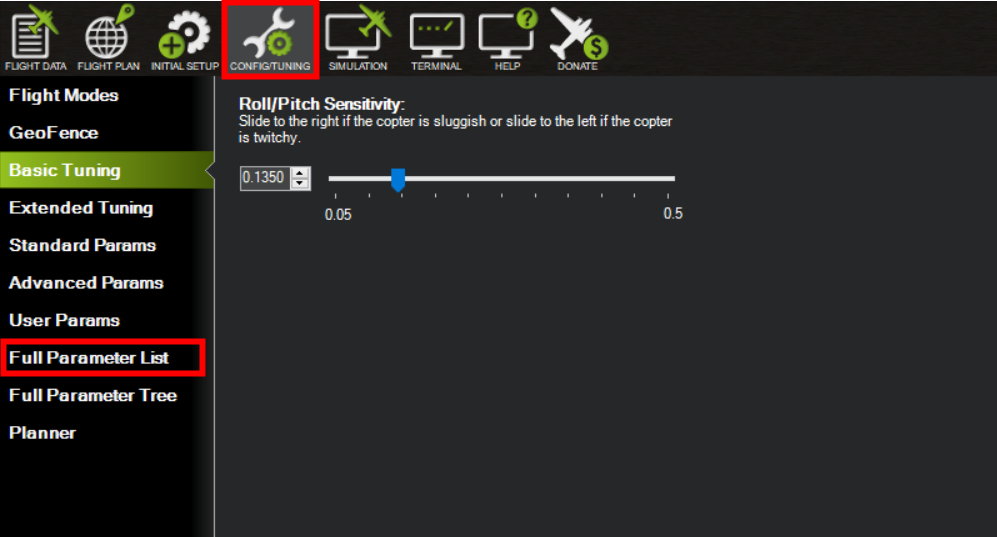

3. Parameters settings (Obstacle Avoidance and Altitude Hold):
Connect the flight control board to Mission Planar. Select [CONFIG/TUNING] and then click on [Full Parameter List] in the left from the below bar. Find and modify the following parameters:

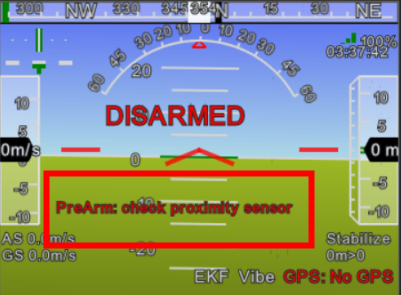

If the error message “Bad LiDAR Health” or “PreArm: check the proximity sensor” appears, please check if the connection is correct, the power supply is normal and you have restarted the controller. Also, check it whether you have changed the mode from Standard mode to Pix mode. If yes, then the same error will encounter.

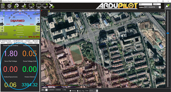

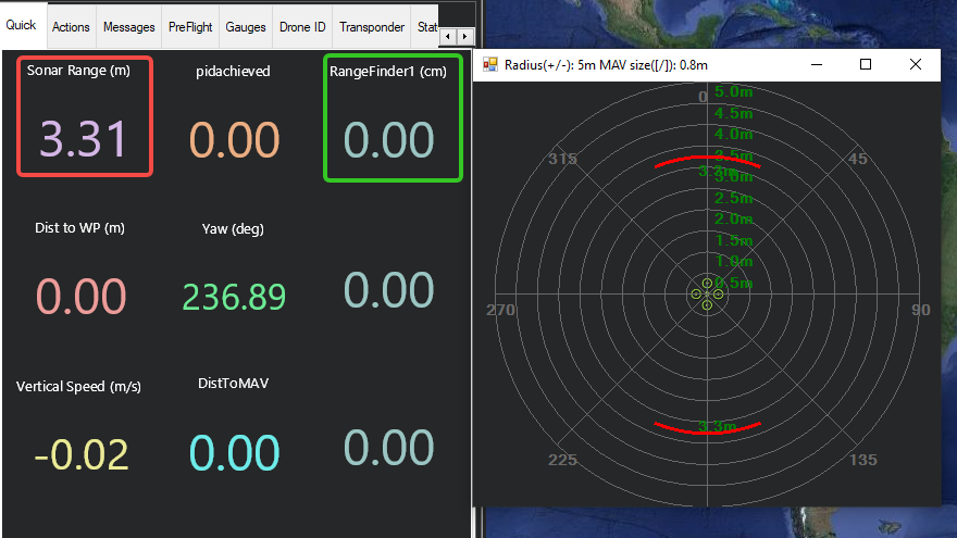

To see the target distance from the LiDAR, press Ctrl+F button in keyboard, the following window will pop out:
Click button Proximity, the following window will appear:
The number in green color means the distance from LiDAR in obstacle avoidance mode(it doesn’t mean the real time distance from LiDAR and will not be influenced in Mission Planner. The mission planner version at the time of writing this tutorial was v1.3.79.

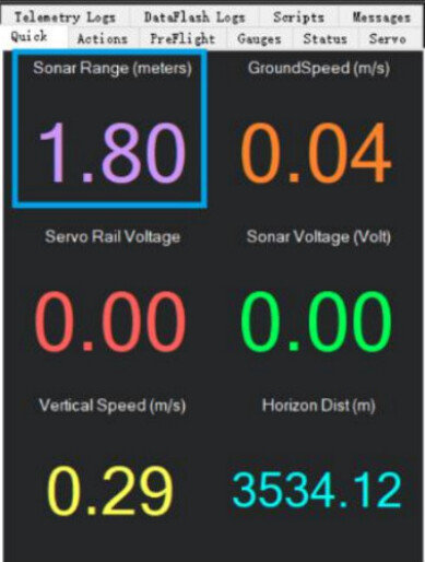

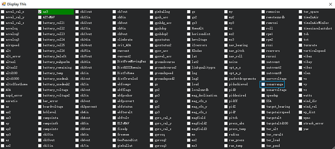

To see the altitude value from LiDAR sensor, double click the area of the Mission Planner, look at the following picture:
Select option sonarrange, see following picture:
The altitude distance from the LiDAR will be displayed in Sonar Range (meters), see the following picture:
Data from Three LiDAR sensors:
You can see in the following image that RangeFinder1 (cm) does not display any data. The reason is, this LiDAR is used as Altitude Hold sensor, so its data is shown in Sonar Range (m). While the data of other two sensors is shown in Proximity window (right hand side).
