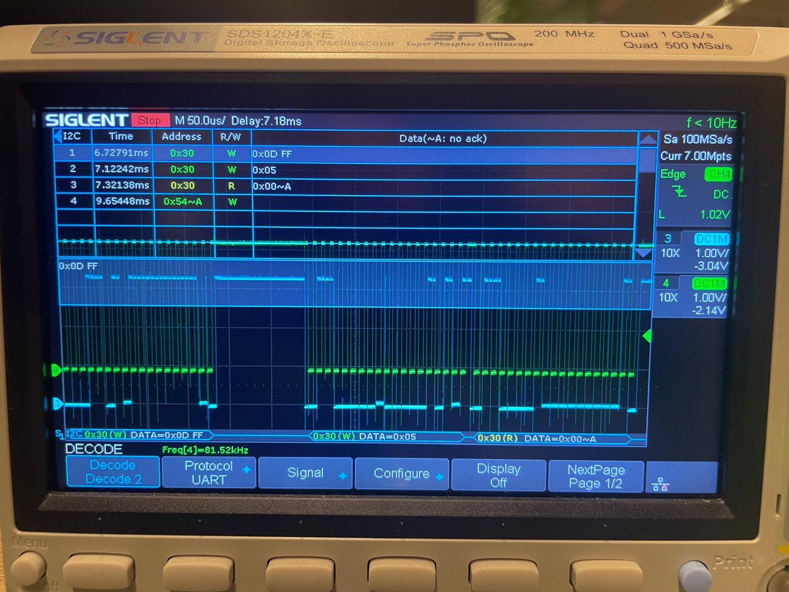

I am running into the same problem with a Mateksys H743 mini v3 board to which I connected the MMC5983. I specifically selected this device as it appears to be supported by the firmware, however, it appears to be completely ignoring the device.
I have been able to validate with an oscilloscope with decode mode that the FC is going over a large number of I2C addresses after boot in order to find devices. It does cover address 0x30 as well, which is the only one that is responding with an ACK.
However, subsequently the FC appears to be sending 0x0D and 0xFF. Which is strange as the datasheet of the MMC5983 does not specify the existence of a register address at 0x0D.
It finally does a write action and it writes 0x05.
Finally it reads a single byte (0x00) from the device. After that it never appears to attempt any further communication.
If anybody has more information this would be greatly appreciated!
I think these issues are likely related to this open PR:
https://github.com/ArduPilot/ardupilot/pull/29722
I’ll see what I can do to get it a little more attention.

I would also like to let you know that I took the changes from the commit and added them into my local 4.6.2 version with some minor alterations, built it and flashed into my FC and can report that the sensor is now recognized! It shows however as a MMC5883 in Missionplanner instead of the MMC5983, but I don’t think that will pose any serious issues.
