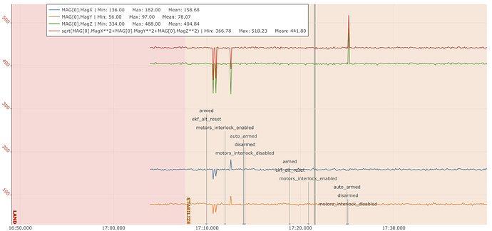

I noticed when I arm my copter, the compass heading is changing by 30-40 degrees.
Note : The copter is already calibrated.
I only have FC connected to usb-charger (supply) and RC receiver. i.e I don’t have propellers or battery connected ( no moving motors )
I attached my captured logs. I only arm and dis-arm nothing more.
log_0_UnknownDate.bin (532.8 KB)

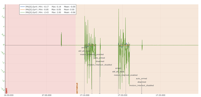

I checked the logs I see minor changes in Acc. The Gyro and compass has weird spikes.
any explanation for that ?
is it bad IMU sensor or bad calibration. ?

I found the issue:
I noticed when the buzzer is making sound/tone during arming and dis-arming, the INS reading is going crazy.
I desolder the buzzer and seems everything is fine now !. The active buzzer seems to generate noise in the circuit which affect all components.
