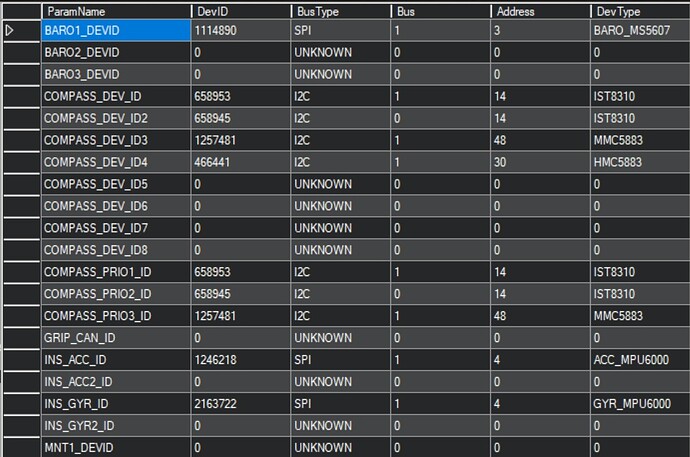

I have 4 compass (for no reason). I was unable to write the 4th compass to external. Unable to click the button.
here is the configuration
1: External ist8310 bus 1
2: Internal ist8310 bus 0
3: External mmc5983ma bus 1
4: External hmc5883 bus 1
The first 3 compass can be configured normally.
Is there some parameter to write it external? Or I can leave the external compass as internal

Can you show a screenshot of mission planner showing all your 4 compasses are correctly detetecd by Tab SETUP>>Mandantory Hardware/HW ID.
Also answer which FC you are using and exactly which Firmware you are installed based on which board HWDEF. Than I can give you one of two possible answers to your problem.

Ok, sorry for the delay. Just saw that you edited your posting with the screen shot.
So the reason why you only can use 3 compasses is the unset limit in Hwdef file used by your Firmware. The Firmware PixHawk1 is just a extension to the Firmware FMU3 both Hwdef dont have defined “HAL_COMPASS_MAX_SENSORS” and if this is not defined the AP_COMPASS library takes the default of max 3 compasses.
This mean with other words ardupilot firmware is able to use more compasses but in most cases of the firmware only the default 3 compasses are used.
The other possibility I had in mind was a mismtch of I2C adresses as the cheap modules don’t have the possibility to change the adress. But your screenshot shows that the differerent chips using different adresses. So from that side all is ok.
