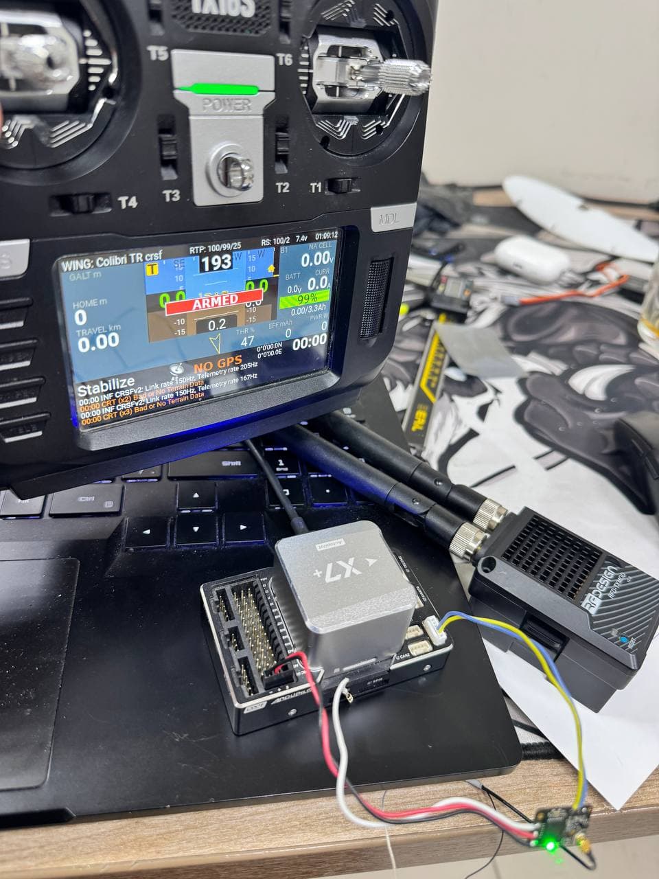

My experience has more closely reflected xfacta’s than atex’s. Mission Planner connects via UDP or TCP, loading parameters is slow but not too bad. With my current settings the number of false Yaapu audible alerts (flight mode changes and arm/disarm status) is now only once every 5-10min or so, but about 5% of the text messages are still mixed up.
One difference in my settings to ATex’s is that I have RTS/CTS enabled on both ends (which on the FC end requires the extra cables to be connected and BRD_SER1_RTSCTS set to 1, RFDesign states that auto is unreliable). RFDesign said this will “help with both the system being overwhelmed with data on start up and any potentially corrupted packet issues, as UART buffer overflow is a factor in both of those problems”.
Reducing message rates (in Mission Planner config) to 1Hz reduces the Yaapu errors. This still results in a lot of un-necessary information being sent, so some further fine tuning beyond what is easily done through the GUI might resolve the issue. I found reducing the baud rate to 57600 also helped (I guess this forces the FC to reduce the amount of data it’s sending which seems to address shortcomings in the TX Mod). This is also why I think that Yaapu has more errors when Mission Planner first starts or if you refresh the parameters, it causes the FC to send more data which the Tx Mod can’t handle. Maybe a further reduction in baud rate might fix it… I’ll test that soon.
I’ve stuck with EdgeTX firmware 2.8.0. With the current version of the firmware it does work again, but I get a much higher Yaapu error rate and Yaapu sometimes crashes when it tries to convert erroneous non-numeric data to a number. It’s interesting that recent firmware is working for xfacta.
I will be doing some range testing in the next few days. I’m legally restricted to VLOS, so nothing impressive like ATex’s missions, but I do want it ultra reliable in a 500m range. ATex – what antennas were you using?
One further observation is that for me I haven’t noticed different outcomes if I start the receiver or FC first.

xfacta ive gone blank on the port 23 ? I connect wifi from Tx mod to laptop, no password required, port 23 sounds familiar but is that a generic thing in Tx settings or is it in MP. Then i connect to mp via udp, i dont remember if i get an option for port 23 or not? Btw i will go back through your guide and try again. Note: my version atm is 2.8.4, i will also try 57600
I am not home atm so will be back at it in a month. Thanks Quadzilla and Klaash that info is useful and validates
Range wise I am happy at this stage - AC has 2 x right angle small 900 aerials (located under Vtail) Tx has done well with 2 x standard longer tx 900s and similar range tested with 1 x standard longer 900 tx aerial plus 1 x white 500mm omni fiberglass aerial from rfdesign website. I think i can improve range by testing with better locations and type of aerials on ac. Fyi i have not proven the white omni to be affective as yet. more to be done. Thanks again
Port 23 is specified in the MissionPlanner connect disalog, along with the TCP IP address of the TX-MOD
