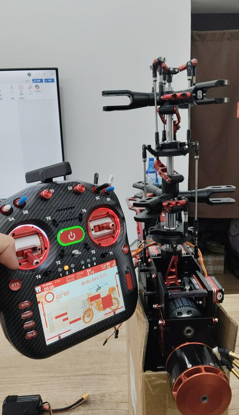

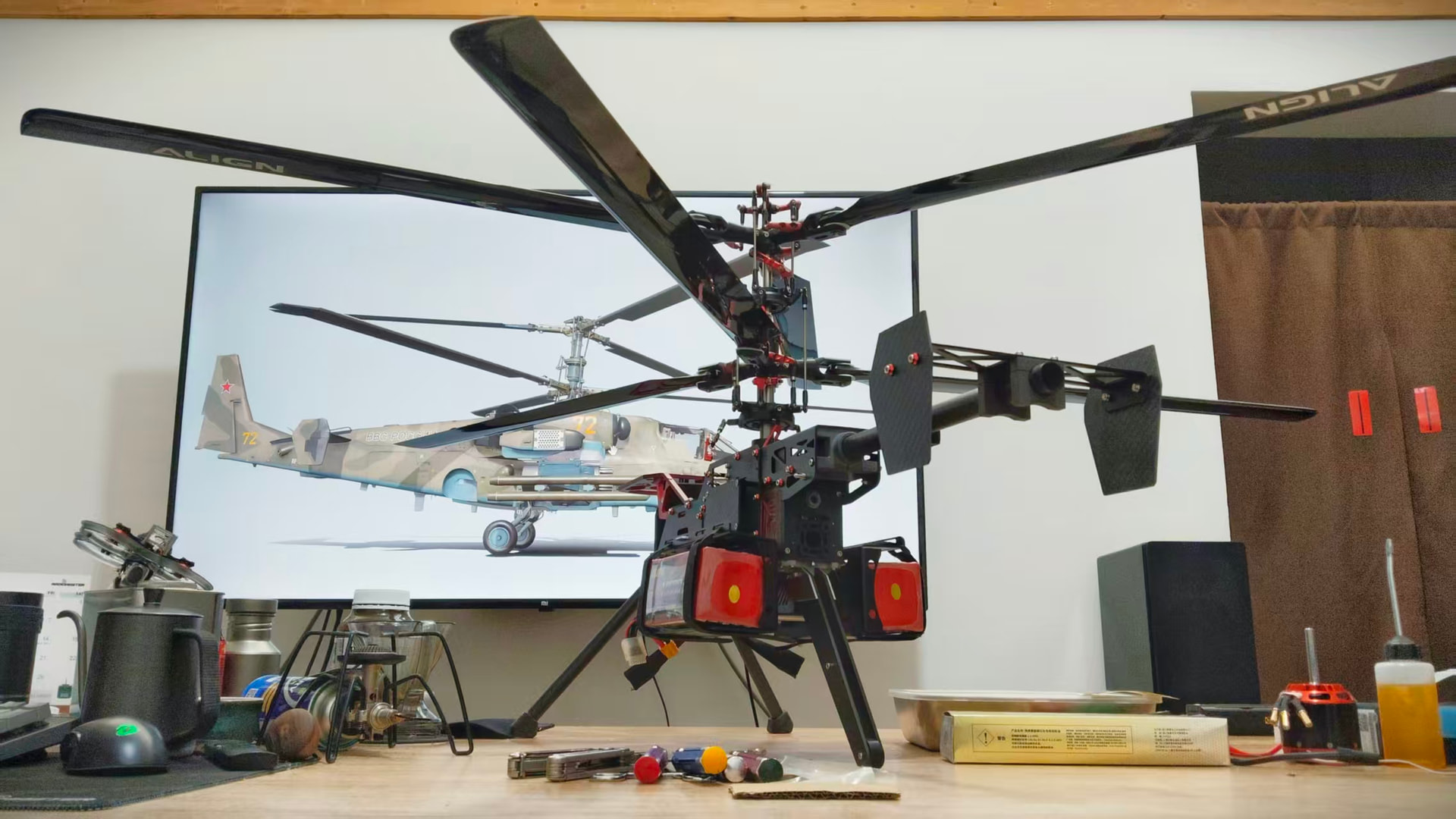

Coaxial twin-rotor mechanical semi-differential helicopter with 5 servo motors
@rmackay9
I have a coaxial twin-rotor helicopter using five servos. Three servos control the cyclic pitch and collective pitch of the swashplate, and two servos control the yaw control via a semi-differential mechanical mechanism. I checked the Copter wiki, and the Heli firmware’s design for coaxial twin-rotor helicopters uses six servos, with three controlling the upper and lower rotors respectively. This doesn’t match the structure of my helicopter. I need to implement this in the firmware using CUAV’s flight control system. For the servos that synchronously drive the yaw control servos, I need to ensure that the yaw control servos are synchronized with the collective pitch, but not involved in the cyclic pitch movement. Is this functionality supported in the firmware?

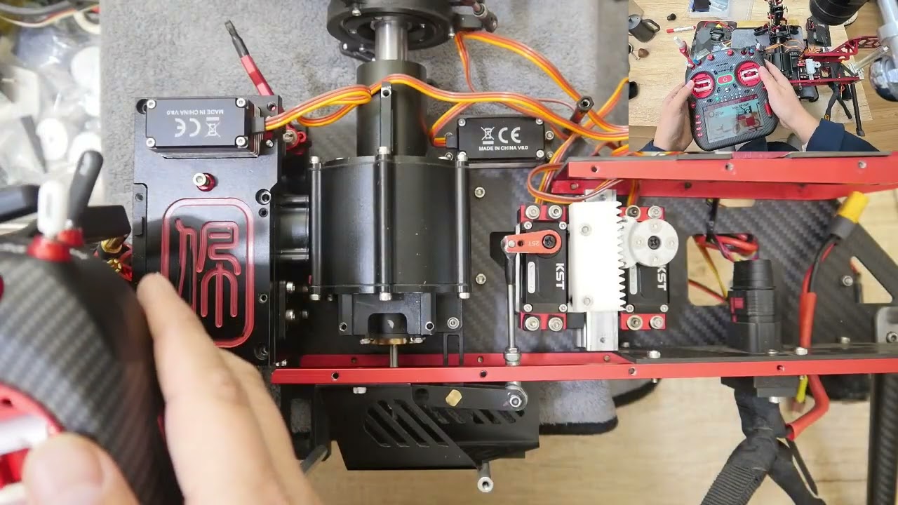

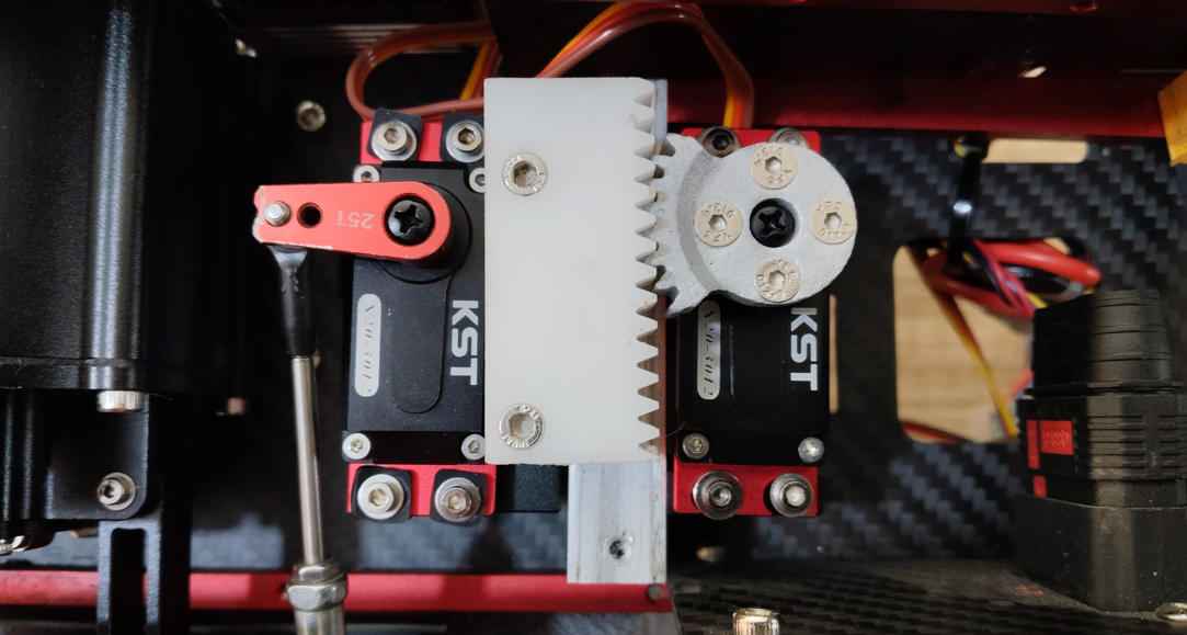

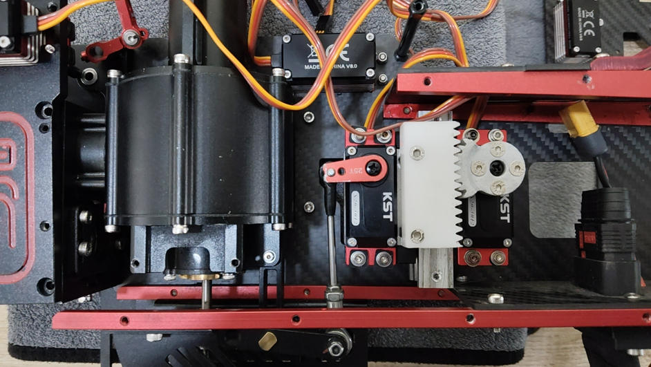

The servo with the prototype half-tooth disk is installed on the output shaft of the servo on the right side of the figure below. It needs to be able to move up and down synchronously with the collective pitch control. To keep the yaw control of the yaw servo can move synchronously with the collective pitch, it needs to be able to synchronize with the collective pitch control signal, but not mix with the signal of the periodic pitch change (the control signals of servos 1, 2 and 3 are not applicable).

My current request is that I’m using the right-side servo (servo 5) to drive a white rack via a cylindrical gear, which in turn drives the entire left-side servo (servo 4, i.e., the yaw servo) to make linear displacements on a track. I need the yaw servo to move in sync with servos 1, 2, and 3 during collective pitch control. This ensures that when the collective pitch changes, servo 4 (the yaw servo) moves synchronously with the collective pitch change, preventing differential movement between the upper and lower rotors when yaw is not activated. Therefore, I need the flight controller to output a separate servo control signal, containing only collective pitch control signals, without including pitch and roll movements from the CCPM (Combined Control Processing) system. However, in current conventional helicopter firmware, any control channel for servos 1, 2, and 3 integrates CCPM control, including both collective pitch control and cyclic pitch control. The signals from any of these three servos contain cyclic pitch signals.
Compared to traditional FBL systems, the default channel ch6 is the PIT control channel, which is a dedicated collective pitch control channel. However, I couldn’t find any servo control settings for this function in the ArduPilot firmware and wiki.
Therefore, my request is to add a servo control channel that only includes collective pitch control and does not include periodic pitch control.

@zhangsir This seems like a very unique coaxial design. Is this common for a ganged swashplate design to have a 5th servo? Currently, ardupilot does not support this type of arrangement for a coaxial helicopter.
I’m sure you could design your own motor library to be added to the dual heli frame type. Let me know how you would like to proceed.
