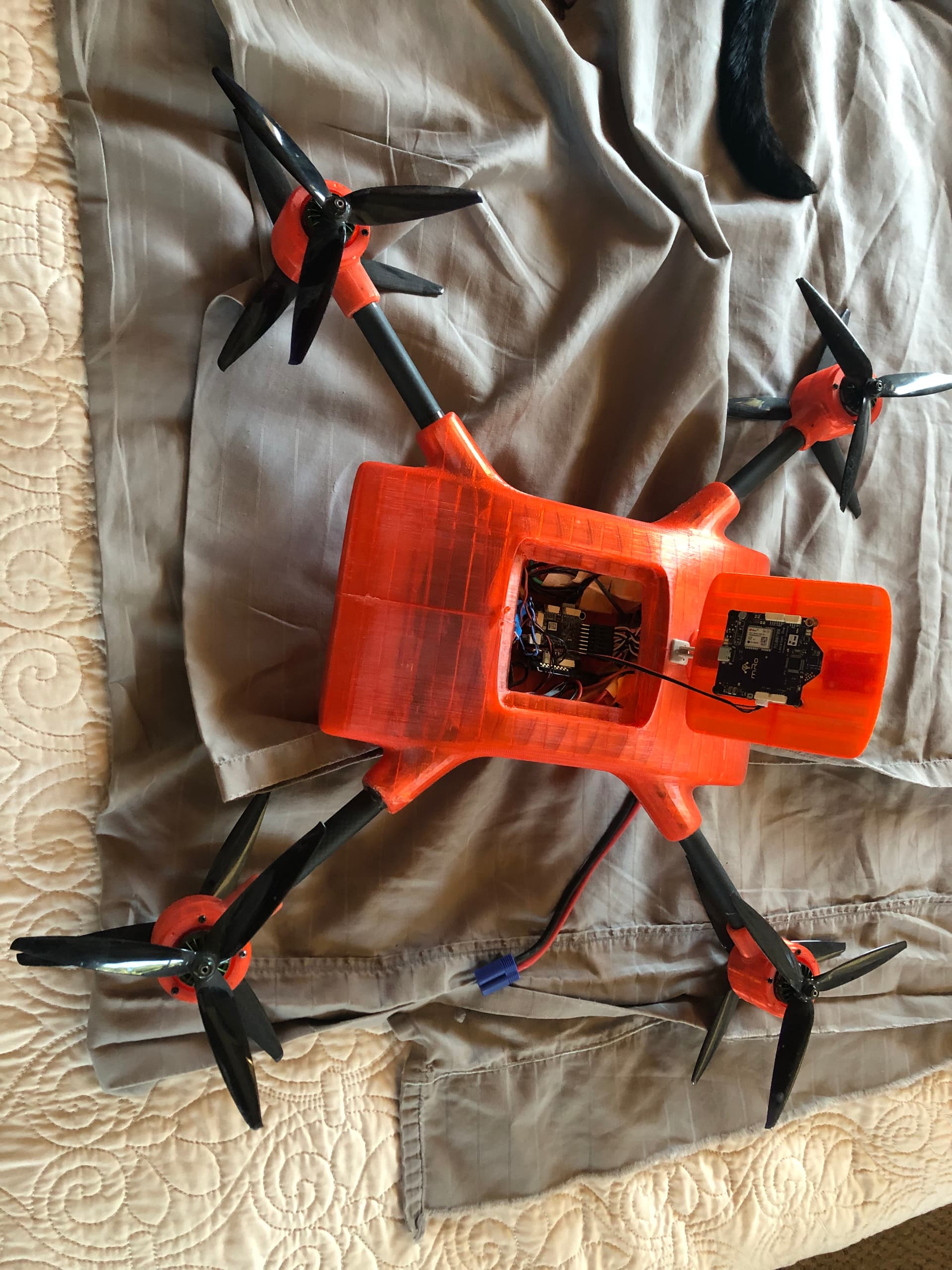

I have been working with members of the ArduPilot dev team (especially @Leonardthall and @Paul_Riseborough ) to test an alternative motor layout and mixer for X8 co-axial multicopters that avoids the patent. The above video shows an X8 multicopter flying with this new layout.

As mentioned above, you may experience a frame resonance which can be quite severe. On the first test flight of the vehicle in the video the copter flipped over within 1.5s of takeoff due to a resonance, although the simple home made design does make it particularly prone to these types of resonances. The issue was fixed by setting up a fixed notch filter at the resonance frequency of 32Hz, like this:

With that addition the copter flies just as well (and with the same tune) with co-rotating as contra-rotating. On some vehicles a re-tune will be needed, especially if you have a tune with less margin.

I like to try one but do i use one of my x8 frames?

Hi Tridge,
Sorry my question is can I use a used x8 frame I made and update it ?
yes, just follow the instructions above and it will work
