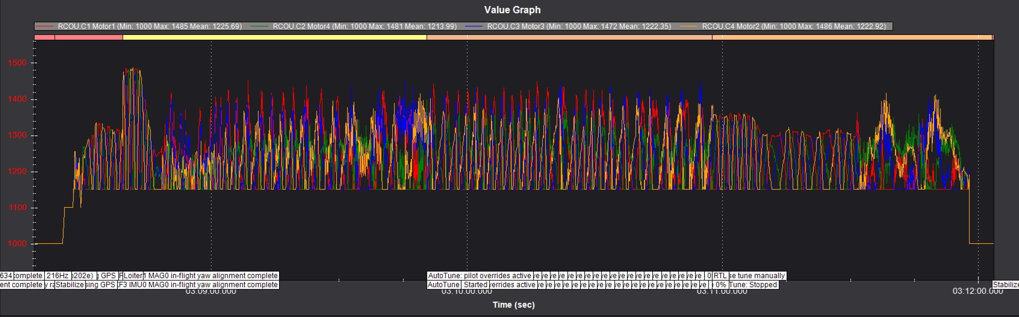

Typical with default parameters. Massive output oscillation. Claude didn’t tell you that? Didn’t think so. Not even the Initial Tuning Parameters set. This craft was not ready to leave the ground.
@OmkarSarkar204 one more example of a bad configuration
