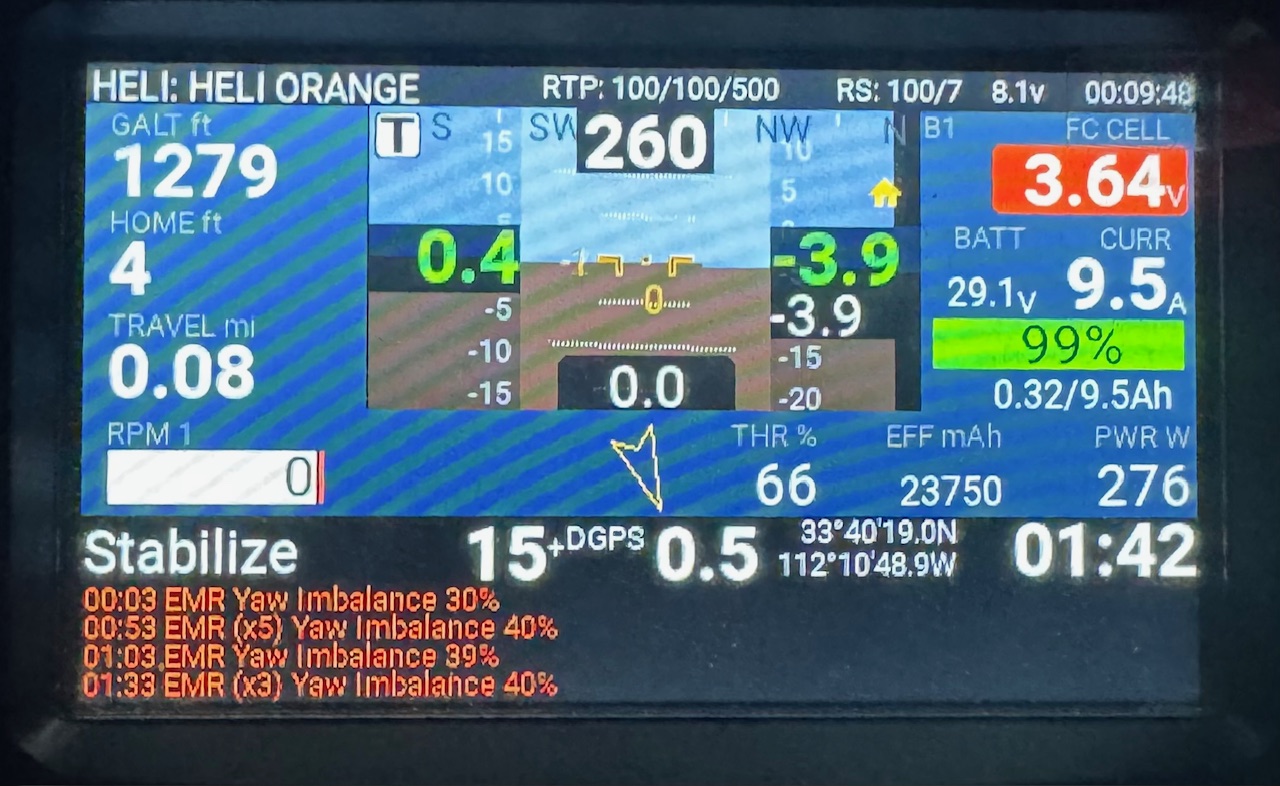

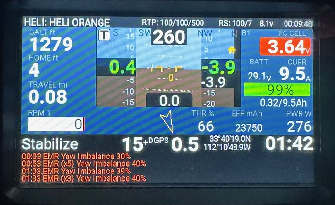

other problem; if you look into the pic of the telemetry, the battery cell voltage was reading 3.64 during the flight but the batteries are new HRB 9500mah 120c @ 1.1 Ris Ohm each cell.
the battery cell on ground after the flight is 3.92V each cell ! I have 8s total at 9500mah.
so why there is big voltage drop during the flight?
and why the MAH shwoing 23750?
to mush issues!
